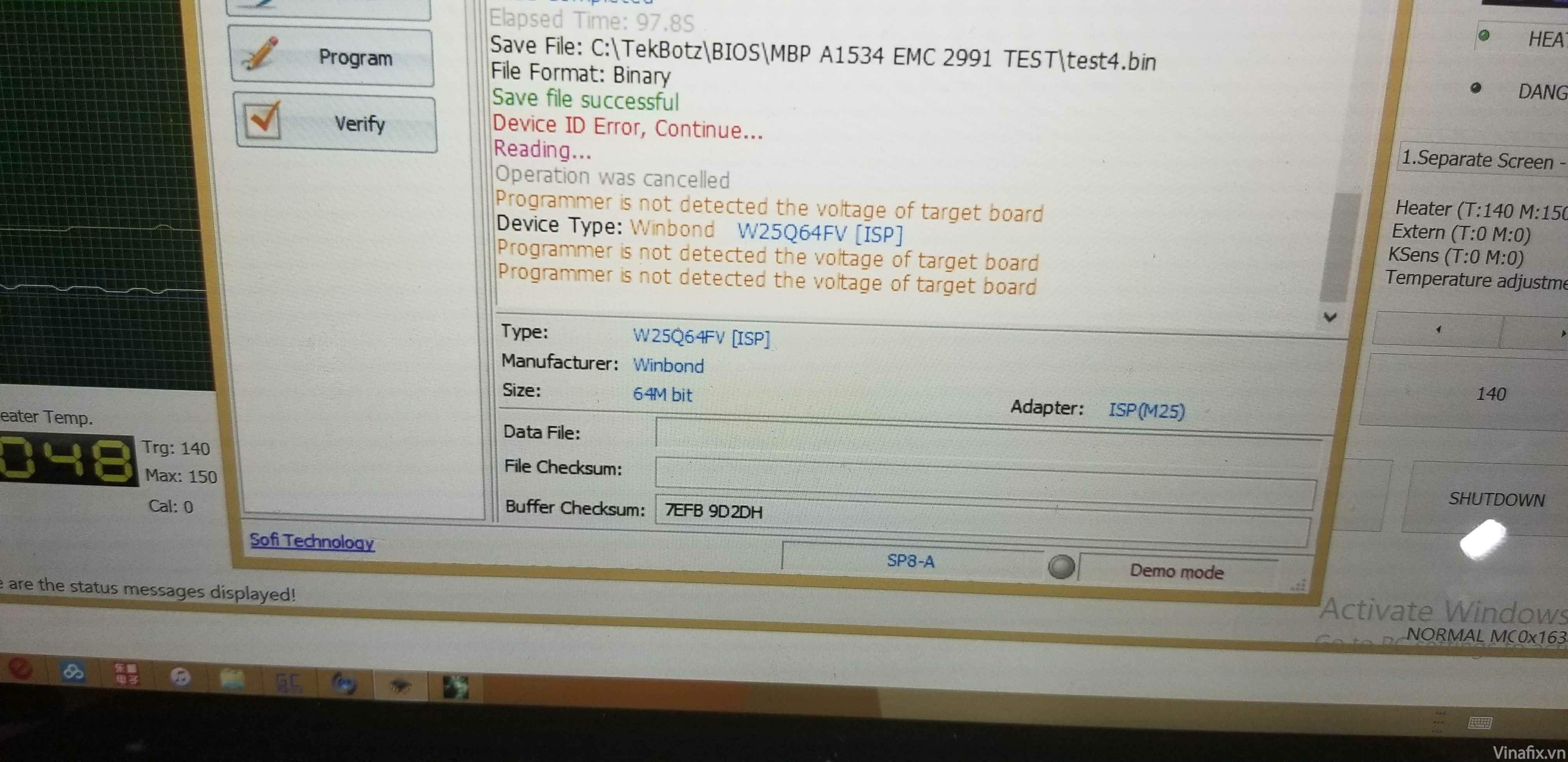

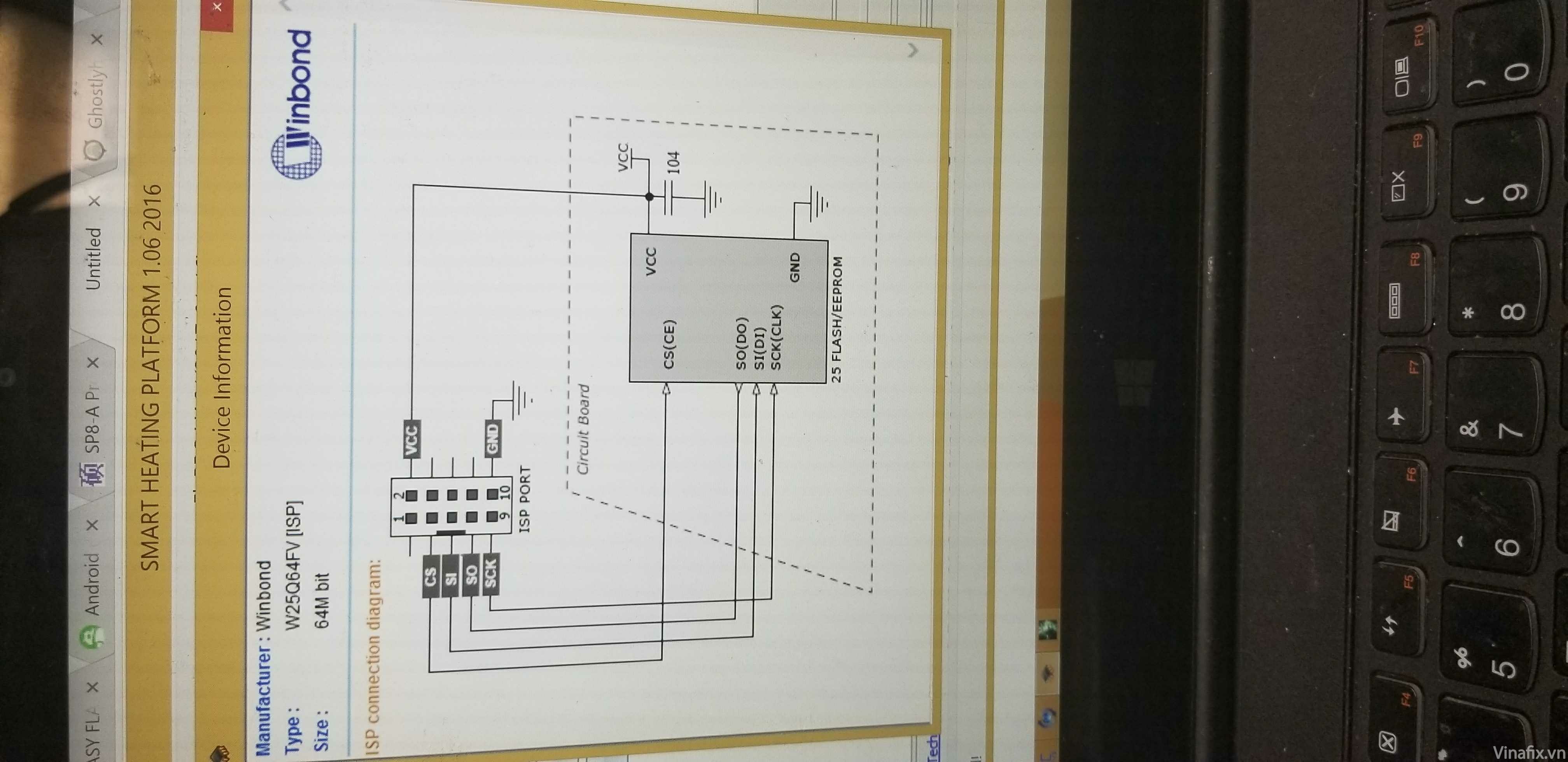

Actually I was doing this all wrong, inside Flypro there is pinout, so I matched that with pin out of chipmunk but now I'm getting "programmer not detected the voltage of target board" error? Any ideas, I've attached pics of what I'm following, any help would be greatly appreciated.

Sofi-sp8 and chipmunk easy flash...i had the red and orange wire crossed and that's why I was getting "programmer not detecting voltage" error in flypro...but now I am getting wrong chip ID error....i have chosen W25Q64FV ISP for chip but still says wrong Chip ID

use the cabel and bord like this photo and you get no error and use a reader white lower speed that must do the job

anybody have luck with BPv4 and this board? i still cannot detect chip ANY help would be greatly appreciated, I can successfully desolder and program this chip using SOFI but thats a huge pain.
thanks
Figured something hope it helps with someone, 820-00244-A comes with either MX25L6435E or W25Q64FV, sooo the W25Q64FV is very easy to read/erase/write but the MX25L6435E is very difficult and so i notice all those that have trouble is because they device have MX25L6435E and all that say easy because they devicce have W25Q64FV...also both chips are soldered to the board differently, see pics.
