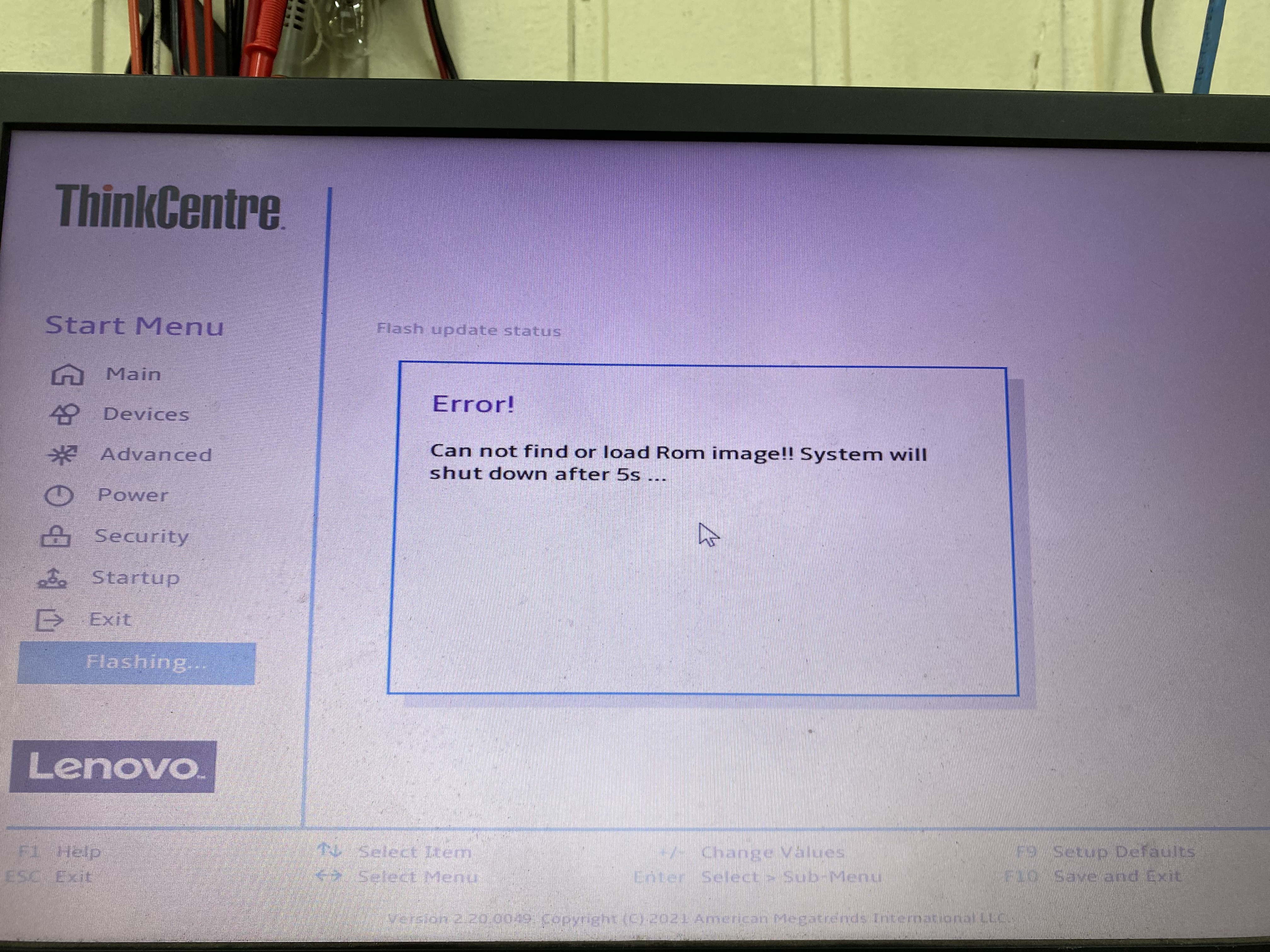

PC this use OS amazon.Gringotts2 ???
i dont know, i buy this pc like damage, no power at all
- i test with another cpu,
- other power adapter
- tested with no cpu ( should light a red light 0, but nothing ) dead. i have 3.3v 5v 1v and others
write at 78% this bios give me error, but if i write with original bios , work 100%
i put another bios ic, but still no power
