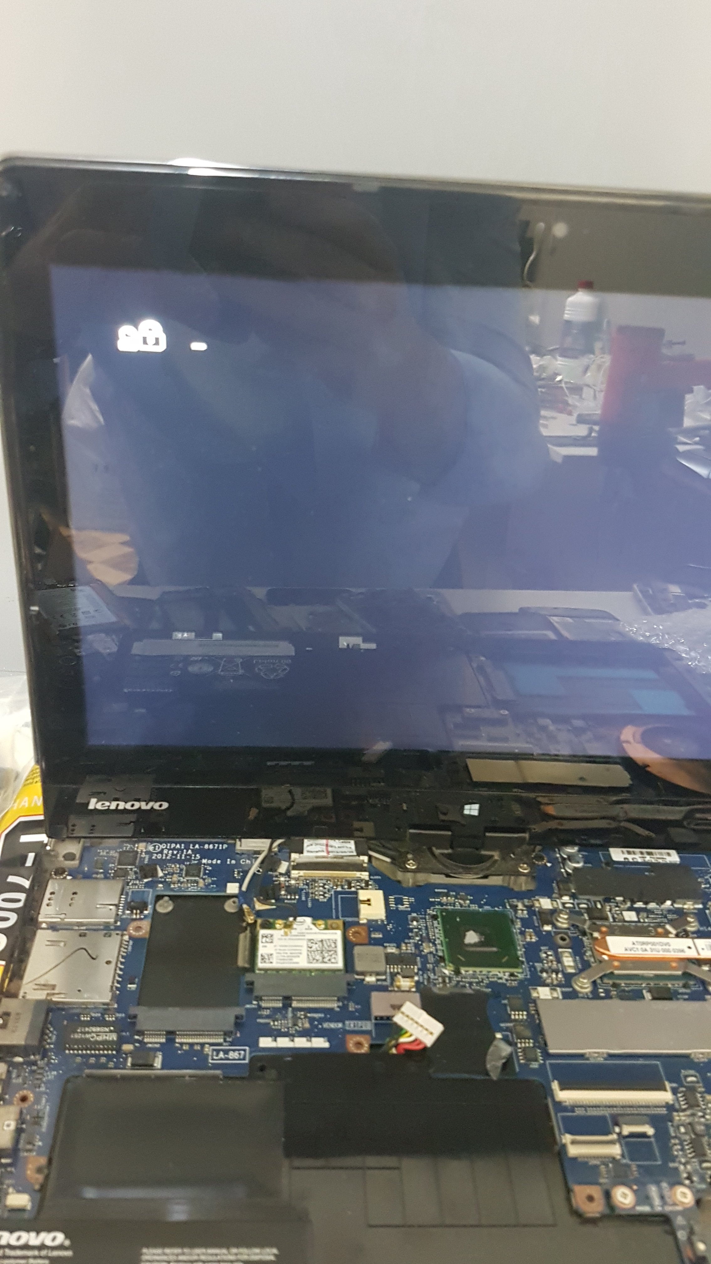

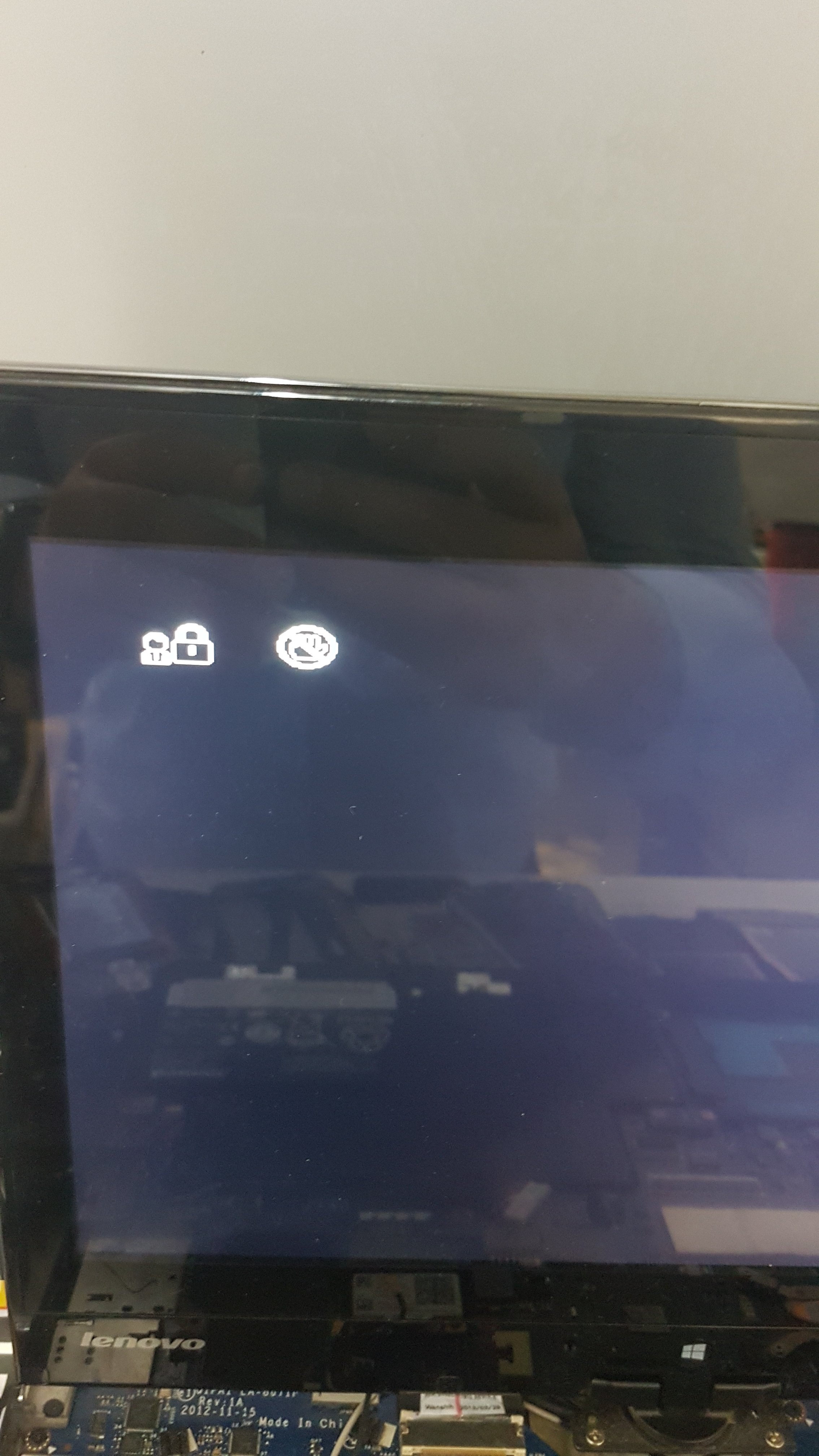

HI THIS LAPTOP IM FORGET PASSWORD PLEASE HELPME
Jul 18, 2020 Replies: 5 HI THIS LAPTOP IM FORGET PASSWORD PLEASE HELPME Download list Click to expand...
T technosonic Registered member Jul 18, 2020 #3 romi" data-source="post: 162796" class="bbCodeBlock bbCodeBlock--expandable bbCodeBlock--quote js-expandWatch"> imranromi said: Send photo lock how look like. Click to expand... Download list

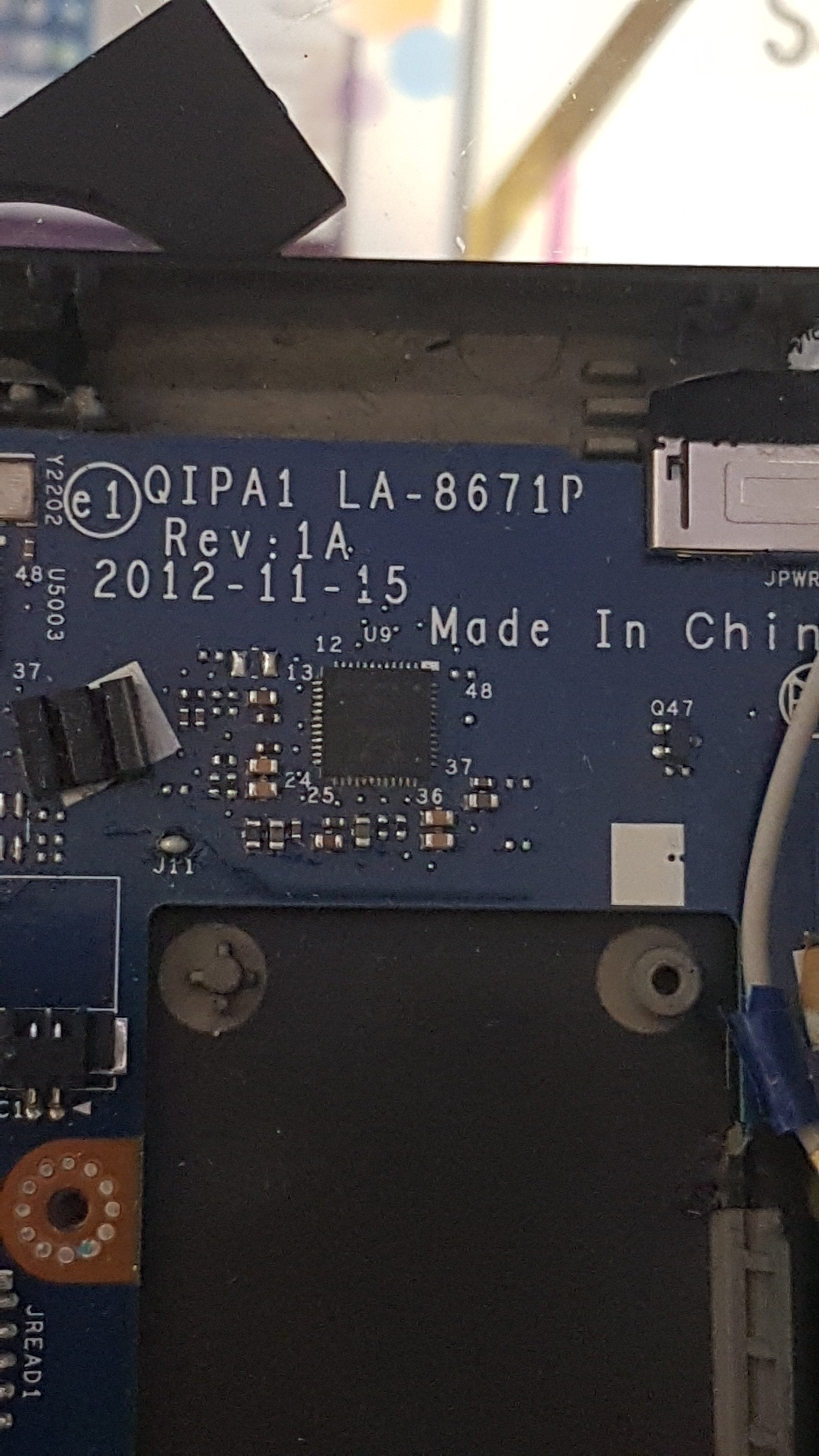

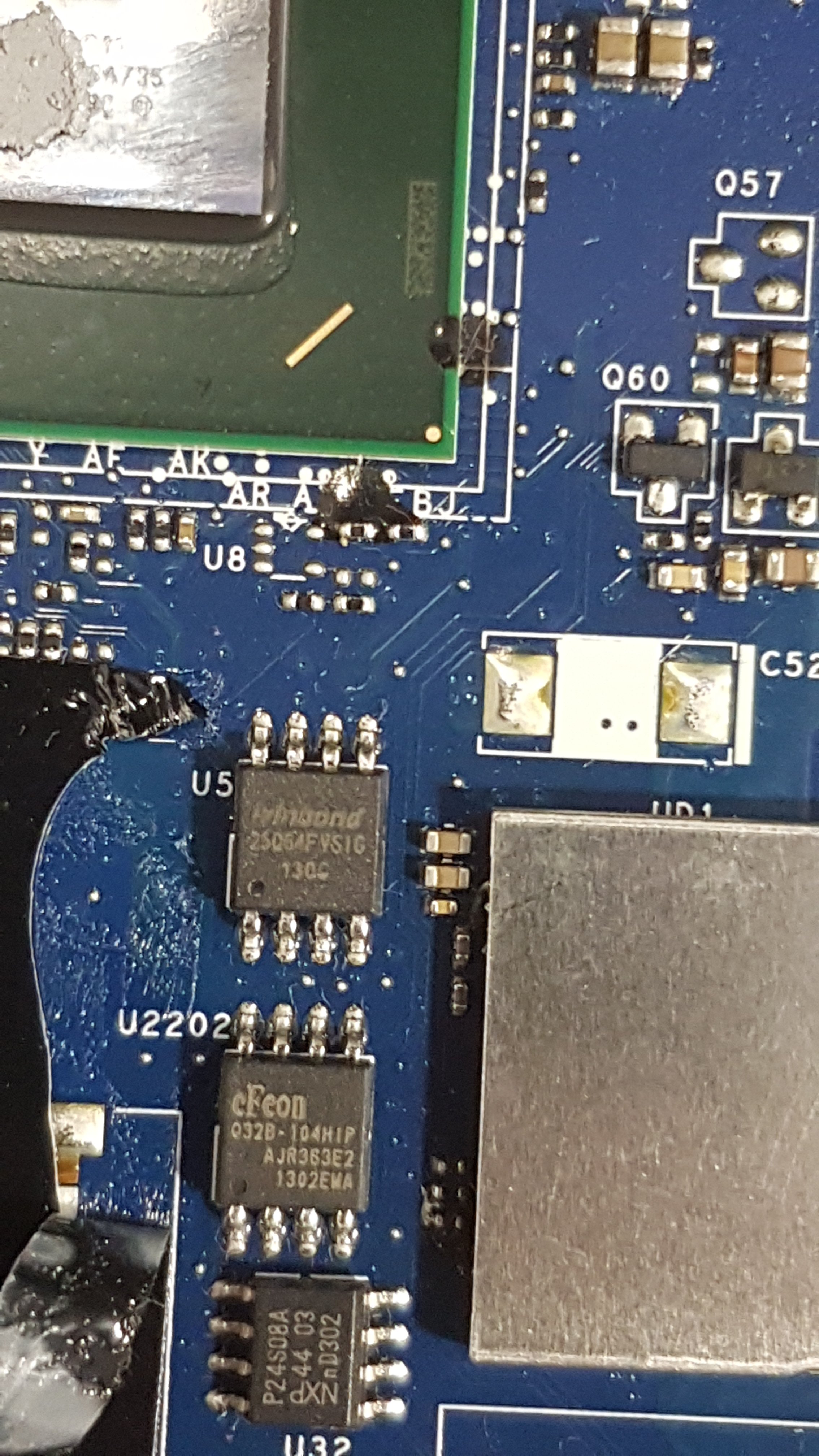

imranromi Active Member VIP PRO Jul 18, 2020 #4 Password not in bios.You need check what security in this board.Send bios file will know.
T technosonic Registered member Jul 18, 2020 #5 2 CHIP U5 AND U2202 BACKUP FILE. THANKS FOR HELP Download list EN25Q32 U2202 S230U.Bin 4 MB · Views: 31 W25Q64FV U5 S230U.Bin 8 MB · Views: 33
T technosonic Registered member Jul 18, 2020 #6 technosonic said: 2 CHIP U5 AND U2202 BACKUP FILE. THANKS FOR HELP Click to expand... THANK YOU VERY MUCH VINAFIX I WRITE THIS FILE AND OK WORKING Download list LA-8671P U2202 BIOS.rar 2.5 MB · Views: 21
