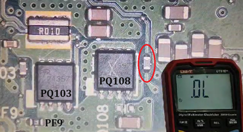

gero Registered member Dec 27, 2023 #1 Hello, do you have any idea what is the identifier of the chip resistor encircled below? BTW, it is defective resistor. Thanks. Last edited: Dec 28, 2023 Upvote 0 Downvote

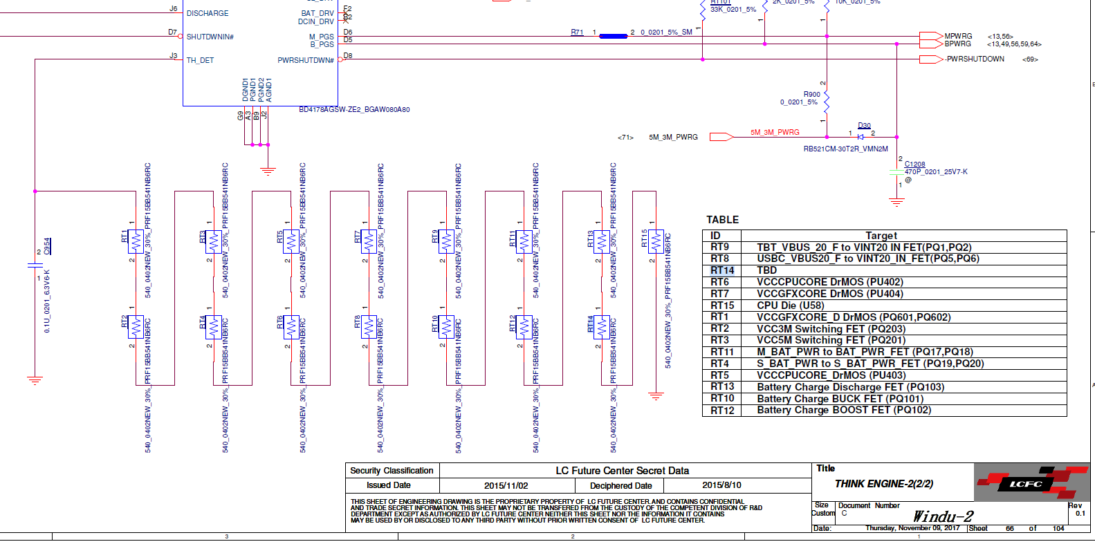

gero Registered member Dec 28, 2023 #2 I already identified the component, it is RT14 and it is a thermistor which sensing the temperature of the PQ108. Reference: T470 Laptop (ideapad) CT470 NM-A931 ideapad 310-14IKB, 310-15IKB, 310 Touch-15IKB, 510-15IKB BIOS Version 3JCN20WW CT470 NM-A931 REV 2.0 CS16 T14 Logic Schematics NM-A931 boardview NMA931R10-SILKBOT.pdf NMA931R10-SILKTOP.pdf vinafix.com Difference T470 vs T480: https://productz.com/en/lenovo-thinkpad-t470-vs-lenovo-thinkpad-t480/v/rBJGV-R1ZED
