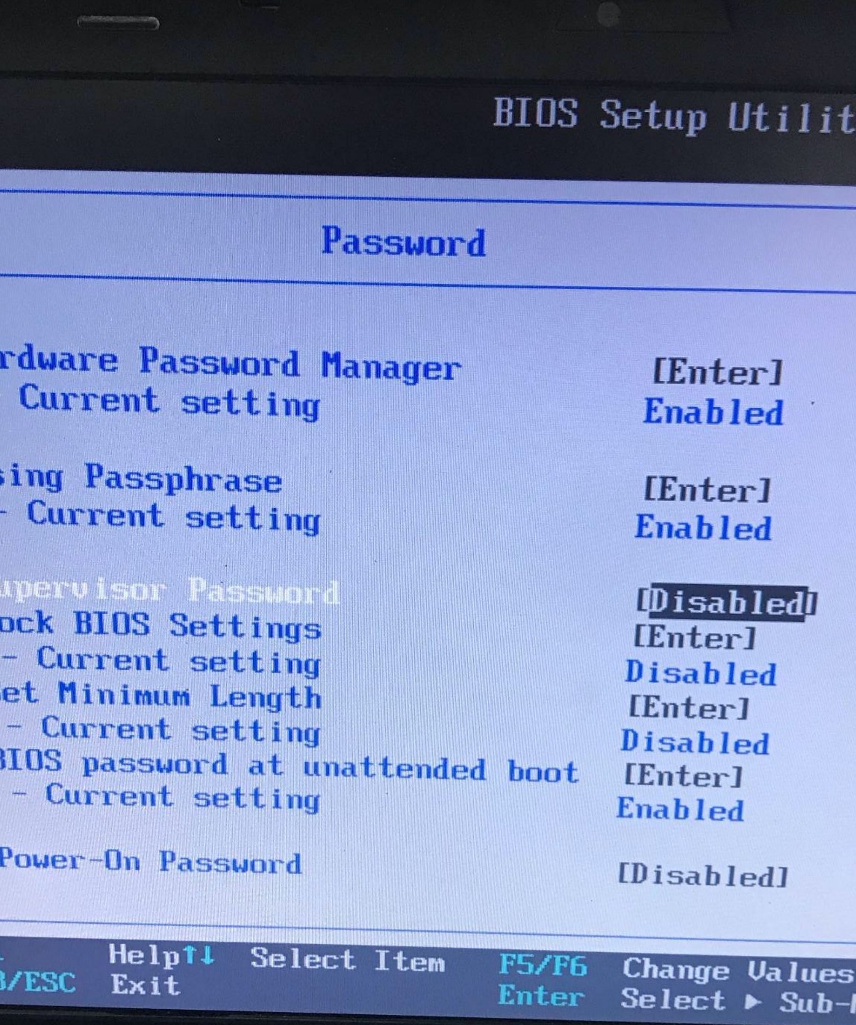

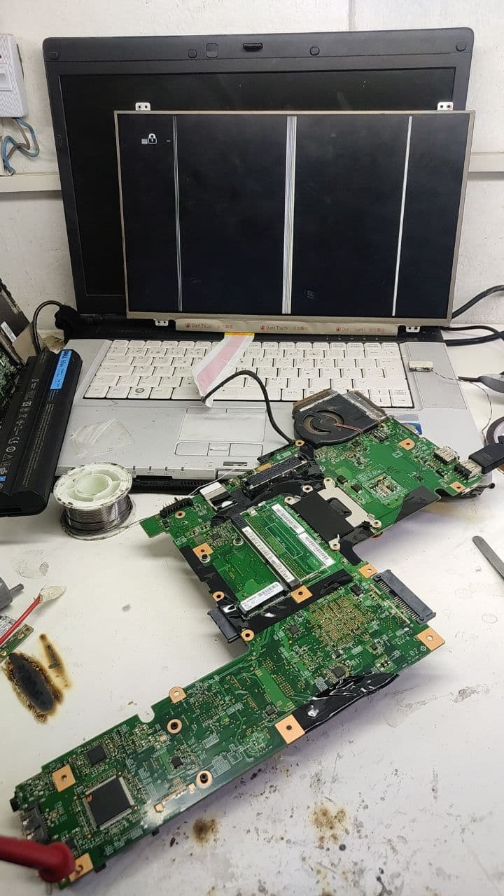

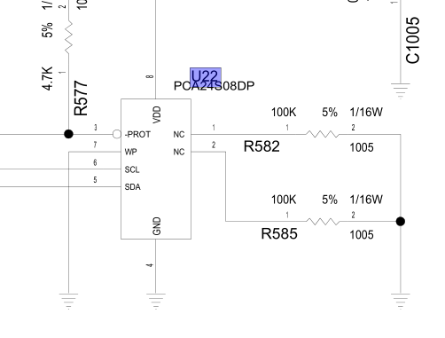

2. The key to the key, find a friend to press the power button, use a screwdriver or a small screwdriver to quickly short the 5 feet and 6 feet, and then let friends quickly click F1, the miracle will happen, found that you can enter the BIOS . Do not reverse this order before or after, otherwise it will be invalid.
3. Since you can enter the BIOS, you don't need to elaborate on it, you can clear the password. Still send a picture.
