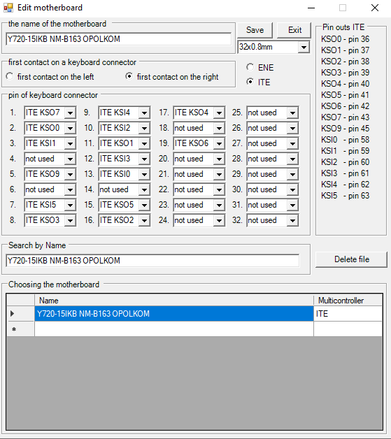

NM-B163 IT8171 KB_pins=32 (JKB1) 08MM FLASH=56 PD0=2 PD1=11 PD2=16 PD3=8 PD4=17 PD5=15 PD6=19 PD7=1 BUSY=5 STB=13 AFD=3 INIT=10 SLIN=12 KSI4=9 KSI5=7

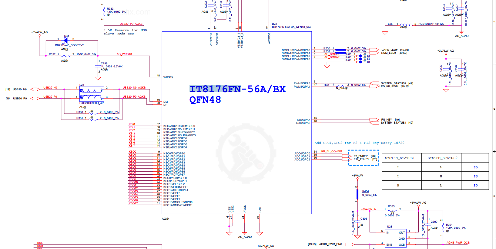

This is a solution if I have Error Code 43 at my Lenovo legion Y720 with gtx1060 video card?
How I can made bios rewrite at my video card (included on motherboard)?
I already try more different windows systems... more-more drivers …
I don't try yet Reballing … I hope problem is software.
Also in Safe Mode I see Nvidia GTX1060 correctly *without yellow triangle in Device Manager .

You can ask him to heat up the GPU chip to check first
in Schematics i see IO
IT8226 but you say IT8176
and EC rom is 128KB
Available here
IT8176 - it's a keyboard controller communicates via usb with PCH. IT8226 it's IO and i have dump from it. I need dump from IT8176 .y720.png
