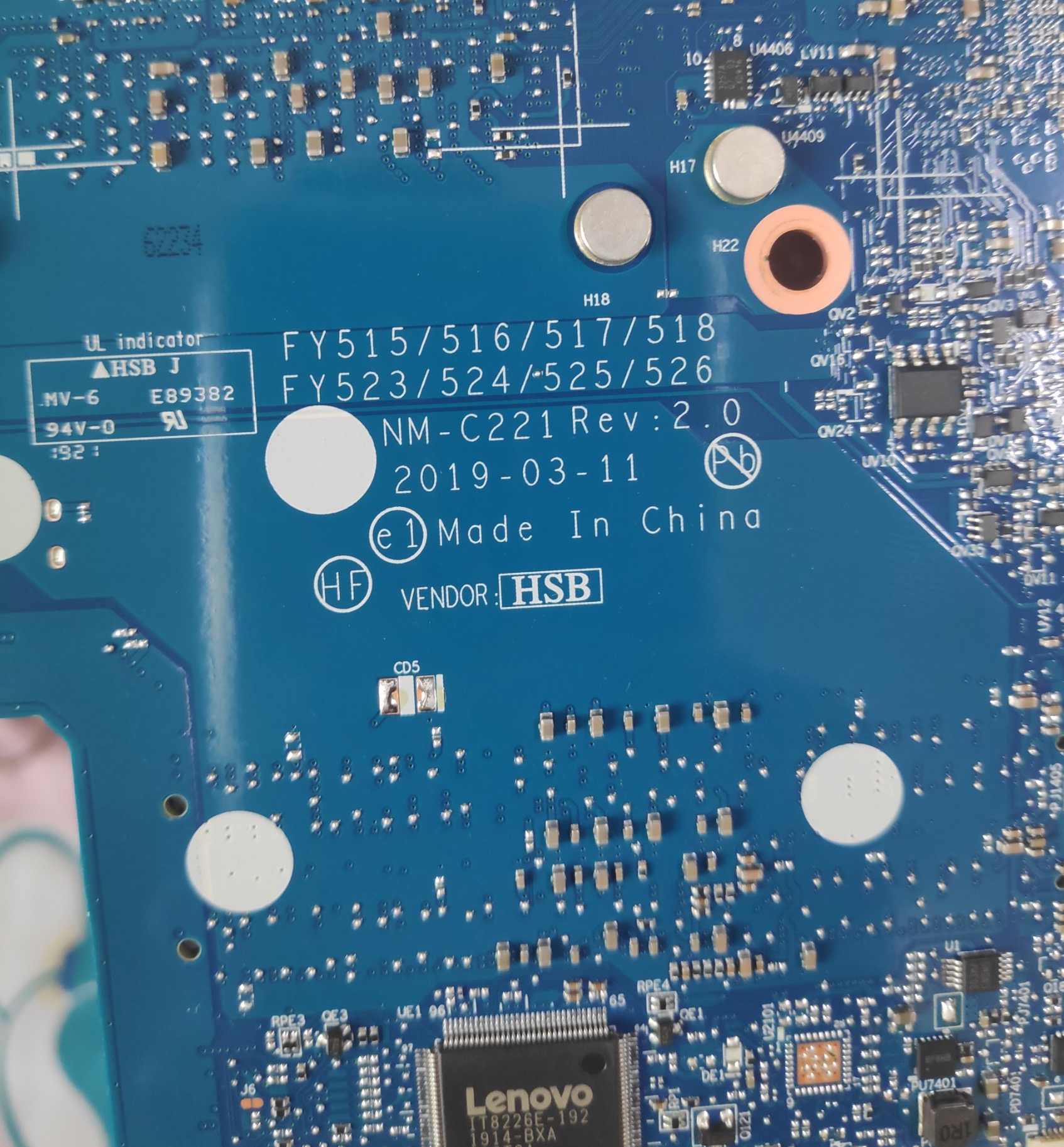

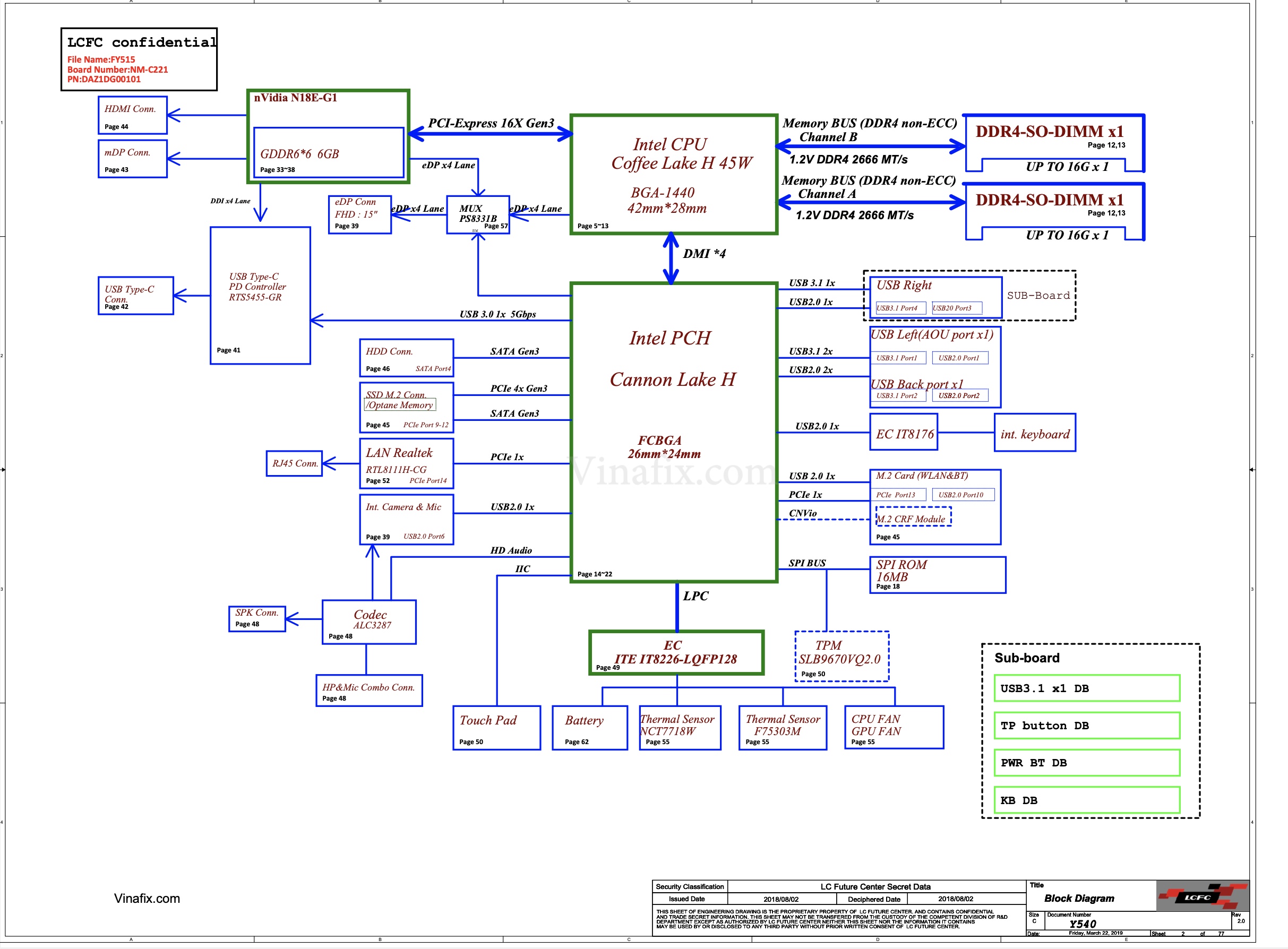

Thien , you have to read carefully for what US users , trying to say you .
some machines HAVE 2 kinds of ITE , one 128 pinout , and another one of 48 pins .
when you flash EC true keyboard socket . you will flash not the ITE8226 (128pins) but you will flash IT8176FN (48 pins) ..
so what happen is that the regular EC rom (128 or 192 or 256 ) DON'T have keyboard dump .
FOR ex this machine if you READ the file true the keyboard socket , it will save you a file of 56KB . because if will not read the 8226 , but instead if will read the 8176fn . understand now ?
i've seen you many times here arqguing with people about this . and your not right !
also doesn't mather if you grab the EC file 192 or 128 and cut it to 62kb , because IT WONT work ... comprare the info insyde bios with an HEX editor , and you will understand . chek this file im uploading VERSUS the one you just sent me !!! and tell me if there is anything similar to it !
if u still need it. here is the file
