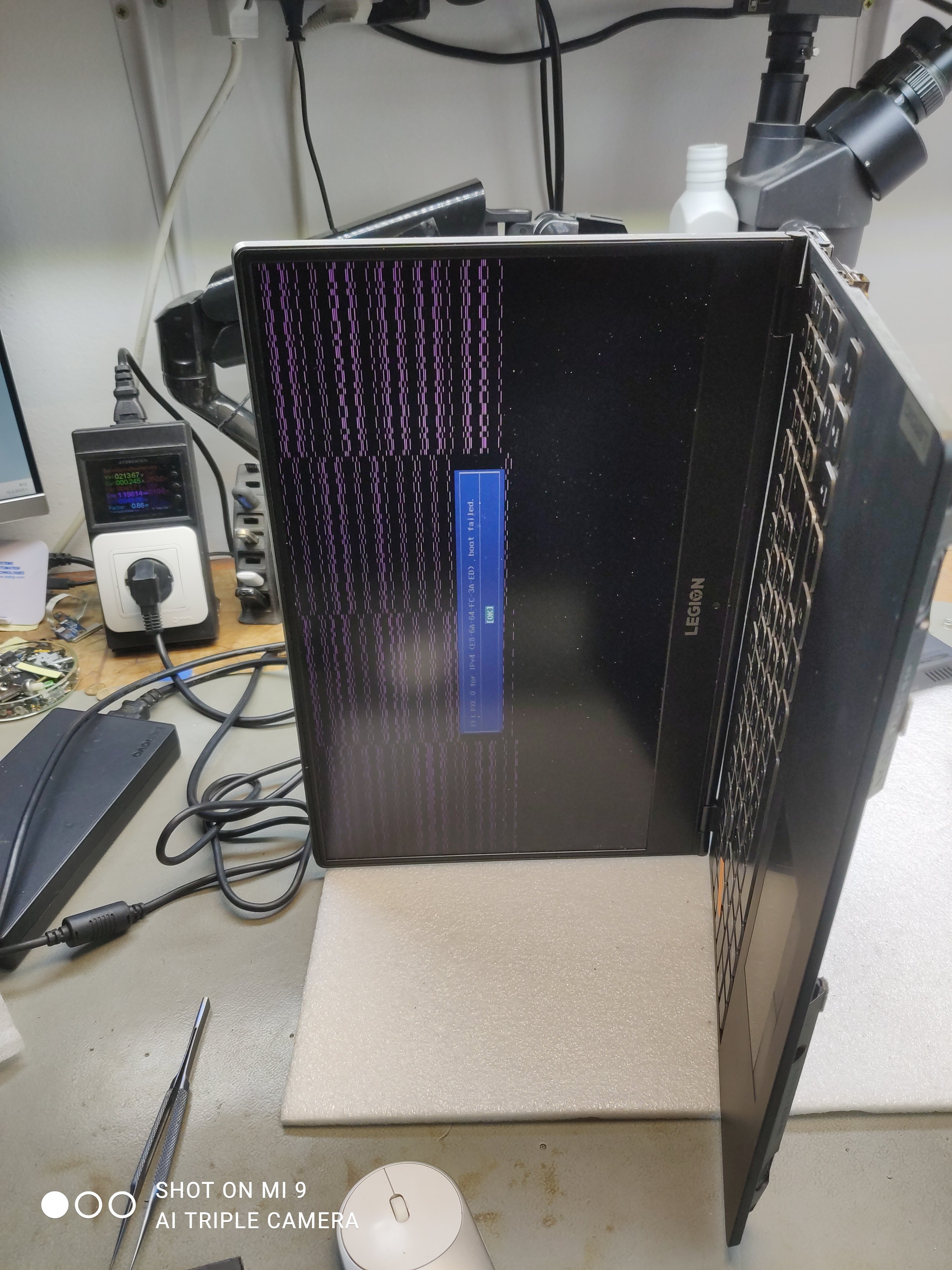

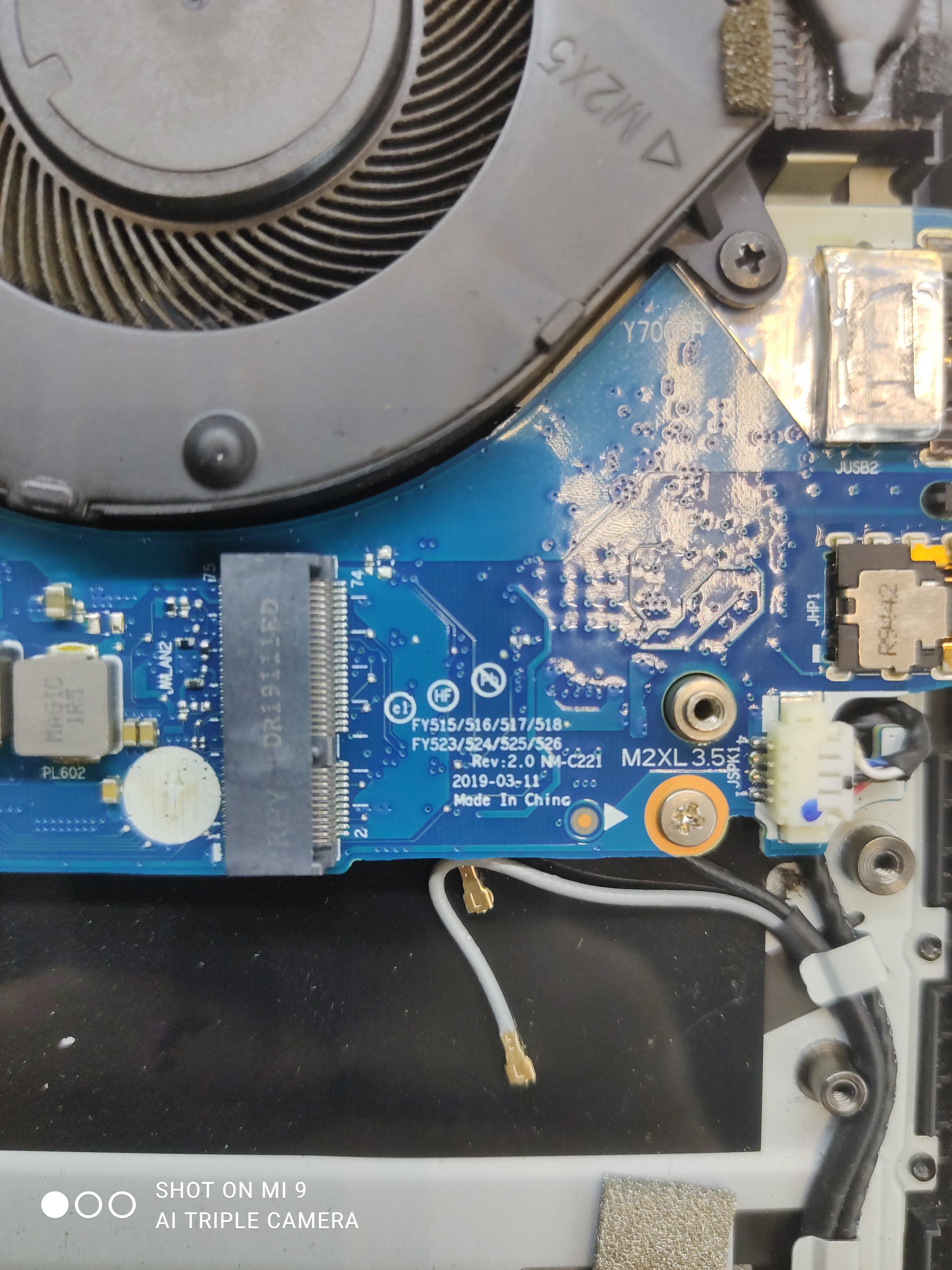

I tried this bios, as well as others above (I don't want to waste your time), with them the effect is either no power or video garbage on external vga. With the original bios, the machine turns on only with a cursor on the screen /can't boot(No video garbage). Is it possible that the video cards of the motherboards are different and an incorrect bios for the machine leads to the wrong addressing. Please rebuild my bios I expect this will solve the problem. Thank you for your help.

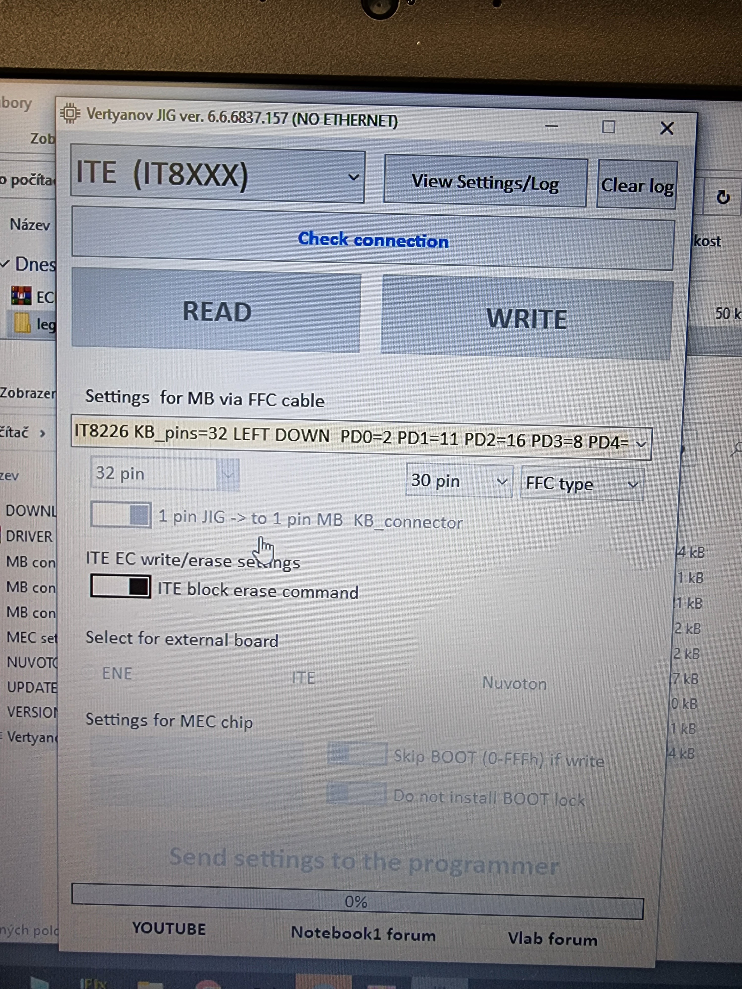

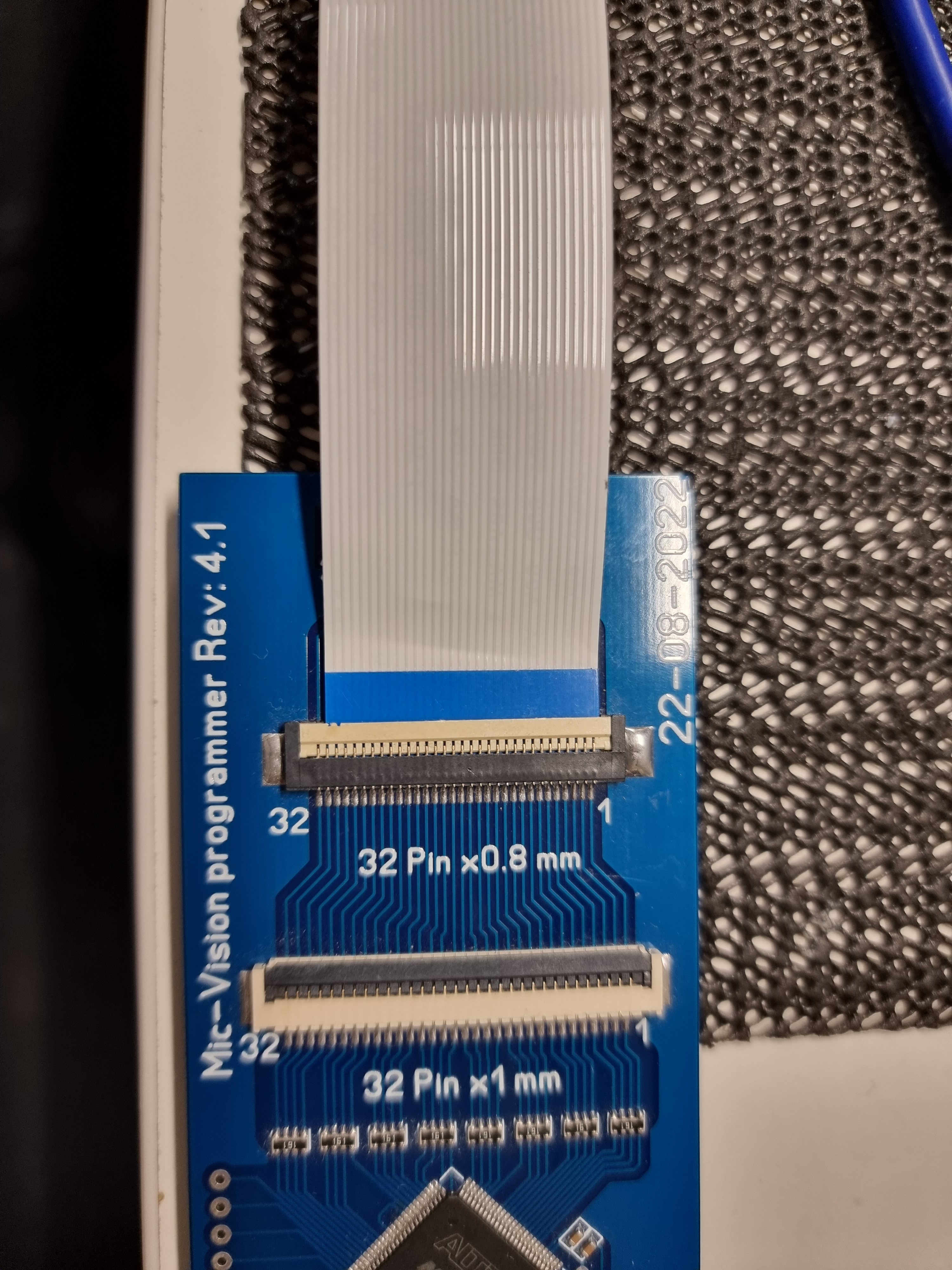

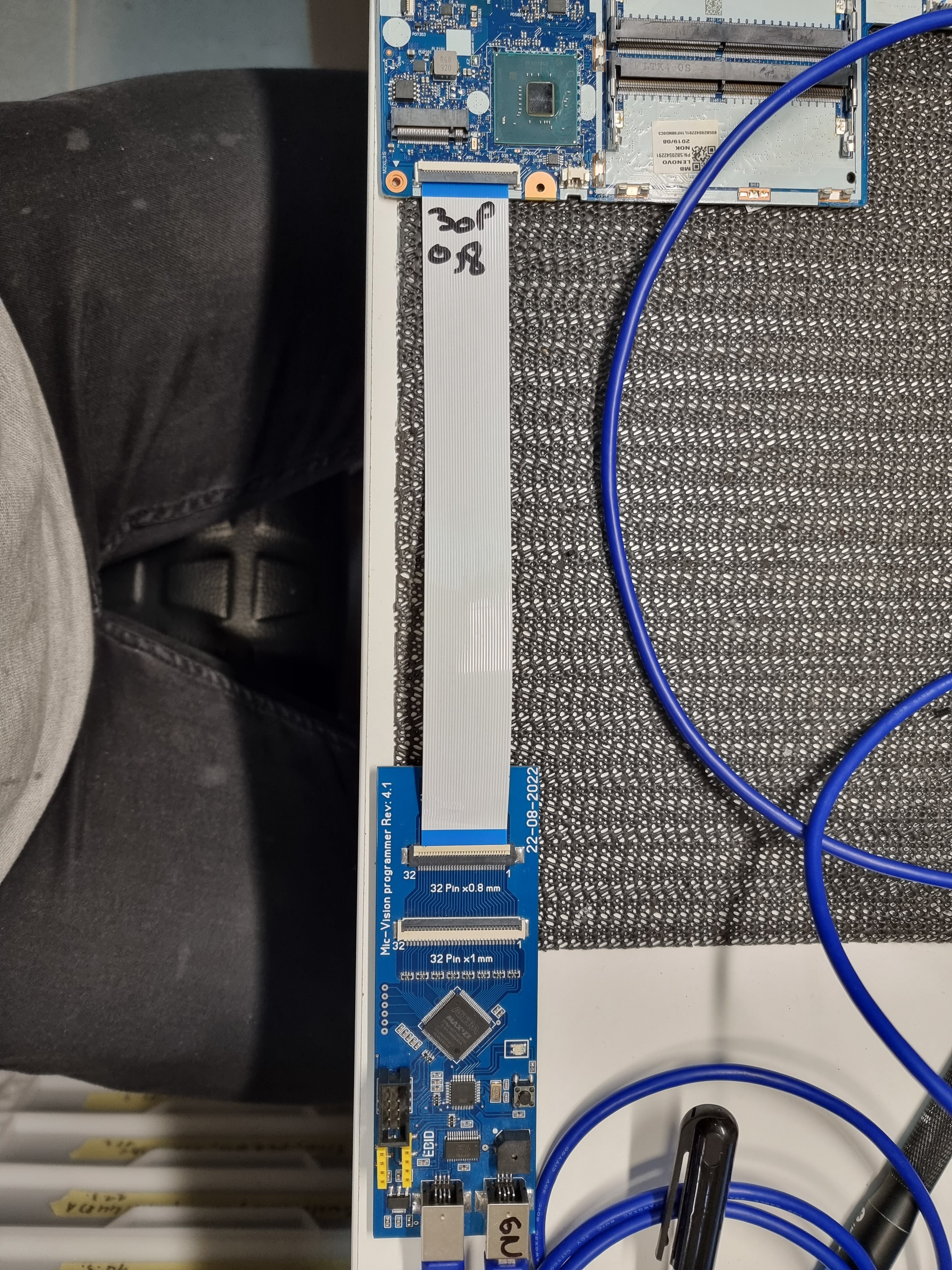

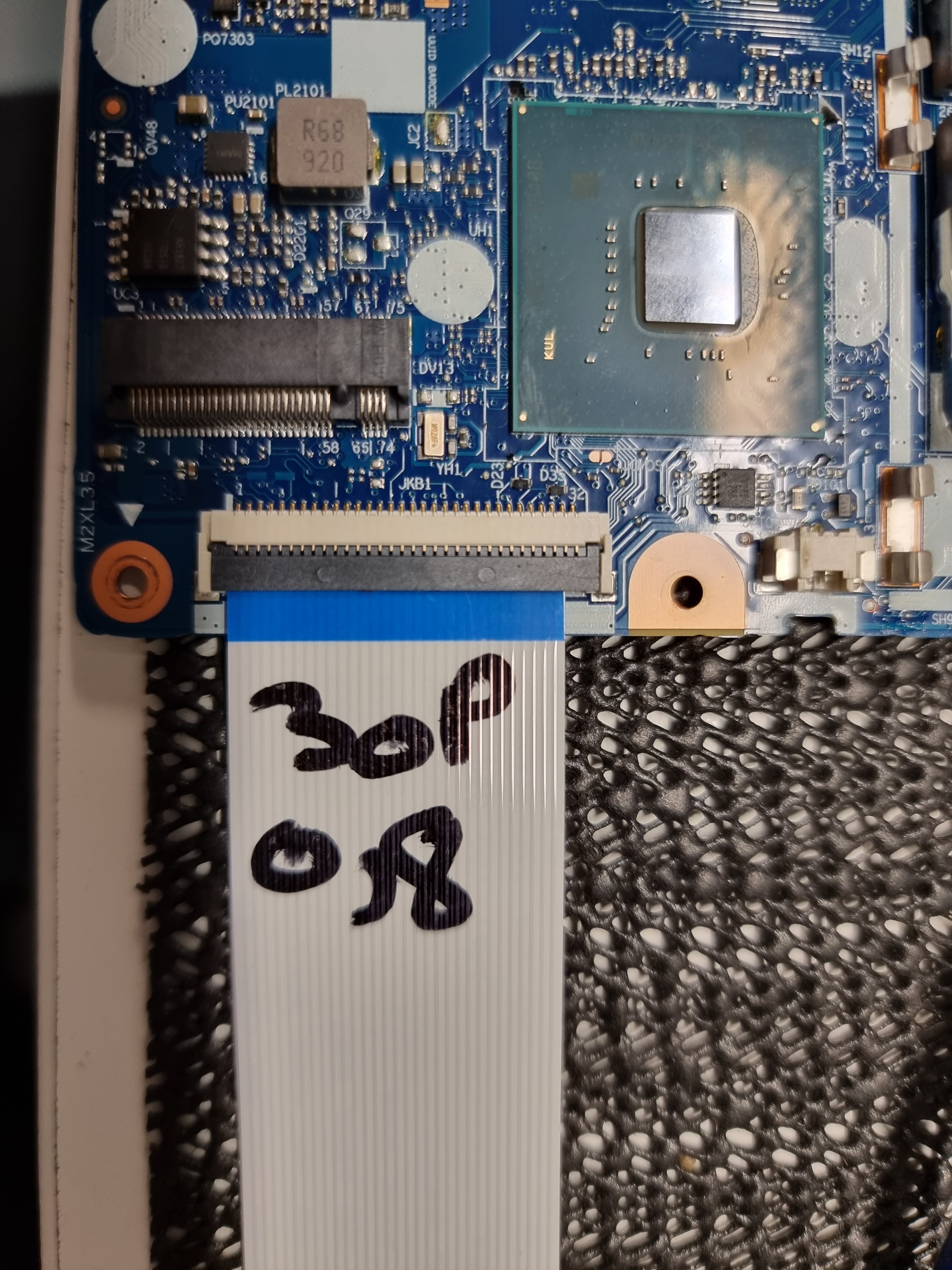

Hey boss,
I have problem with programming i/o chip on legion.
I/O chip: IT8226E-192 BXA
Motherboard: NM-C221 Rev: 2.0
The problem is, that i cannot swap 1 pin jig to end pin on MB. The option is grey and i cant change it. Any help how to do it please?
Thank you very much.
