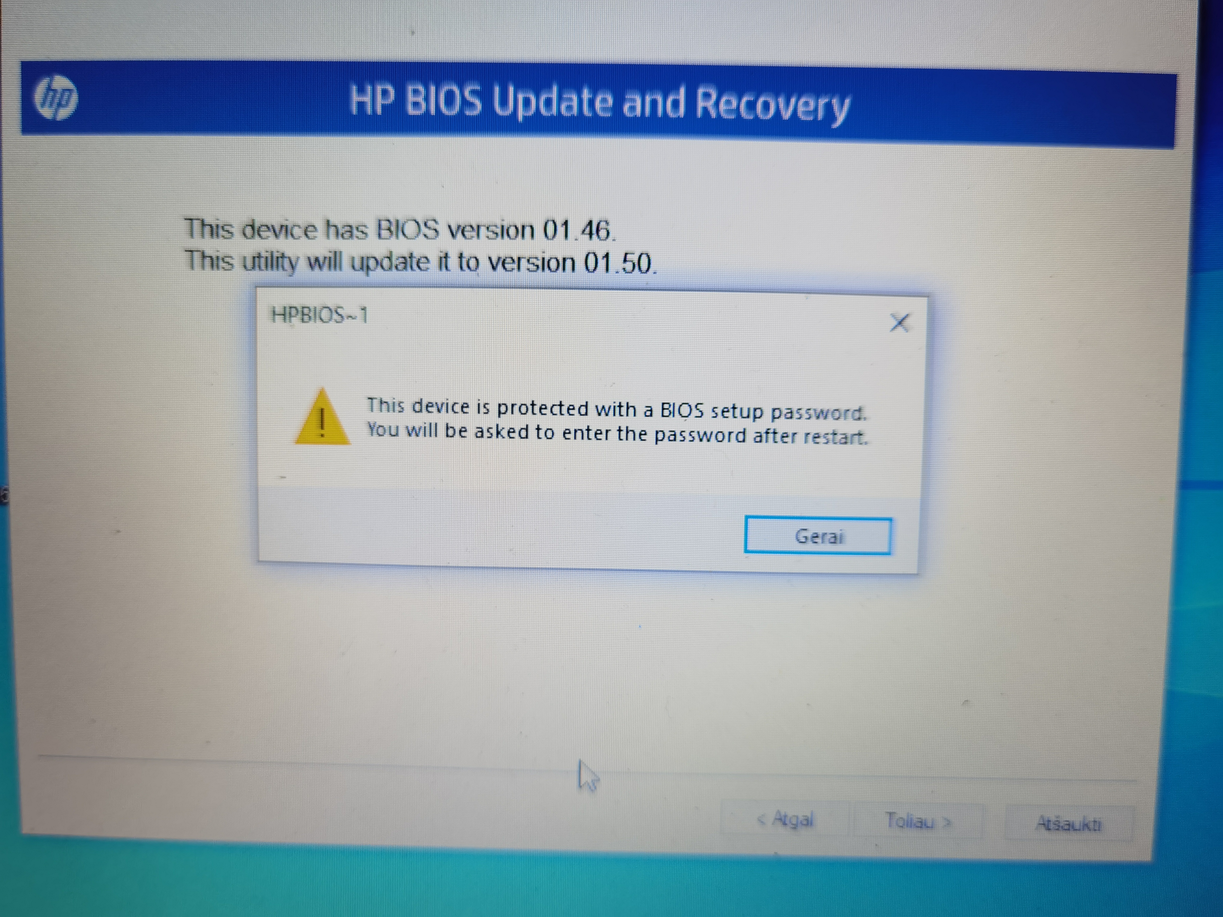

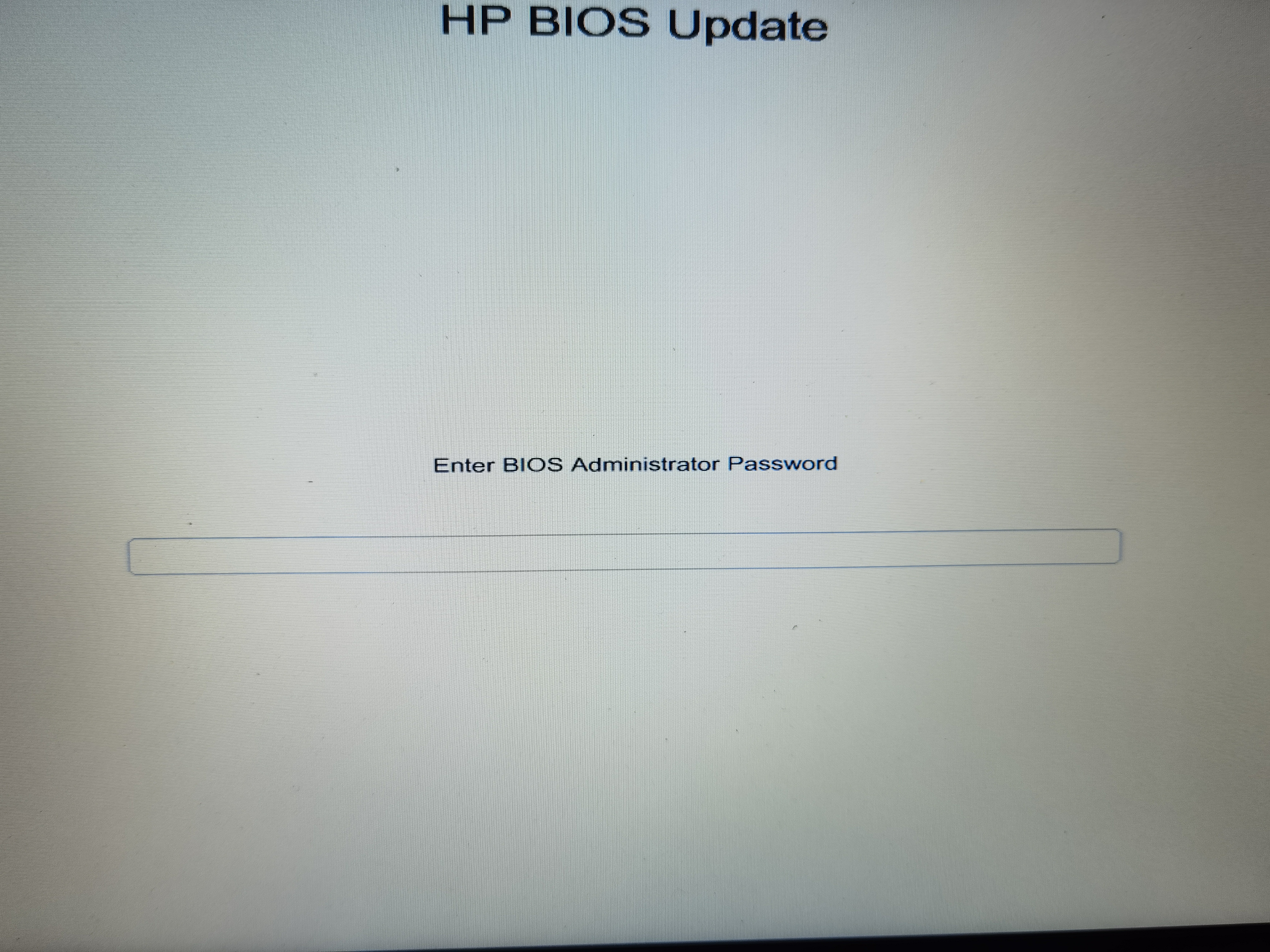

I extract unpas1.zip, with programmer --> make open -- > unpas1.bin --> erase --> program --> bios chip soldering to motherboard. Insert USB drive with Windows setup, install windows --> install hp drivers and now, i want update bios from hp official, if i want install bios from hp , i get --.> Enter BIOS Administrator password.
What you mean ?

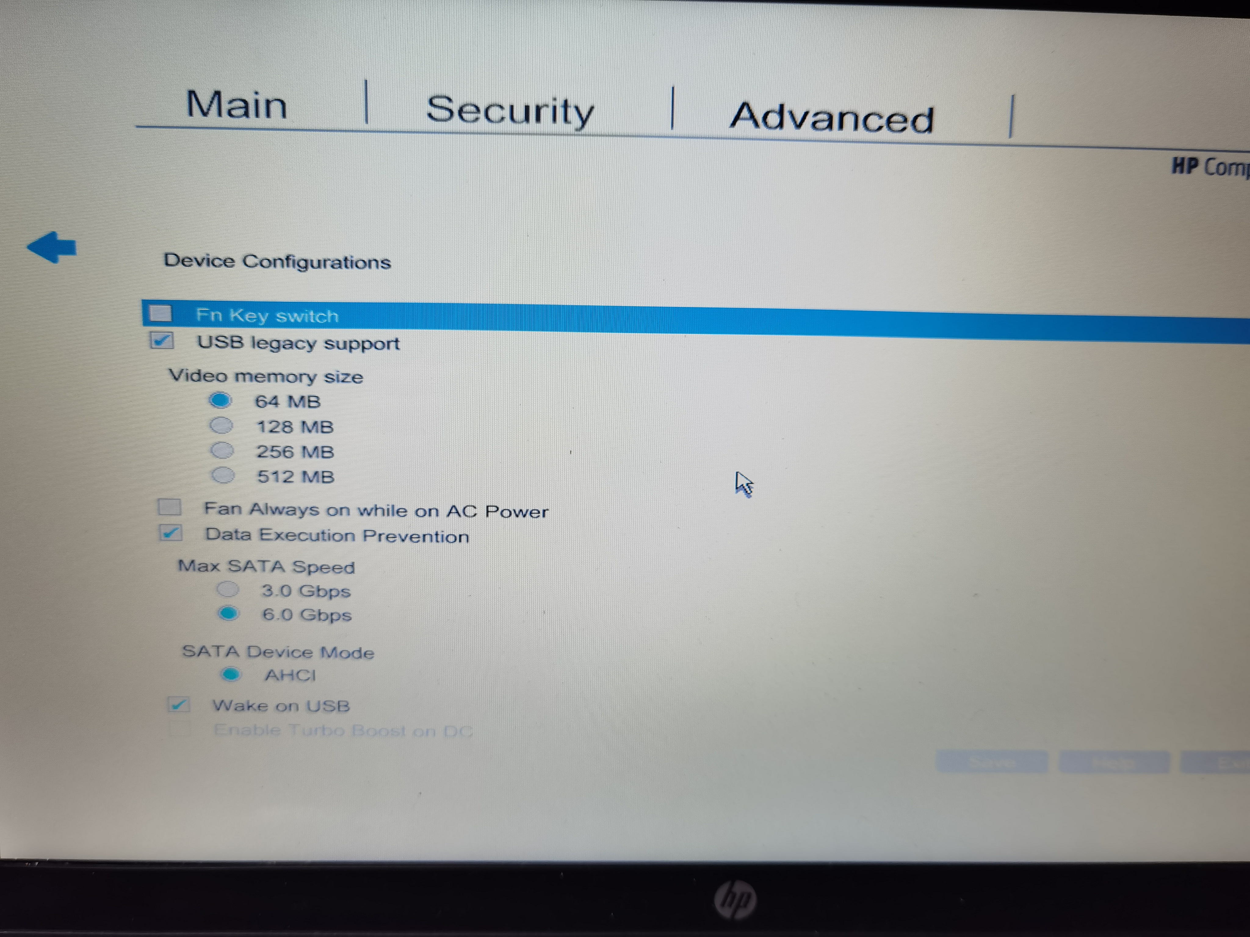

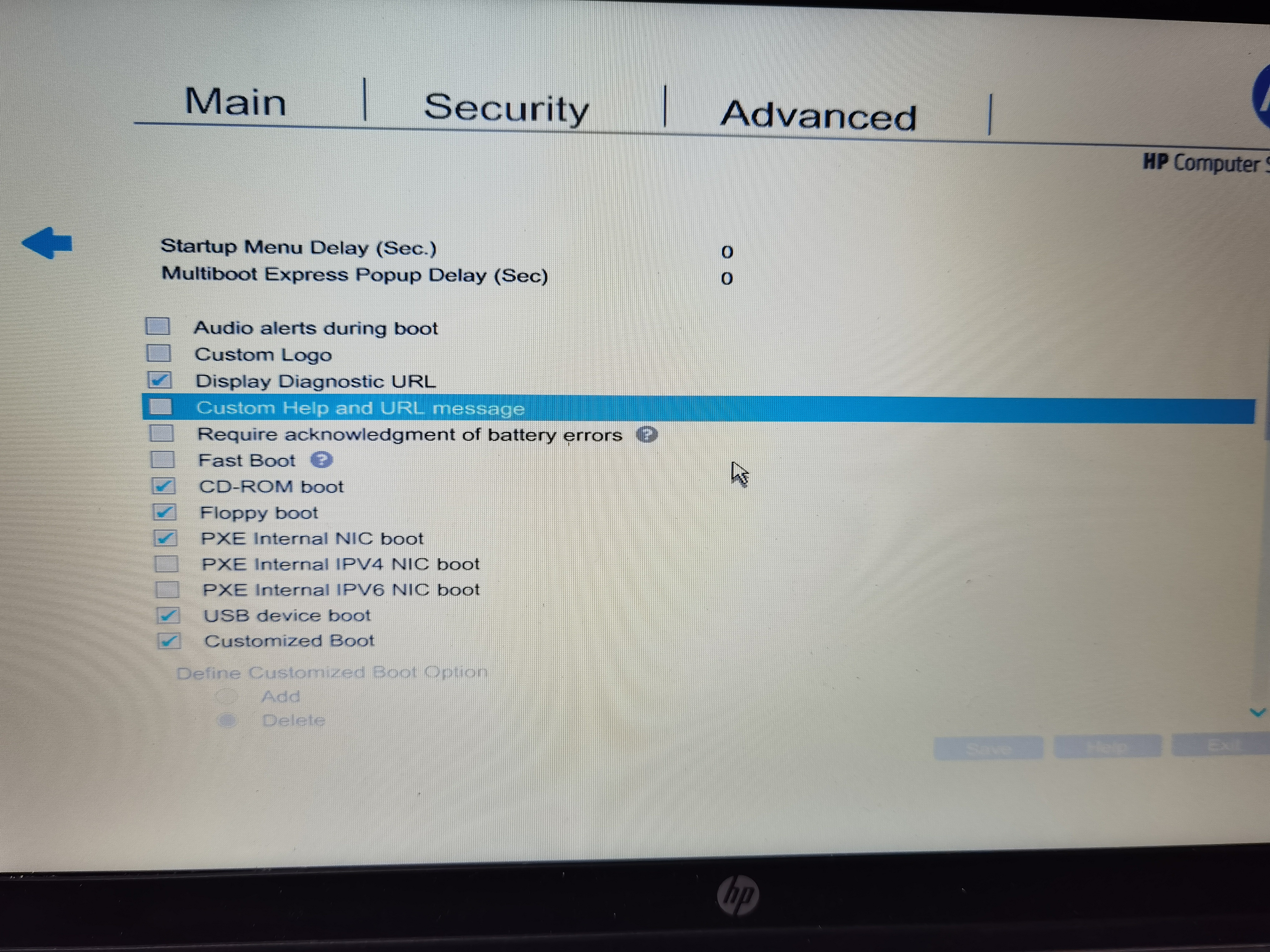

I don't know, but i have one problem, when update your bios, i get full BIOS control, but, when i shutdown computer, my computer no power on, when i remove CR2032 battery, when my computer power on, but when i again --> shutdown, computer no power on. Strange, with locked bios, this problem do not have.
