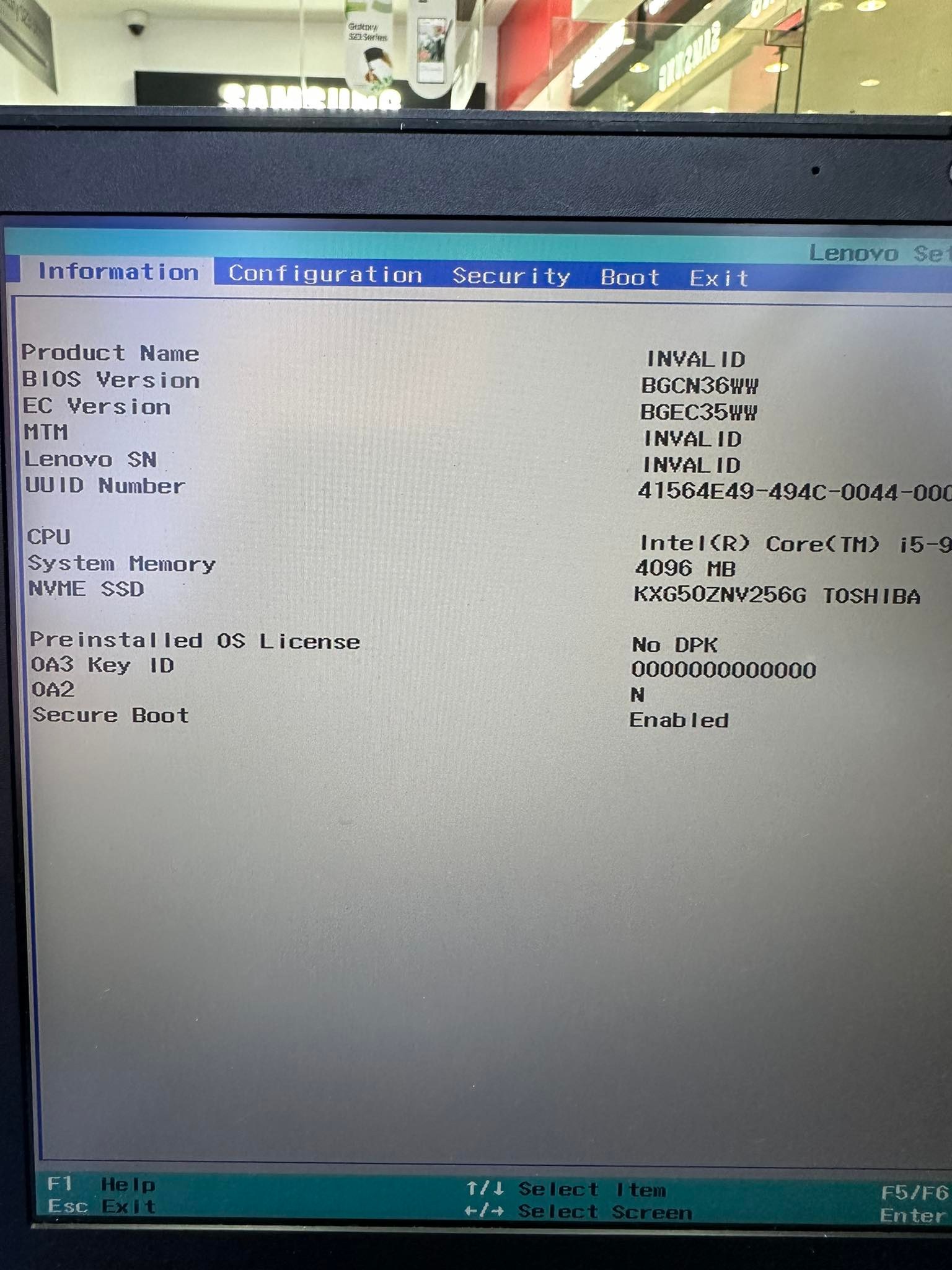

Hi sir good day. My laptop has no display issue. After flashing bios using your given bios firmware. It shows INVALID info in Product name, SN and MTM.
Can you help me fix this?
Product Name: IdeaPad L340-Gaming
SN: PF1Y8W7N
MTM: 81LK00W4PH
I attached my original backup firmware for reference.
Thank you.
