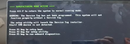

I installed v1.4.1.bin.zip Bios due to random switching on.
Now it is giving message Service tag not programmed. kindly help me out.

I tried 8mb but did not work.
Might some thing wrong with 16mb one.
original bios is attached. kindly clear me.
Some times boots up normally but some times dead.
16mb no have clearme if you want you can download the BIOS above and program
