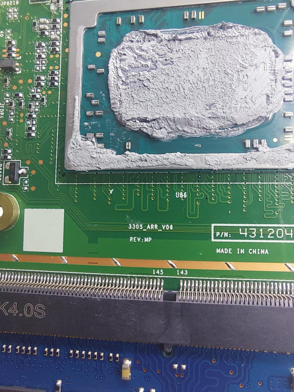

Hello. We have 2 MB´s. First one is the original, it´s dead. Customer replaced the MB with the very same model :
330s_arr_v06 rev mp. The "new" MB is working, but numerical KB doesn´ t. We tried the keyboard on external tester (svod). All characters work as it should. We checked the pinout from KB to Multicontroller. All good, MB is same. We tried to reflash BIOS and EC bios multiple times. It´s not working. All is good, MB´s are same model and revision. It´s just not working at all. (Laptop works normally).Can your provide some help? we are still measuring all other possibilities, but if you have some clue we´d be glad so we don´t waste more time with this. It´s unusual problem for us.

This is the hardware on a new motherboard that does not support numeric keys.
so is it possible to remove it? It´s the very same motherboard even the model and revision is same. It´s not possible it has other hardware. We checked all the things. We even flashed BIOS and MUC with binary from 15" version (cut from manufacturer) But after that both DEL keys doesn´t work and the num KB doesn´t work. All other stuff works normally. We think it might be a BIOS problem afterall . All Windows sounds works normally. Everything works the same .
