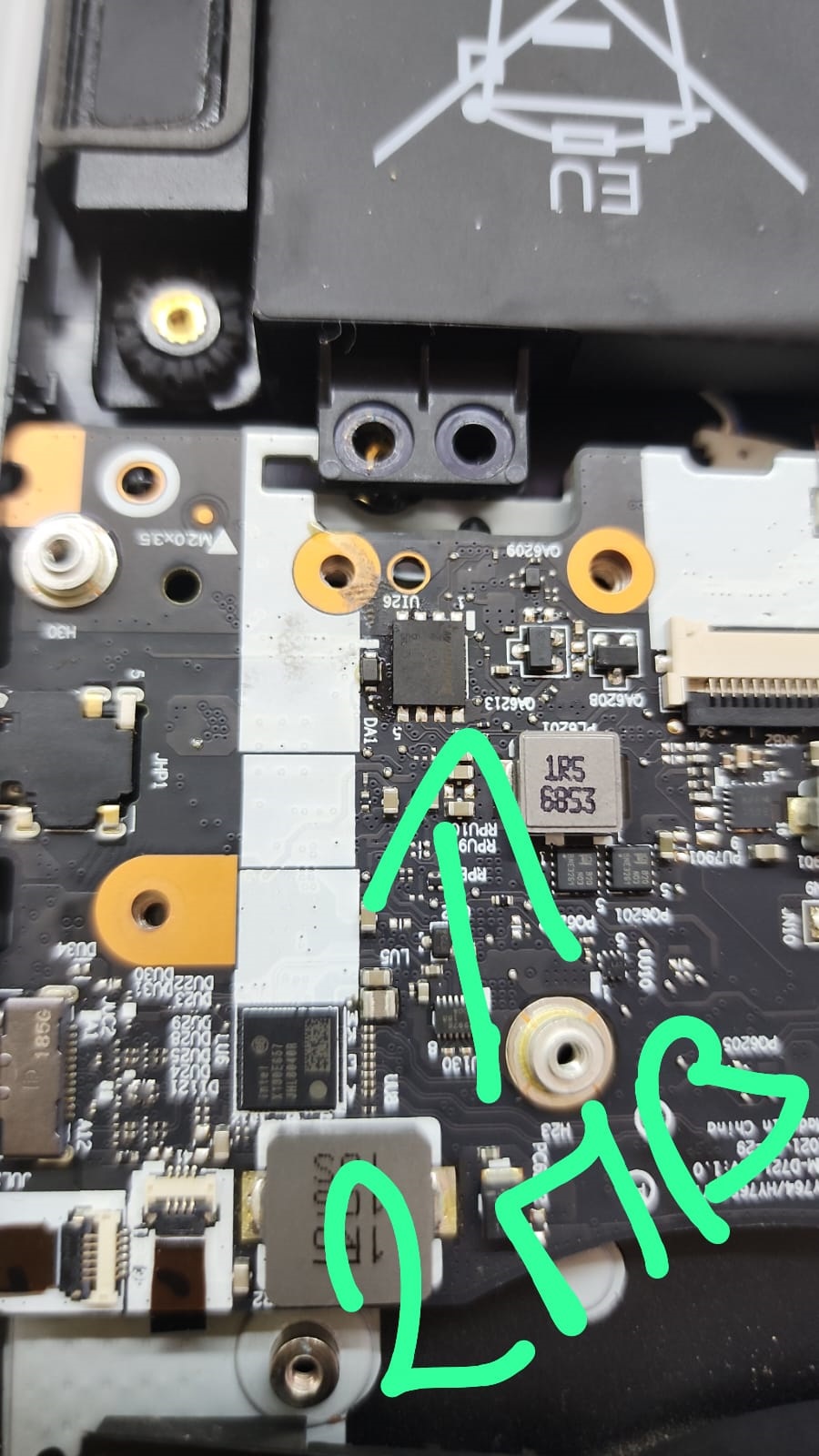

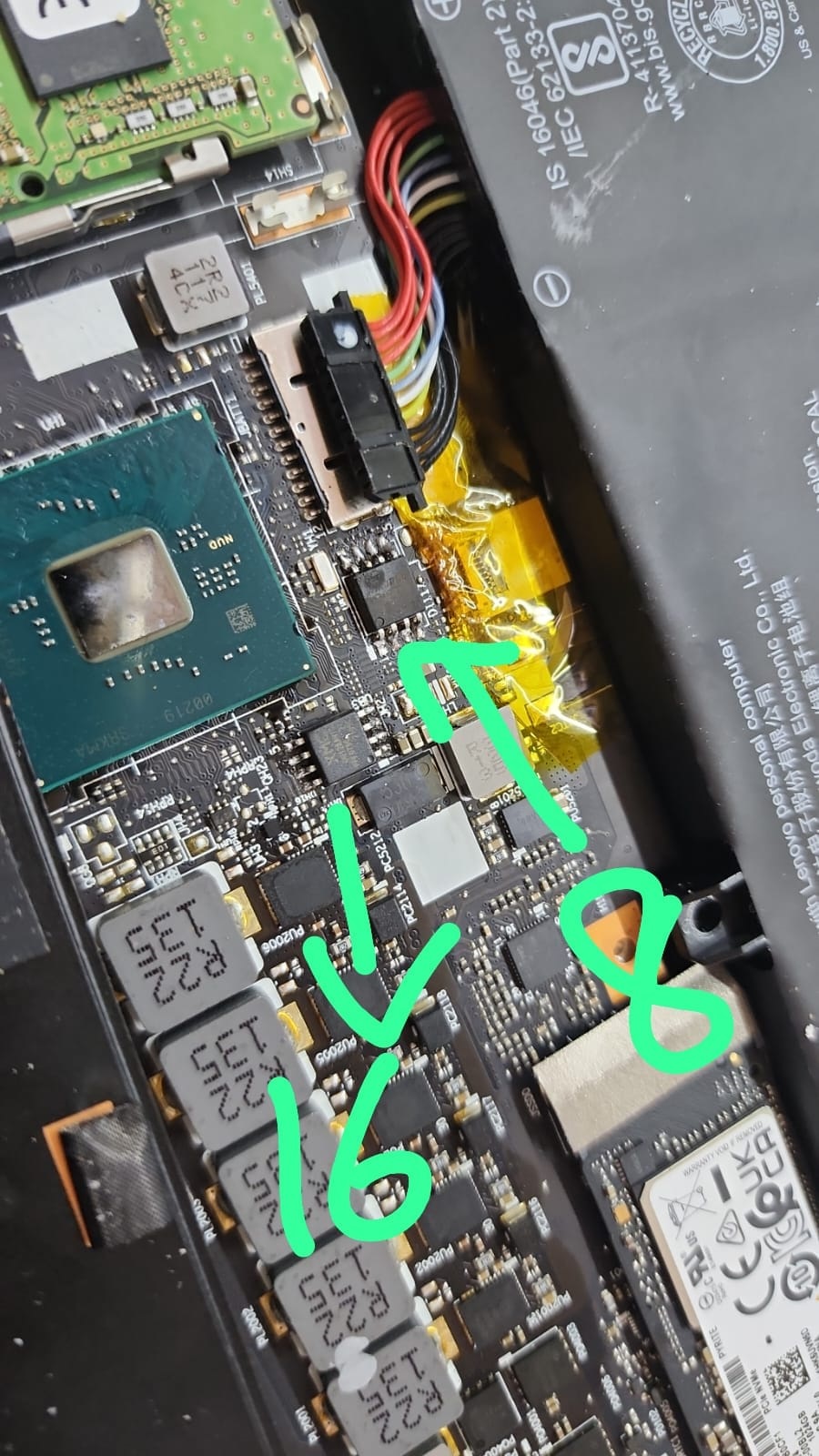

I need the bios, there are 3 files 2mb, 8mb and 16mb
My Lenovo does not give an image, it only turns on the keyboard and the RGB... I just changed the settings to reinstall Windows, it restarted and esp happened. I already disconnected the battery from the cmos but it's still the same, I tried to flash the bios and I see that there are 3 chips of 2mb, 8mb and 16mb
Does not show image
chips 8mb, 16mb,2mb
changed the bios settings to boot from the pendrive, it rebooted and the screen didn't turn on anymore, only the lights

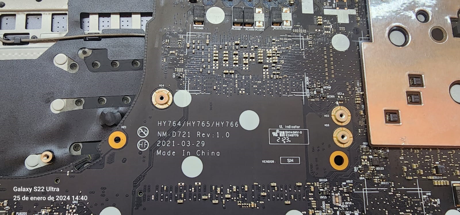

LENOVO LEGION 7 16ITHG6,NM-D721 rev 1.0

Hola instale el bios 16mb y funciono dio display pero no encontraba ssd to boot windows - cambie a secure boot y salve el cambio y ya no dio display otra vez. se tiene que instalar los dos bios de 16mb y el de 8mb para que funcione?
Hola, yo la instale las dos bios y todo funciono correctamente
