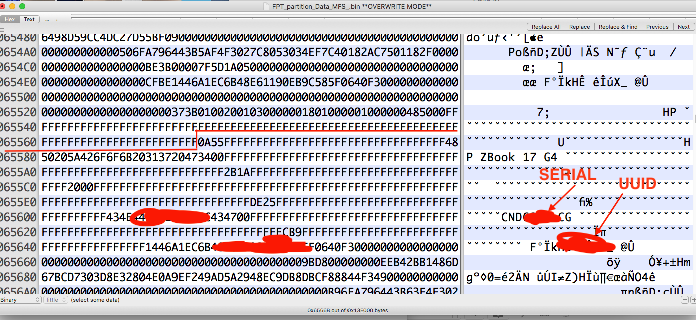

I have found serial and UUID, but can i edit it without corruption of bios?View attachment 201062
Maybe microsoft serial is lzma compressed?
Thanks, I have made ram patch script to fix region in ram. But one day i can delete it accidentally... so was looking for some manual or so. if you do know, give me a hint ) Is it lzma or binnary shift?Need to copy manually takes a lot of time, I can switch to another BIOS for 15$
