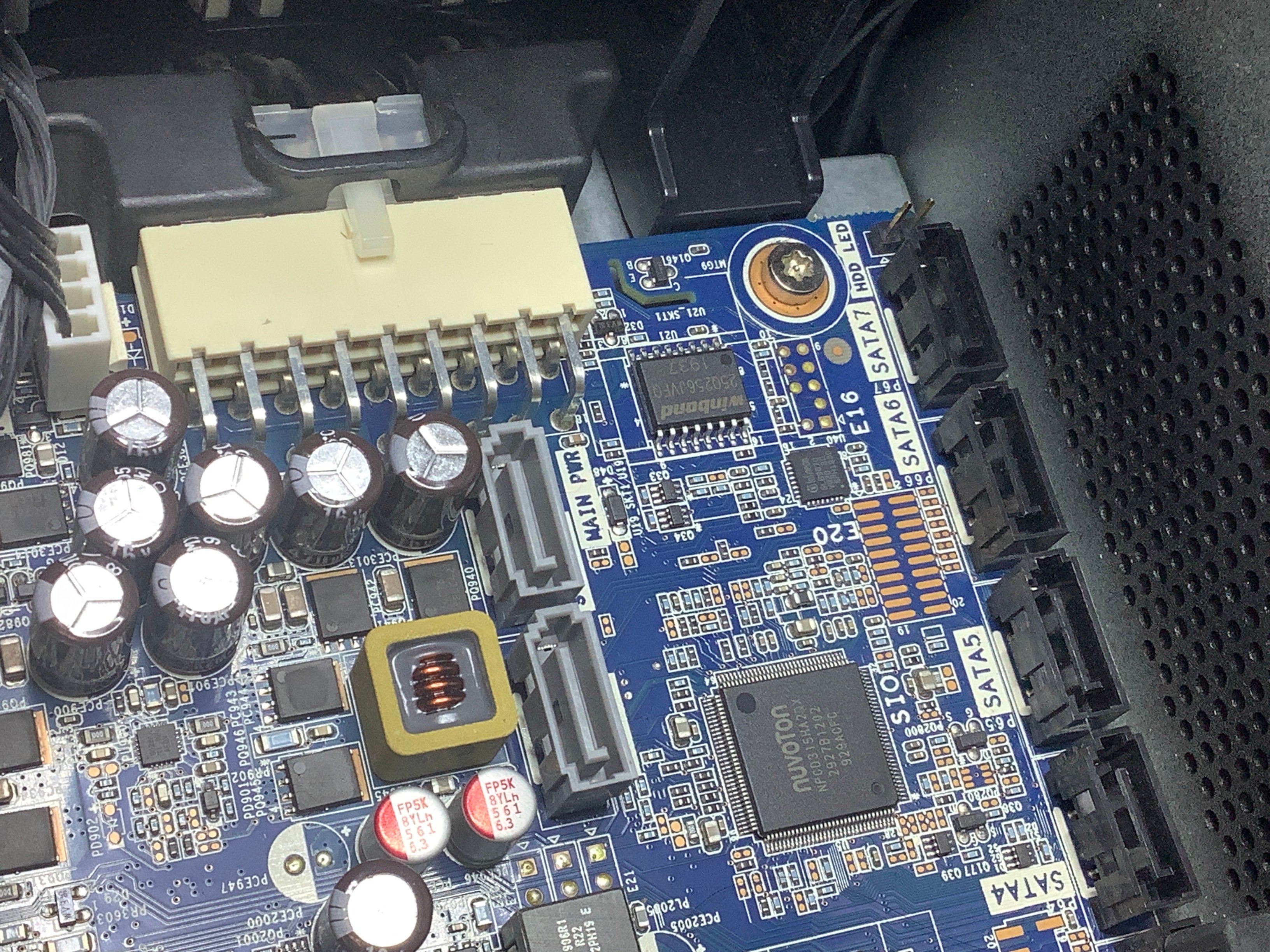

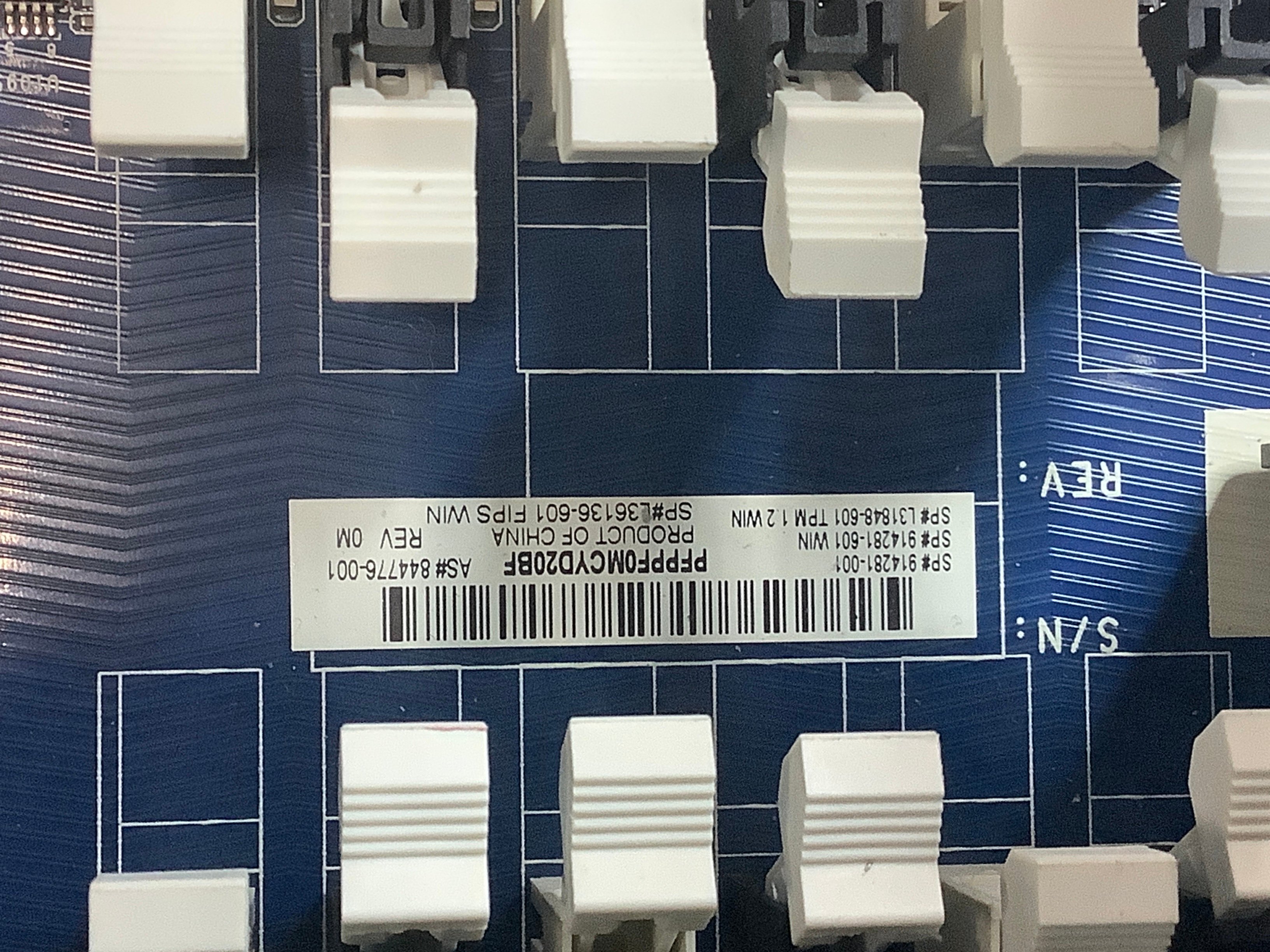

I have a faulty workstation HP Z8 G4 (motherboard FMB-1703). The problem is that it won't start. The main problem is a BIOS malfunction. I took a BIOS dump from the faulty station. I also took a BIOS dump from another working workstation HP Z8 G4.
Can you help me make a normal BIOS dump for a faulty workstation?

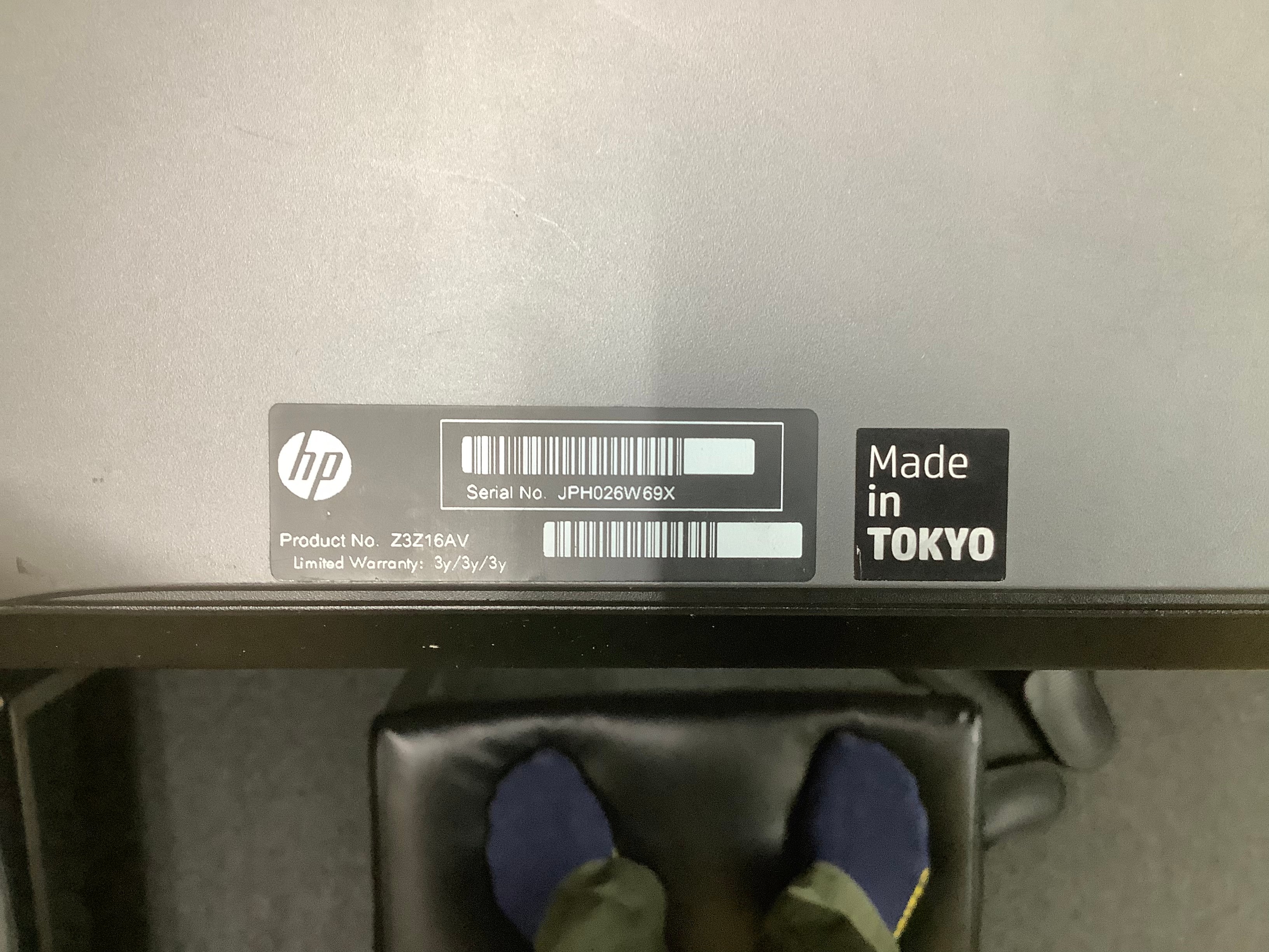

normal (working) other station
s/n: CZC932800T
SKU Number: Z3Z16AV
MAC1: c8:d9:d2:24:72:90
MAC2: c8:d9:d2:24:72:93
Do you mean revise info s/n ?

When the power supply is connected to the station, it immediately produces 5 long and 2 short signals (5 red and 2 white signals are duplicated on the LED).
This condition indicates that the embedded controller does not have valid firmware.
Can you fix this?
