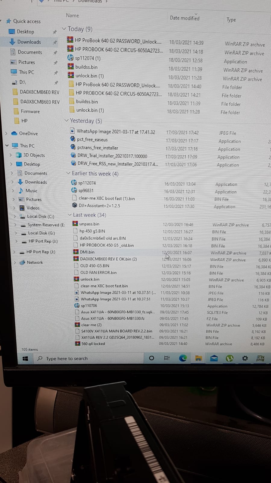

i use ok bin no power and fast boot one keep re booting old bacup one working but mpm error and very slow boot charging port no light
clear-me X8C boot fast.bin this one keep rebooting
i try to edit product information manual this 2 error not fix

Have just fixed and hp 450 g5 which had no power and i cleaned out a mosfet which had a short and now the unit is powering up . but now the pc has very slow bios response of upto 3min to start booting windows (no post delay) posts and displays in 3 to 5 seconds but will hold at hp logo for 3min before starting to load windows for about another 30 seconds . once in windows there are no symptoms of any nature until next reboot.
.i flashed bios with new Me file and no change .
i tried to boot into windows and update bios and it rebooted and took 45min installing bios but once done same thing.
entering the bios also takes 3min and navigating take more than a min to processes any key strokes.
i have tested the same file on other 450 g5 pcs with no problem .
i tried a different bios chip
any ideas what could cause this
