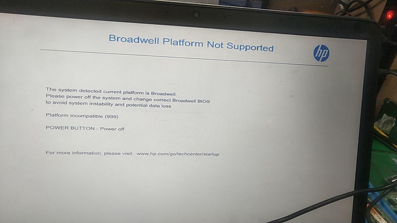

BIOS BID M74
M74 for gen 4th,
M73 for gen 5th Please use right bios
no display many problem, above have many BIOS upasss ok
No no no i just download unpass from THERE to another laptop while i was waiting for unpass in 840 g3 thread. My bad
New unpass works perfect, thanks again !
