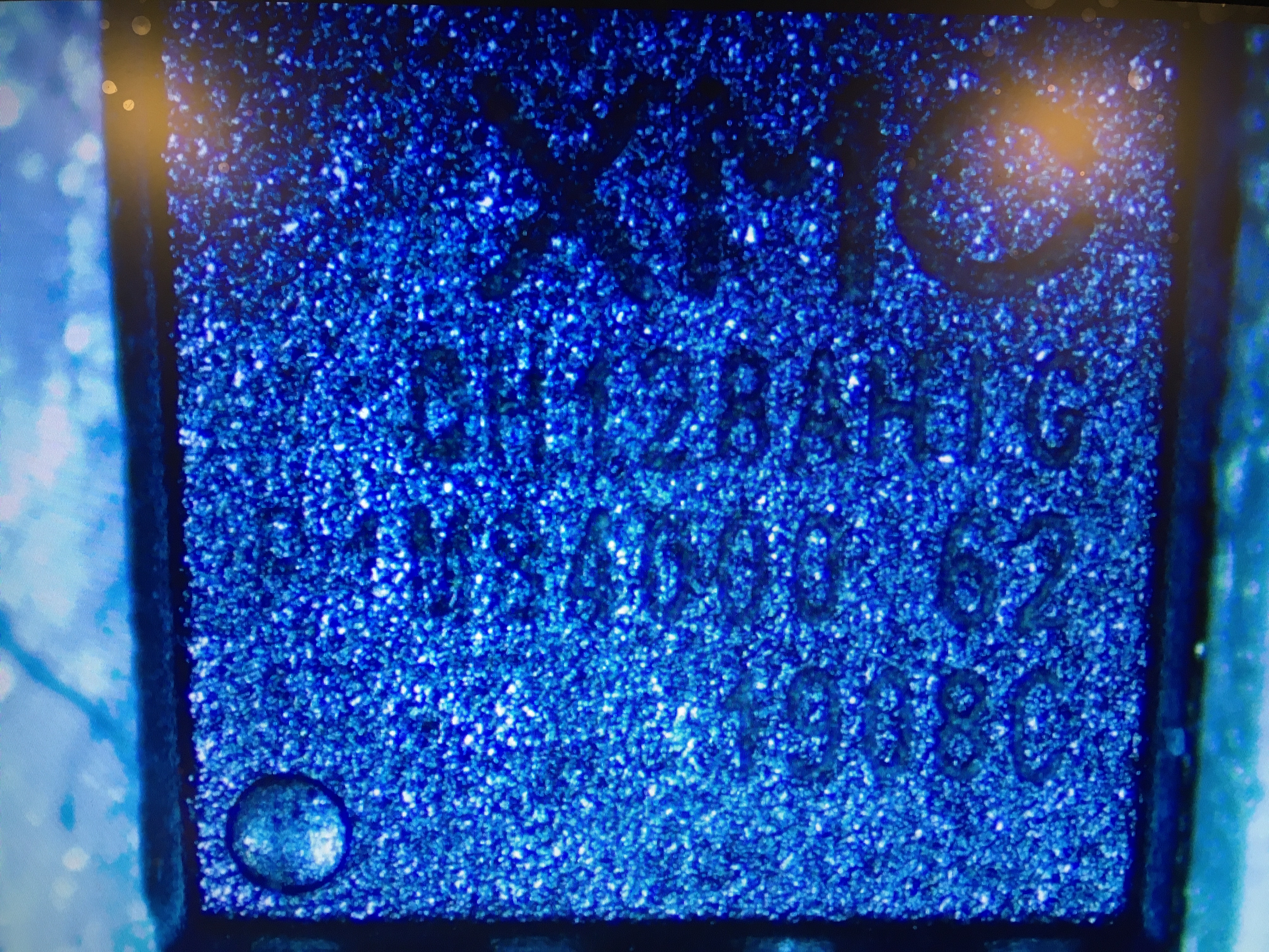

Hello ThienBui,
I have bios with 800000 file length. When programming your file programmings software gives notification that your file is to long. The programming succeeds, but motherboard doesn't boot. Powerled dc jack is on when plugging adapter.
So, after that I tried your EC OK bin and with that no powerled on dc jack when pluging adapter in.
What I noticed is that with your EC OK file all voltages are directly present, but with the old EC voltages are precent when laptop boot. Also wiht your EC OK file powerbutton does blink 6 times slow and after that constantly fast.
Are there different EC files?
I send bios and EC file. Can you check and rebuild?
Greetings Rob

because you don't know how to program
This model uses 16MB BIOS
chip 128 = 16MB
because you choose the wrong chip that's why you can only backup 8MB
Please go back to studying properly before starting to repair or you will kill the customer's computer.

Your UH2 is 16MB, and my UH2 is 8MB, but we are talking about the file length. I did programm UH2, and I told you that programming succeeds. So no problem with programming THE WRIGHT BIOS CHIP.......UH2.........CHIP TYPE: M25P64.
Check the file I send to you: la-h462p old UH2. You see that file starts the same as your UH2 file. My 8MB UH2 file also has DMI on 300000, and also has ME................
So, can you please go back and read properly, and try to help in a possitve way and don't try to kill the contact with you paying costumors.

BIOS 8mb not full data
send photo name chip BIOS I check
Looking at the chip name for example 64 or 128 is enough to know how many MB it uses in the BIOS
With EZP2010 it reads M25P64, and now I try with TL866 II, and it tells me the chip is XM25QH128A.
So I will check if programming with TL866 II solves problem
Problem solved with TL866 II.
The EZP2010 is not suitable for this chip.
