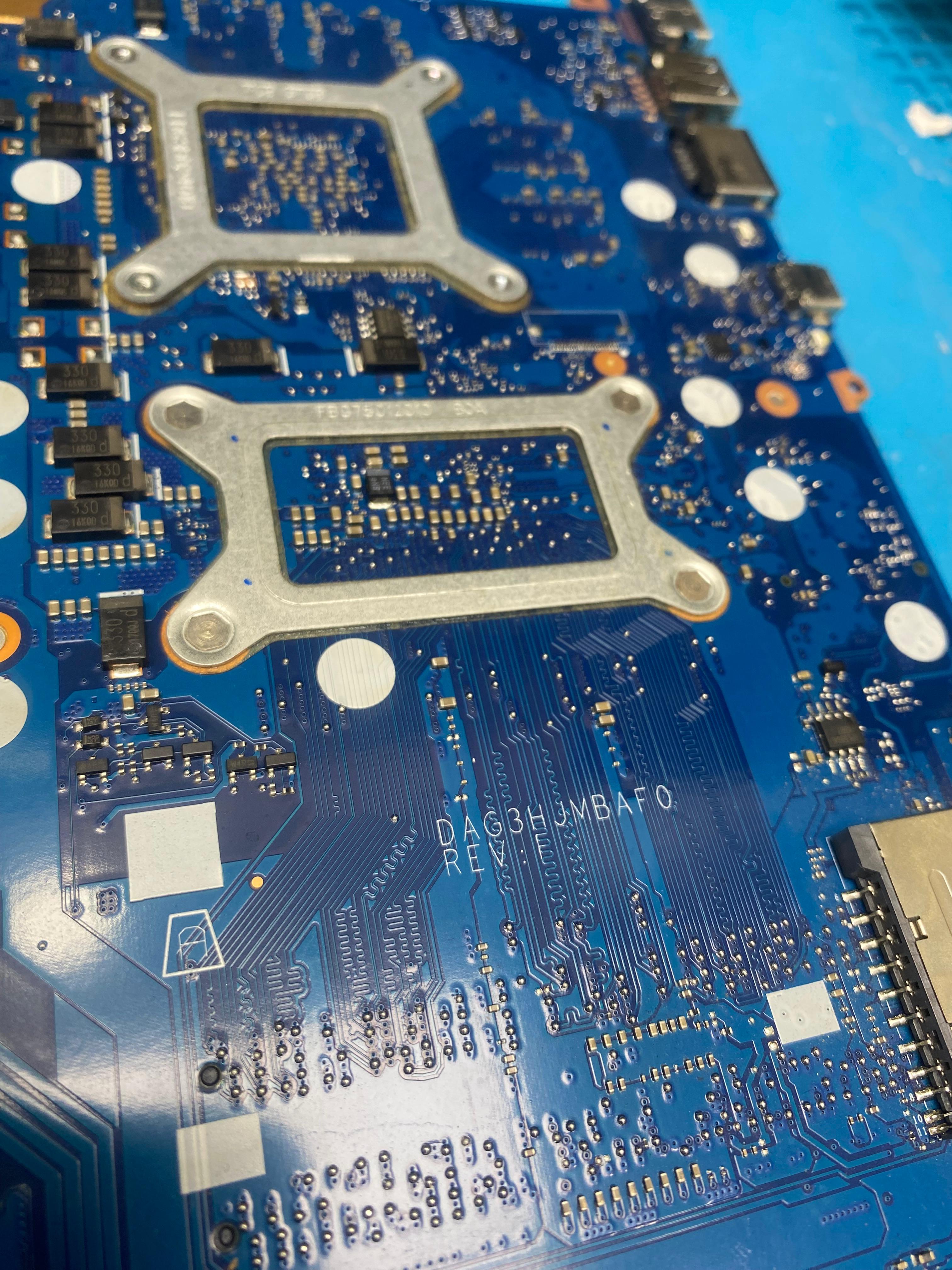

HP Pavilion 15.6 inch Gaming Laptop PC 15-ec2000 (2P6B5AV) DAG3HJMBAF0 BID 088DD_DMI AMD G3HJ
Ouanta G3HI KB pins=32 LEFT DOWN 1MM PDO=26 PD1=22 PD2=20 PD3=15 PD4=19 PD5=23 PD6=16 PD7=18 BUSY=29 STB=21 AFD= 32 INIT=25
SLIN=24 KSI4=28 KSI5=27 IT8987E-BYS

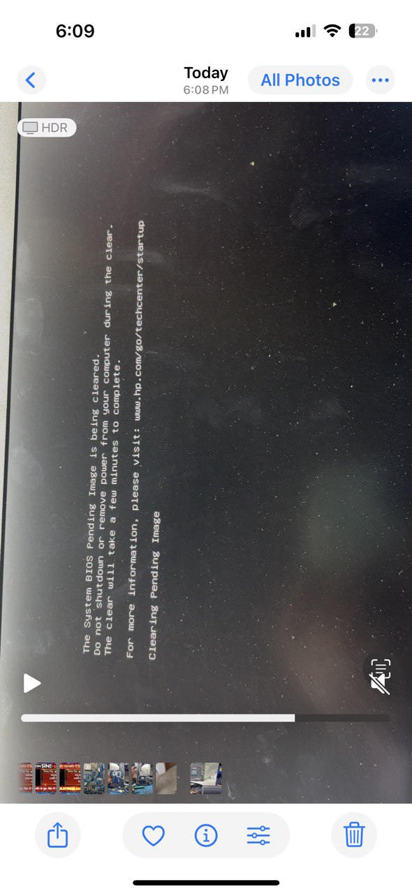

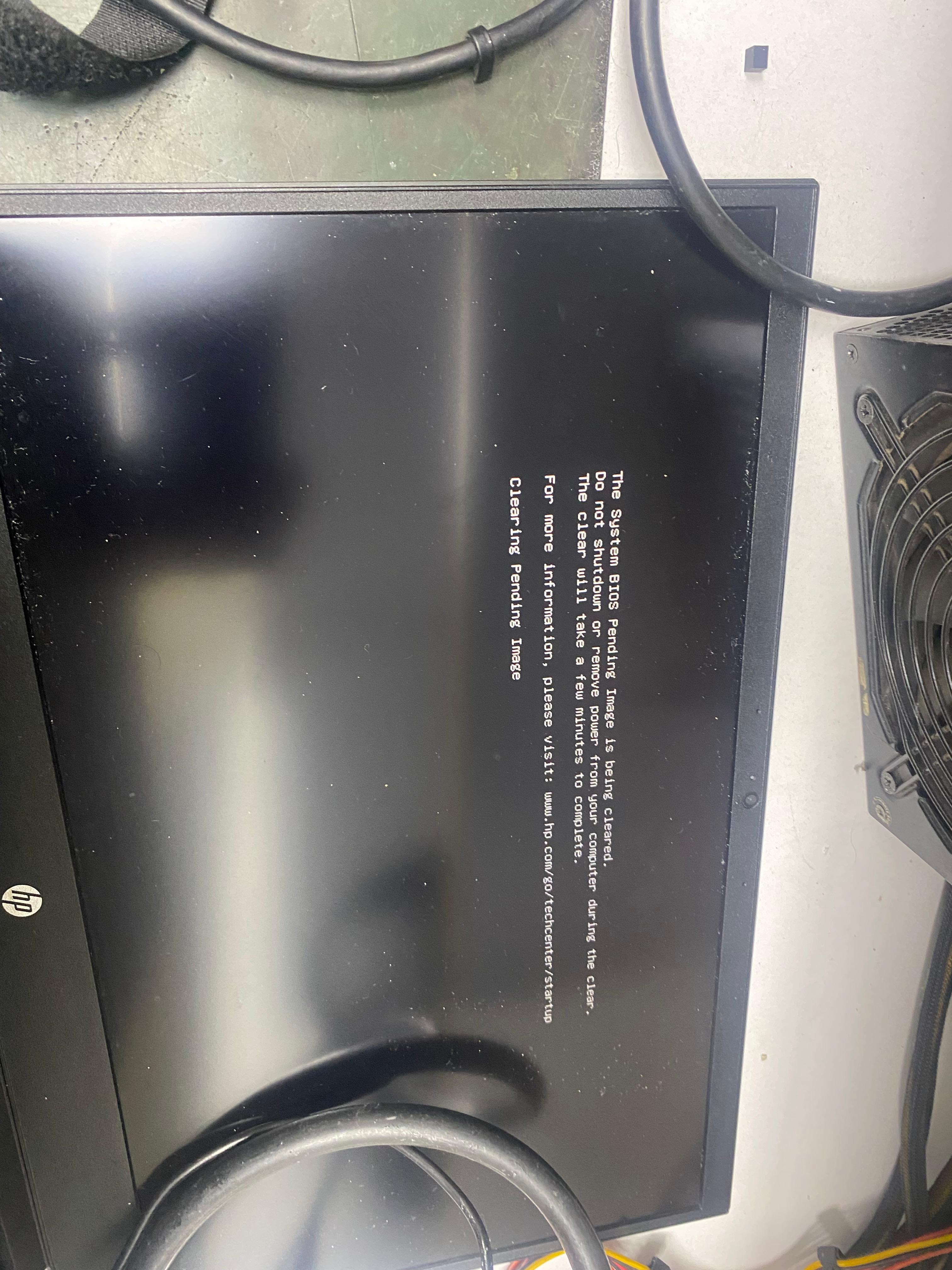

It does not give any image in its own bio. The attached bios is its own bio. When a different bios is written, it gives the image in the photo.
DAG3HJMBAF0 REV F
I have an issue where the laptop powers off immediately once the OS or installation USB starts to load, same with linux. its not the ram or anything else so I am wondering if it could be the BIOS or the EC?? it is a known issue, you can see on reddit there is a video as several people have the same problem :
