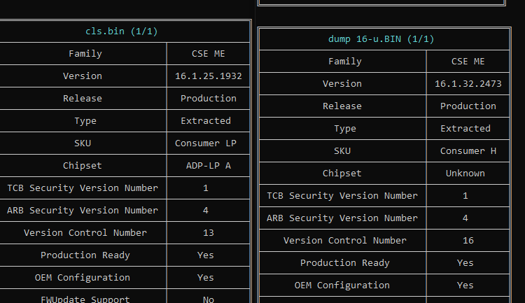

Hi I need help, I hope someone can help me.
Model: Omen 16 B0080TX
Board Code: DA0G3KMBCG0 REV:G
I have a hard time diagnosing because there is no schematics/boardview available yet, if you have, please share.
ISSUE
  • My personal laptop I used for my repairs. While in sleep mode it wont turn back on so I long press power button to turn "off" then press again to turn "on" and there the screen is black, no display
  • Charger is working
  • It has power, keyboard lights is on but CAPS LOCK light is not, looks like its freezing.
ACTION TAKEN
  • replace good ram
  • connected to external monitor HDMI
  • remove everything connected to motherboard and tried, still no display.
  • flash bios with clean ME and other working dump bios still no success.
