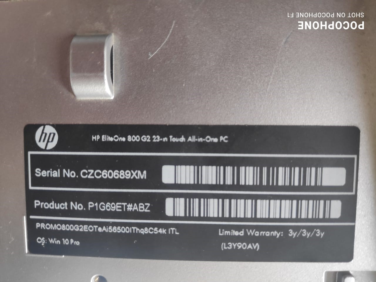

BIOS HP EliteOne 800 G2 23 6050A2716501
i need this bios
help me pliz
Solved is possible to write mac address original by simple procedure... dos boot , file eeupdate and 1 command with the original mac address printed on the sticker
Hi i have strange problem i can change the macaddres of nic ,after the flash because now i have 35 mainboard with the same mac address ....
~I use the version 221 for recovery all mainboard ... the issue is i have to do it another 100pcs and i wan to write the original nic ... i can edit on the bios ? because i try to found on winhex without result
Thanks in advance
