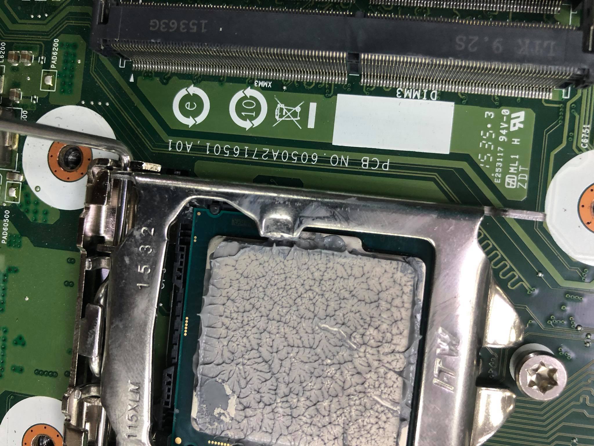

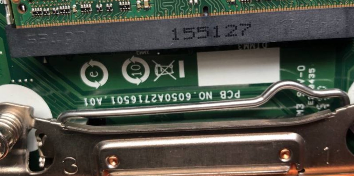

BIOS HP EliteOne 800 G2 23 6050A2716501
Want to clear me you must accept this error.
Or redefining what happened before and why you need to clear me?
actually I lost Orginal bios.
at that moment what should I do now?
I thought If Clear this bios maybe it will work.
so If u have any other solution please give me

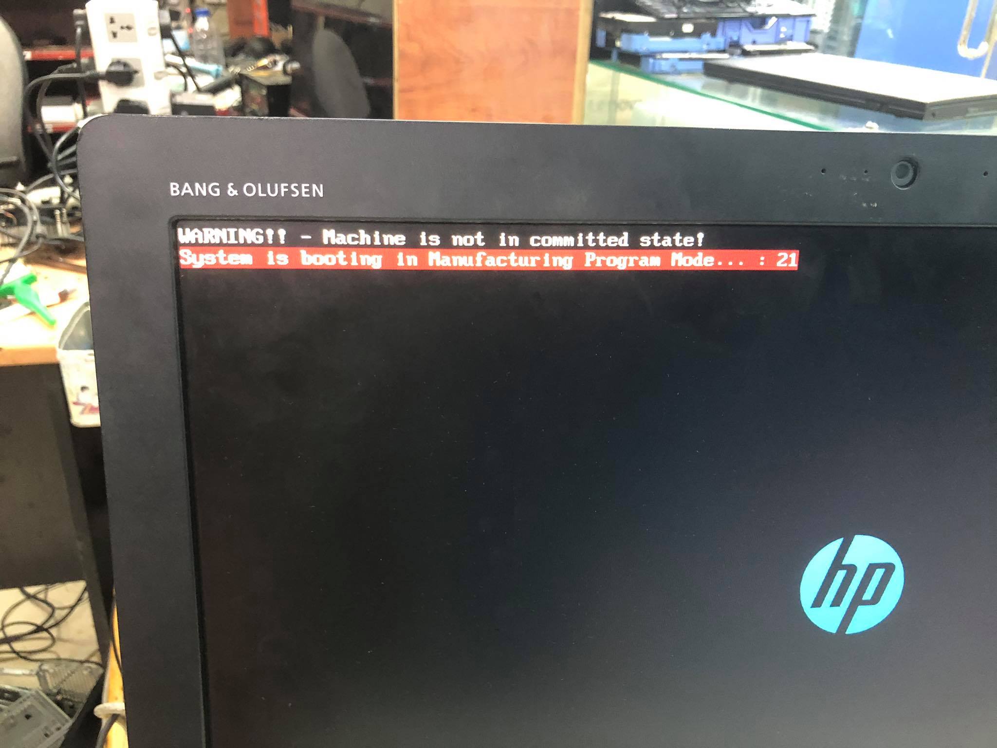

hi i fix 16 motherboard with the bios attached n11_0221 maybe i have problem with 5 motherboard the ec is corrupt , 8mb and when i write the bios give me 2 red beep end 3 blu short beep ,
The question is with the backup recovered by another motherboard of the 8mb chip not start ...
Possible to help me on this problem i attach 1 backup of 1 motherboard
8MB is not EC it only manages the device you keep it original no need for programming
i put backup from another in working condition maybe i have the same problem ... and i am sure the problem start from mistake program on this , other technician try to program both and the mainboard is not possible to recovery ...
on 21 pcs 5 is managed by another technician and 5 not recovered the other 16 is fixed by only program the 16mb bios with the file attached
