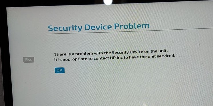

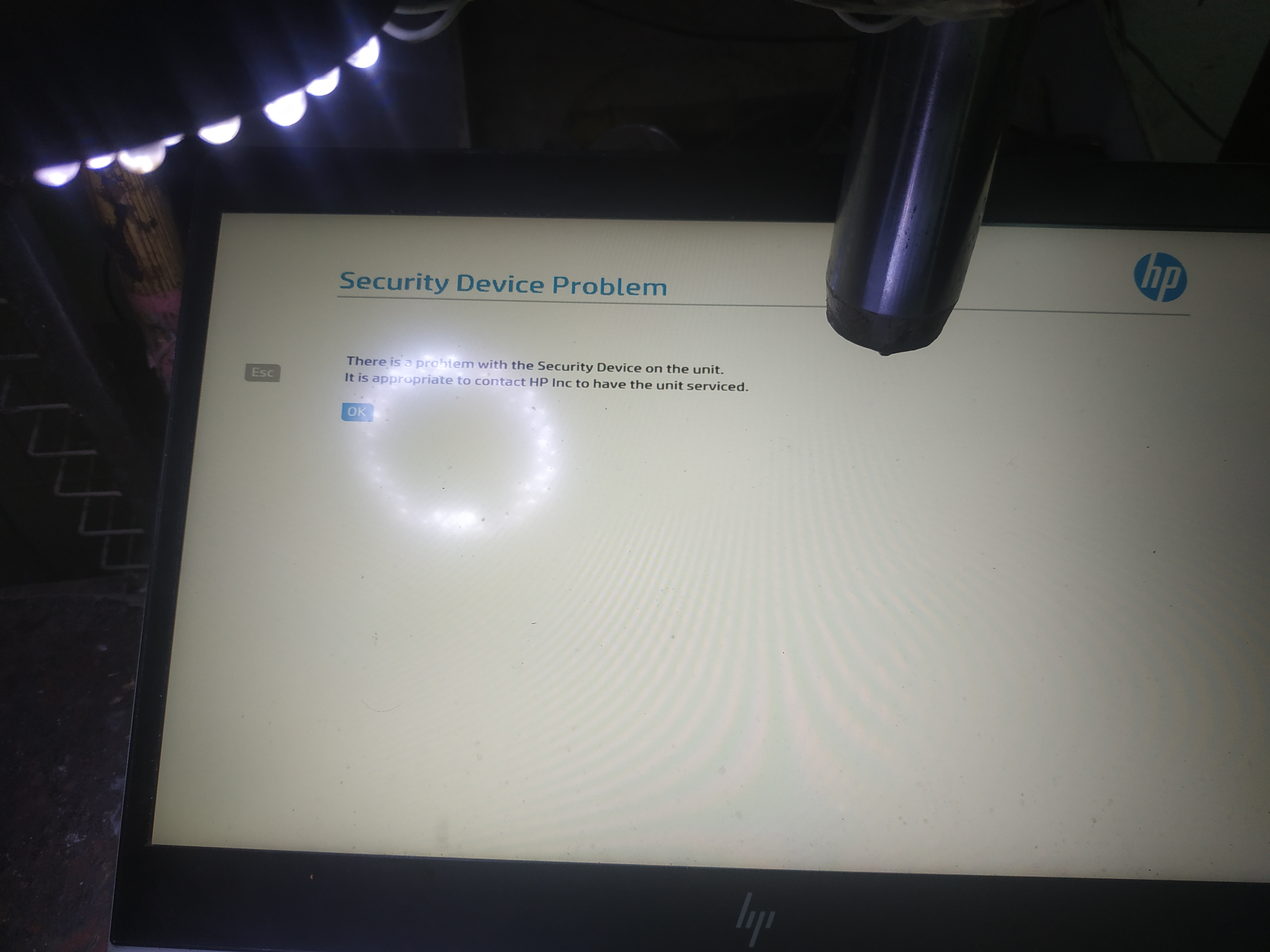

Hi,
Device HP EliteBook 840 G5, board COMPUTRO-6050A2945601-MB-A01(A1).
Flashed both chips with dumps from the first post on this thread. Don't have any backups.
Now everytime the device starts the Security Device Problem error message pop-ups. (really annoying), updated bios to the latest version and still nothing.
I hope you can help me with this issue.
Hi,
this is an error when you program the 16MB BIOS to get rid of this error, you need to return the original 16MB BIOS
