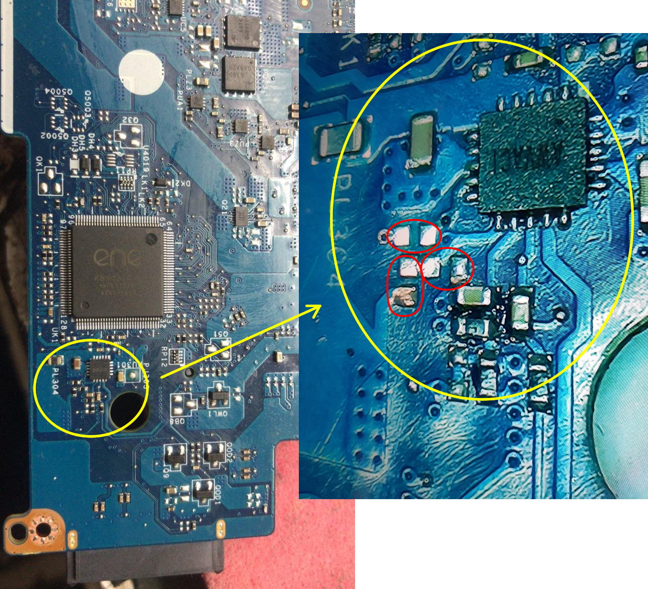

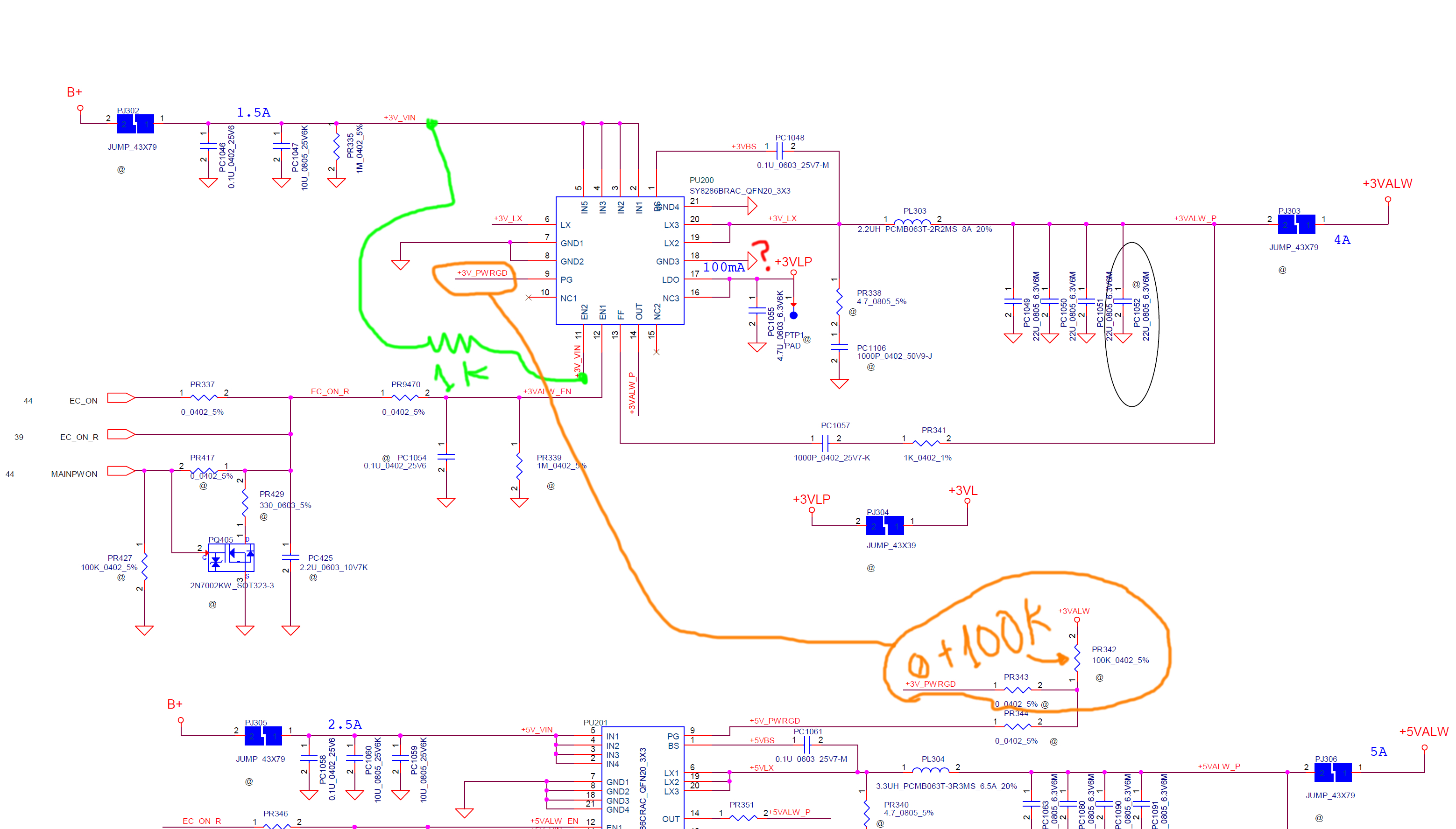

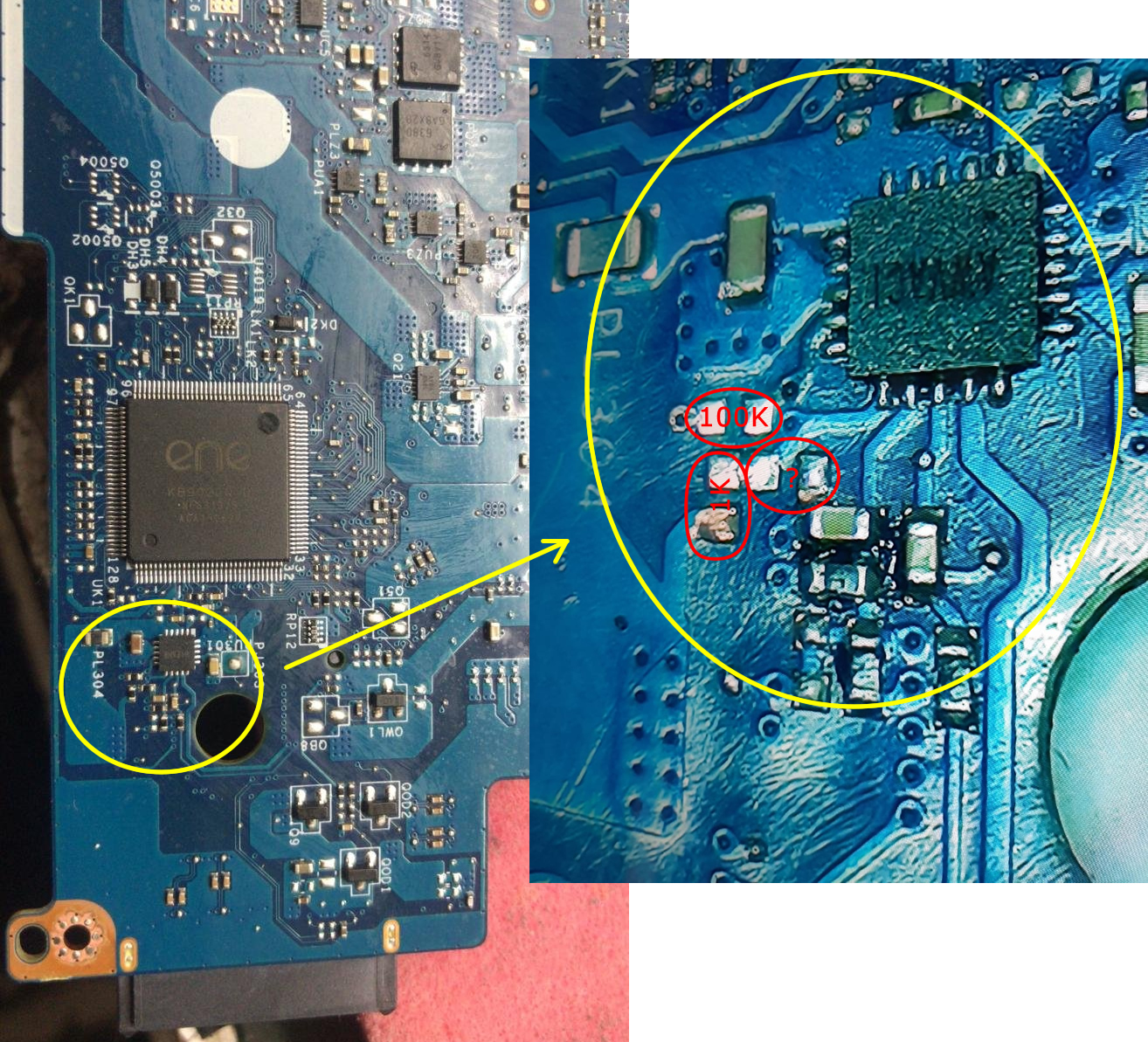

A plate with missing components arrived at the workshop, please I would like to know what are the values of these three components of integrated circuit PU301. Apparently it's a SY8286B
I put tentative values guiding myself from the diagram of the nm-a681.
100K
1K
the third is pending.
Turn on the laptop, but it doesn't show an image.
Sample 5.3 => The integrated controller ends the BIOS timeout.
I also rewrote KBC and SPI but the problem persists will it be due to the resistance that is still missing?

The same motherboard is needed for comparison
I was guided by a diagram, how he said it already works, now the mess is the video that is not shown. Will that resistance influence?
This board model has no diagram :(
