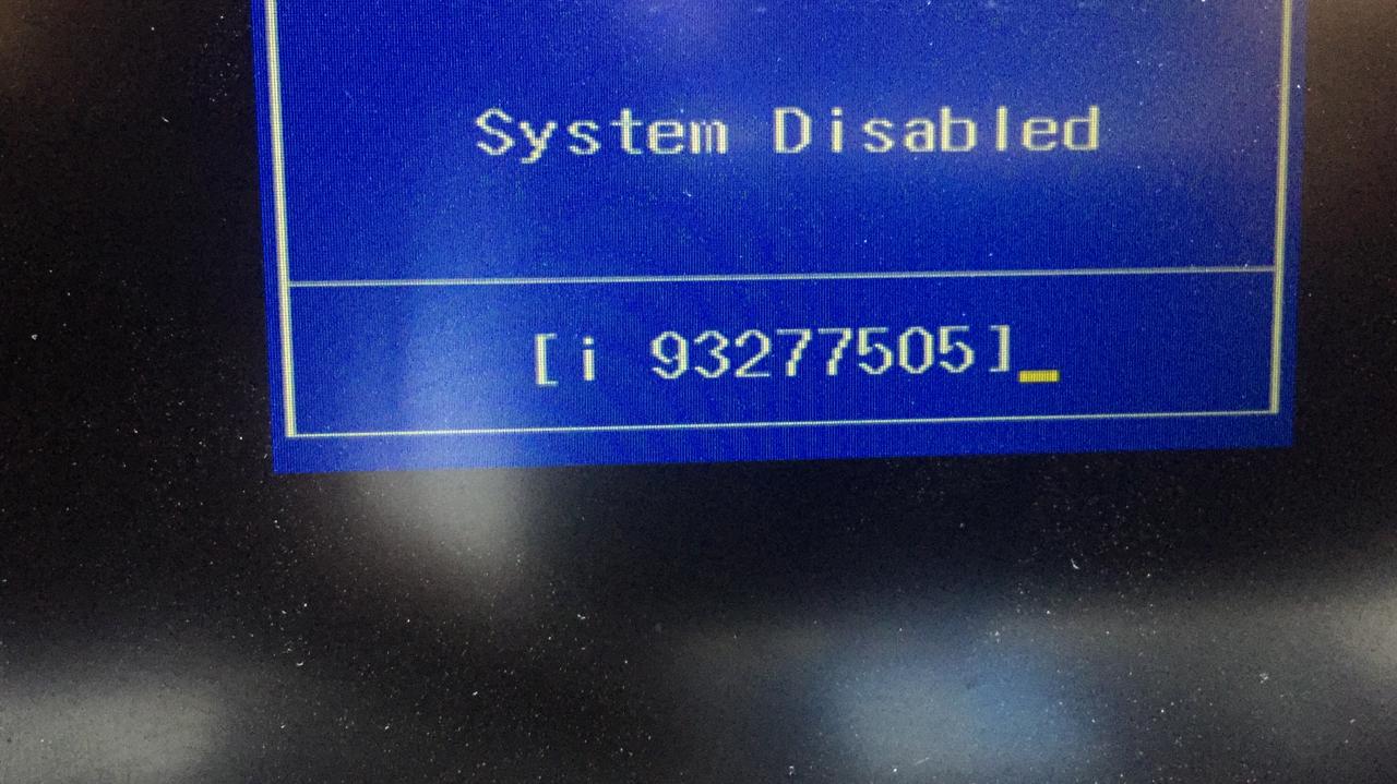

Hello,Please repair this bios.
Model laptop HP 15-CX0999na
Motheroard Model: DPK54 LA-F841P rev :1A
I've tried the bios that you have posted on the first page and that doesn't work for me.
I've even compare them and they are not quite the same.
