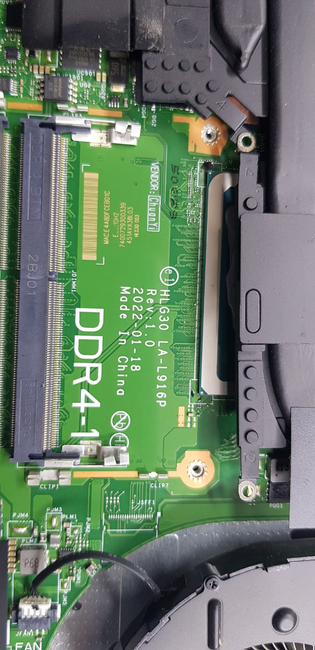

I entered the main and EC that you shared in your first message, and the display came up. However, it did not detect the NVMe and did not recognize the GPU (GPU: RTX 3050 Ti).

nvme, you must buy a $35 patch to fix it
and With the GPU, I'm not sure if it has to do with the bios

If disk detect but cant boot (show inaccessible boot device) and cant install system (no detect partitions) means bios problem? Original bios no display, on my dump display show but cant boot
it show disk and graphic in bios, but cannot boot. Tried on different disk and systems
Problema principal:
La pantalla no mostraba nada.
La reprogramé con la BIOS del fabricante y ahora sí muestra nada, pero la tarjeta gráfica no se activa. ¿Podrían ayudarme a solucionarlo?
Investigué y parece que se debe a un error de reparación de la BIOS.

right now is no display ?
