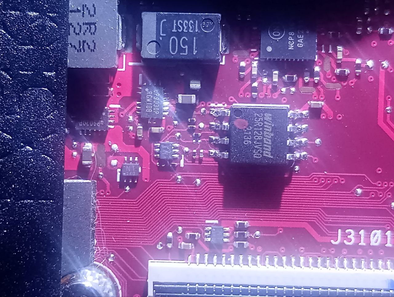

Hello I would like to know where specifically is the bios chip to send it now, I lost the password of my bios and I can not access the computer, I have an ezp2023+ to read the chip but I do not know where is the damned chip to pass the file.
I hope you will be able to help me

Are you a technician and don't know where the bios is?

It happens that the schematic says one thing, the bin says another and I'm looking for the nomenclature of the bin's winbond, not what the schematic says hahaha I'm still looking for the aforementioned chip.
Edit: I already know what the problem is, there are more versions of the FX516PC in addition to R 2.0 and 4.0, the one I have is 6.0 and the schematic does not match, can you give me a hand since I have 3 possible candidates and here I am without data, I have technical knowledge but I have not worked with bios files in this way.
Serial Chips:
Winbond:
25Q16JWNIQ
25R128JVS0
25Q80DVNIG
I don't know if it requires a voltage converter to read them and facilitate them. I'm really new to this
