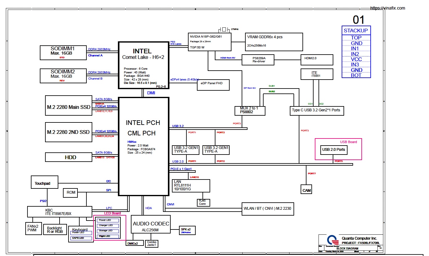

BIOS FX506LI DABKXDMB8E0 ( ASUS FX506L DABKXDMB8F0 REV F photo )
( ASUS FX506L DABKXDMB8F0 REV F photo )ASUS FX506L-FX706L - DABKXDMB8E0-BKXD.jpg,DABKXDMB8E0
BIOS bkxd
ASUS FX506L-FX706L - DABKXDMB8E0-BKXD.pdf
ASUS FX506LI - FX506LH - FX706LI BKX BoardView.pdf
