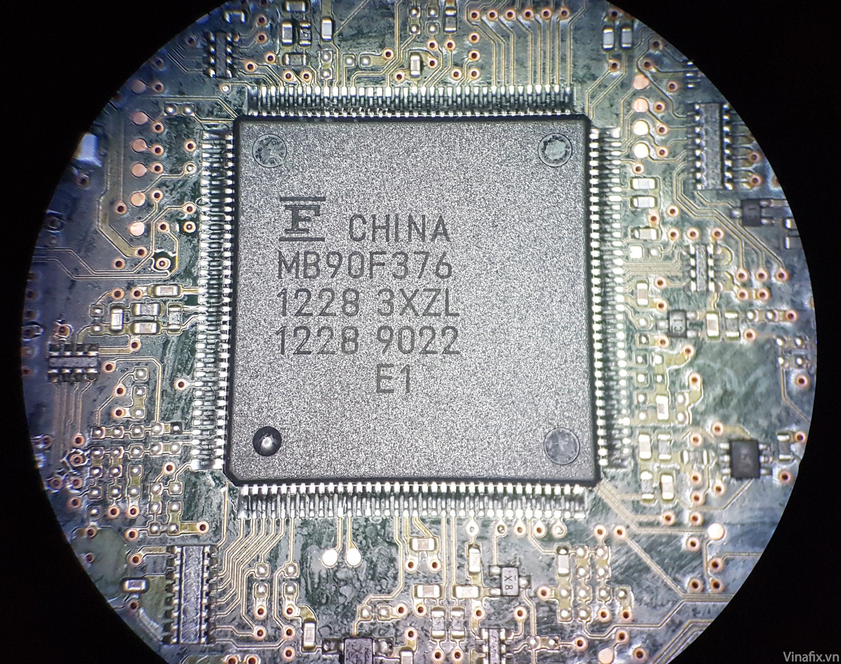

Change KBC.
Change KBC.
Today I just replaced KBC MB90F376 with a new one. I uploaded 3 bios file from this forum. The administrator password is still required. It looks like the password is sewn into the memory of the bios. Is any solution available?
I waited three weeks, if the seller from China does not lie, kbc was new. There were no traces of soldering and in my opinion it looked new. This kbc is programmed or have external memory eprom only? If have external memory eprom only so maybe password is in 25Q64 or 25Q32 chip?
Ok. I just unlocked bios password in my Fujitsu Celsius H730. KBC's MB90F376 replacement did not help anything. The saved bios checksum is in the W25Q64 memory.
