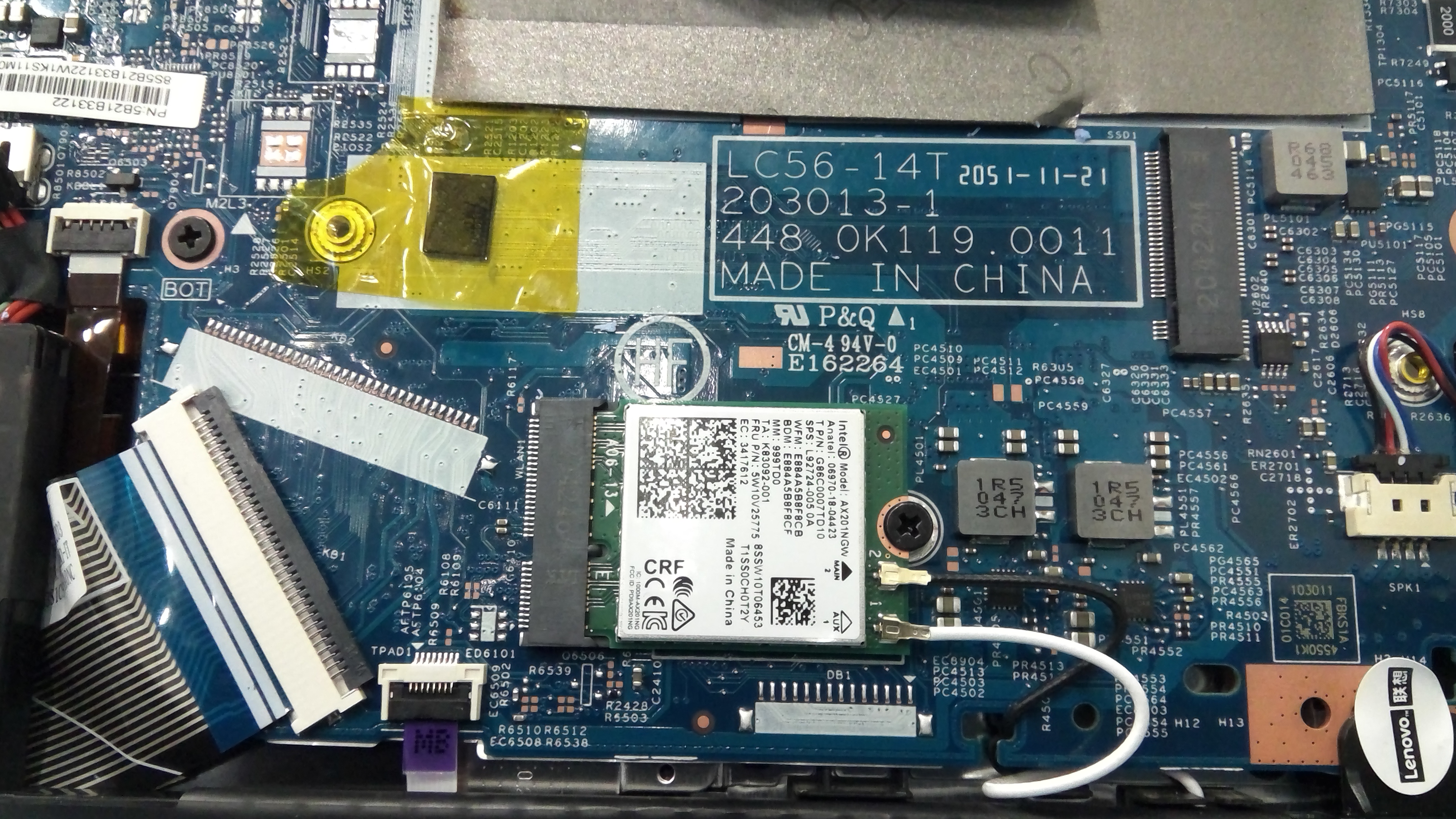

Flex 5-15IIL05 Laptop (ideapad) - Type 81X3 LC55-15C 19792-1
file builds I send is Extract form bios exe like you send :)
You can't repair your computer if you just ask for luck from the BIOS
On builds5667.bin, the rotation works but the start is 30 seconds. On clearmes, the launch is normal but rotation does not work. :(
I tested clearmes.bin on a second similar laptop Flex 5 14IIL LC55-15C 19792-1 which also did not turn on. The problem was in the bios. Rotation also does not work after flashing.
I not Understand problem, Please make one video I check
Need BIOS for Flex 5-14ITL. Heve two laptops There are two laptops that need bios. I sent dumps from them. Both have a black screen when turned on and CAPS is on
for Orig Dump К910УВЗТ
When I get an ok response I will help but I think you can use the same if you have the same model
buildsss.bin 2.zip
Thanks! К910УВЗТ works :), but on the second "PF1EG700" turn on 20 seconds and does not see the SSD :(
