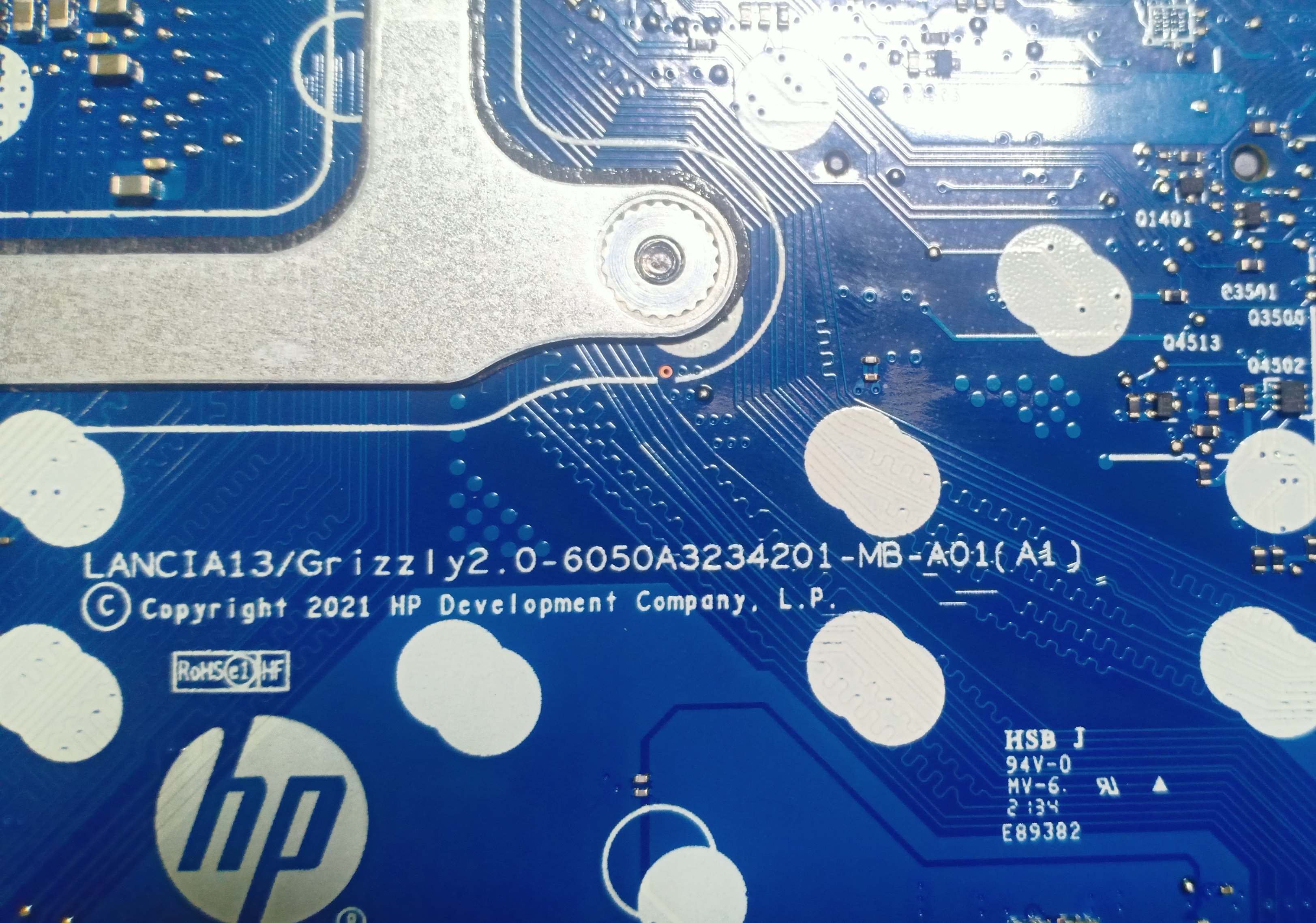

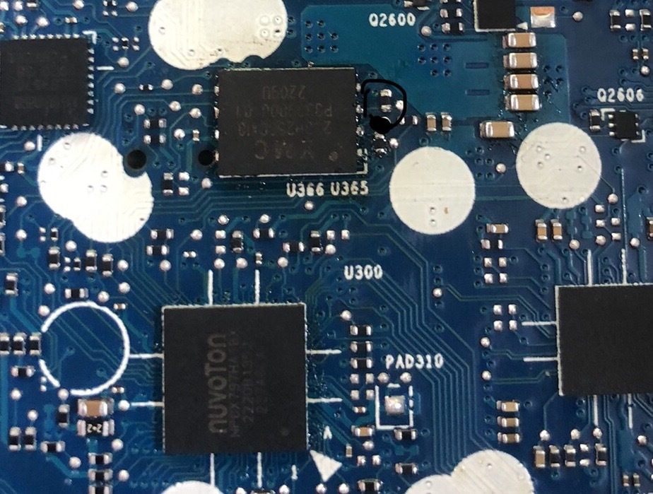

Hello, the laptop starts to turn on and soon turns off and caps locks lights up, it seems that they tried to remove the code and the resistor on the third leg flew. I can't figure out how many ohms of resistance to put on it, please help me. The current flows through the other side, not so much. I put 0.33 ohms, it didn't turn on at all, 3.3 ohms, it worked but still turned off, Maybe someone has a schematic or a meter and can measure how much this resistance should be. Thanks.
motherboard : 835 g8 6050a3234201-mb-a01 please help me ,
The battery is not charging either, as far as I know, after the BIOS was removed incorrectly. Maybe you can help me. I think part of it has flown away. I only have the old BIOS, the original U366, the other one is clearly lost. The laptop will boot up and then the light on the charger will not light up at all. Enters Windows and turns capslock on and off Help me Please
so you need to check the hardwareI programmed it but it's exactly the same.
I think there are no resistors around. I need a picture, maybe someone has one. Help me pleaseI programmed it but it's exactly the same.
Most motherboards have 33 ohm resistor on bios data lines. Try 33ohm not 3.3ohm asus uses 15ohms resistor so you can try 15ohms also#11
