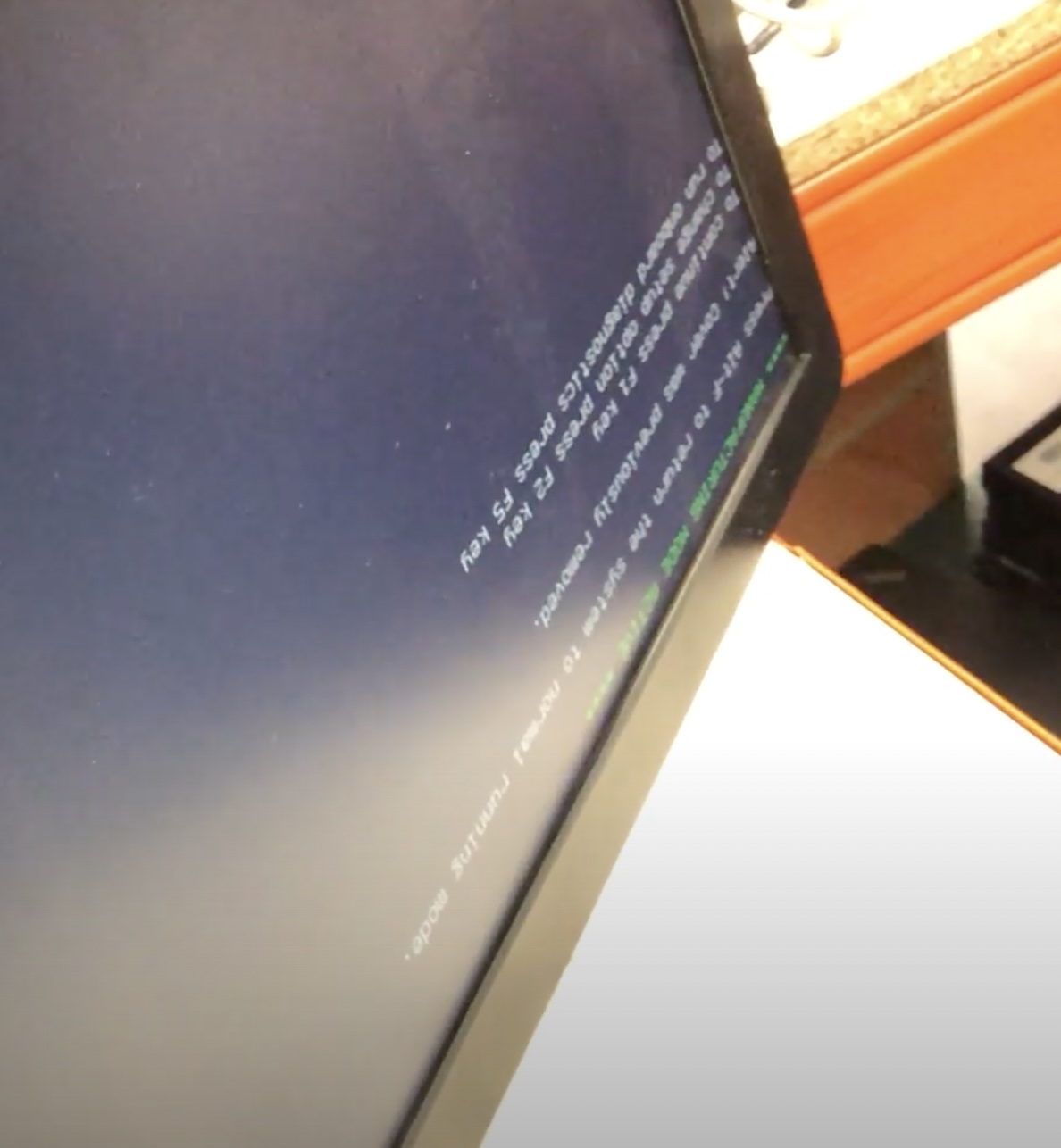

this is the reason for the delay
you need to follow the instructions Alt+F…..to exit production mode
all bios above have same problem ?
it does not start on any other, can i try to reprogram both memories? 4mb and 8 mb, now and flash only 8 mb and fan full speed I try reprogram again in the morning and let me know if it helped
You need to flash both chips bro, in fact they contain one bios ( just splitted and put in 2 chips )

SO I found another bios on the site, it starts immediately but lan does not work, sees it in the device manager, but does not detect the connection, may it also be due to a faulty bios? or is it more to blame in the hardware on the motherboard? I think it may be a hardware fault, but I prefer to ask
