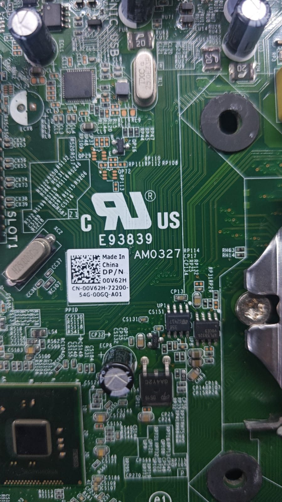

I tested your "clss98.zip" file on a Dell OptiPlex 9020 SFF motherboard (DP/N: 00V62H), but it triggers a solid diagnostic error code: 2 amber blinks, a short pause, and 3 amber blinks (2,3 Memory/Motherboard initialization failure).
As I mentioned before, my original backup dumps (SPI-1 and SPI-2) came from a 100% operational motherboard. The issue lies within the modified ME region setup in your file.
Could you please rebuild the BIOS file from my original dumps? Please ensure the Intel ME region is cleanly initialized as a "Master" file so it can be deployed on other identical 00V62H boards, and please include your known network/MAC fix to prevent any onboard LAN drops.
