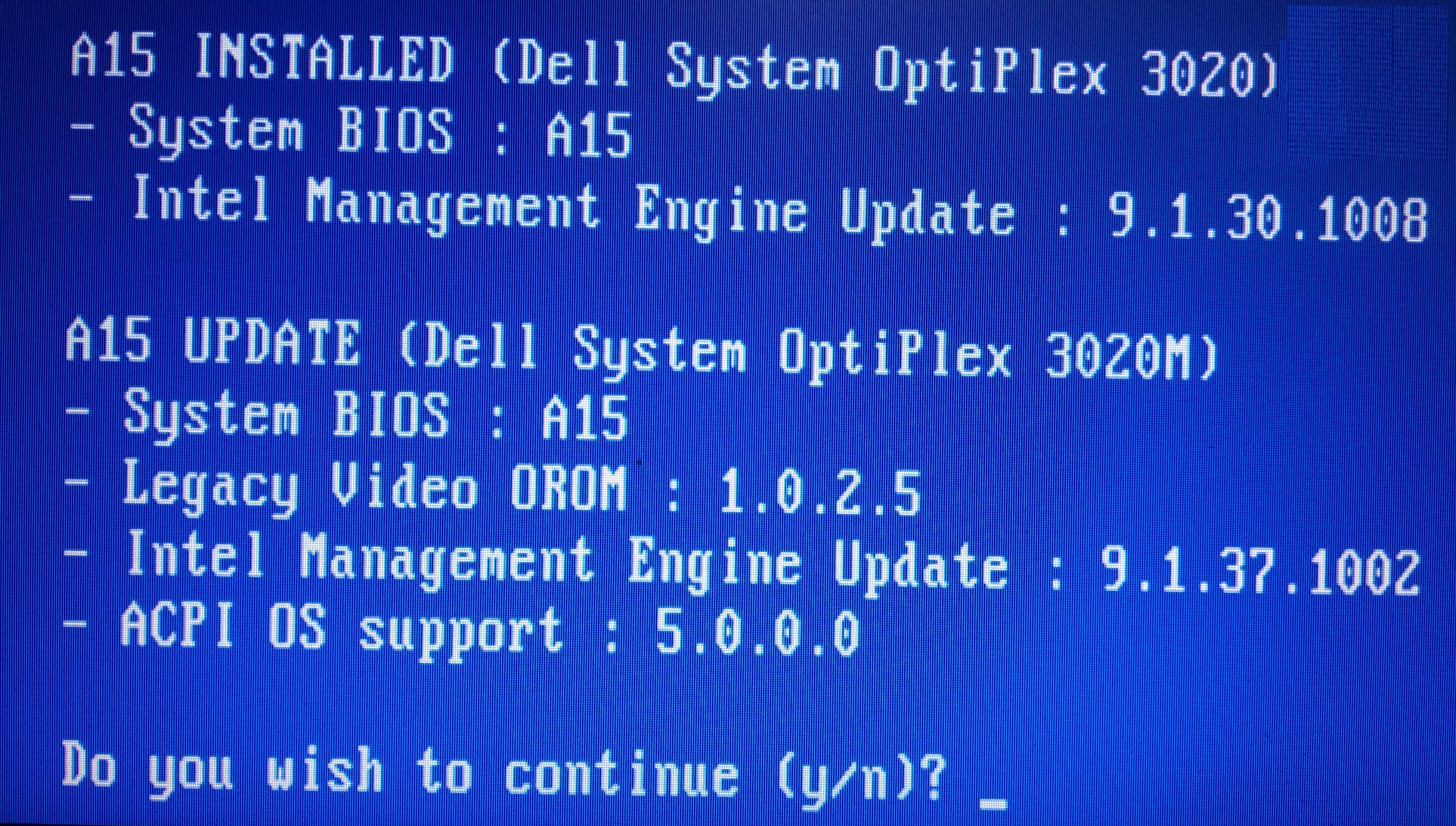

bought cpu with wrong bios (arrived with bios for 3020 desktop) , i am trying restore the correct bios, in fact with the wrong bios almost works except ethernet and some alerts but boot still boot
You mean no old BIOS backups
already tried clear me 25L64 (mine is 25L6473e by the way), same thing, please check attached image when try update bios with official utility (of course fails)
edit: not same bios running (up) 3020 rev A15 i want 3020M rev a15 (note missing m)

1.- received computer with wrong bios (3020 desktop), then i tried fix flashing extracted bios.bin and then (i killed it) black screen
2.- with a ch341a programmer flash this rom: https://vinafix.com/attachments/optiplex-3020m-a15-bin-zip.108074/ of here and not works, system power on but without video.
3.- Download 3020 A15 rom from anywhere (for tower model) flash it and works partially; system boots, but missing ethernet, and several errors or alerts at startup.
4.- Tried update or flash the correct bios version with official utility but is not possible because says "this rom is for different model"
5.- I want only flash the adequate rom for my computer DELL 3020M Micro, thanks

You do not need to care about the ultimate purpose version is the working PC
1. Not working PC, for that i paid you for support.
2. The ROM https://vinafix.com/attachments/optiplex-3020m-a15-bin-zip.108074/ is NOT full A15 version because Intel Me version is 9.1.0.1120 while the A15 version (from DELL) have 9.1.37.1002
3. Ethernet device not was working because ME version; with UEFITool extract Me 9.1.37.1002 region from A15 bios and replace in the 3020 Desktop bios (without M), flashed it with flashrom and now ethernet is FIXED.
no problem 3020 or 3020m only need it same motherboard code.
NO, almost same code therefore there is a different bios for each.
