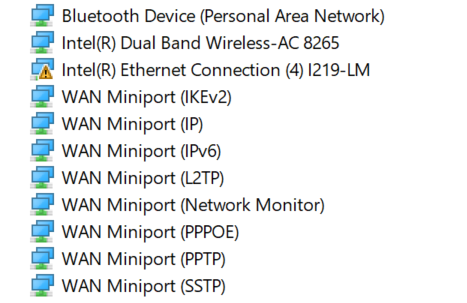

after clear ME problem was still the same, laptop was working, but cant install LAN driver
after that we tried BIOS from other E7480 without changing ME Region, just original BIOS from other laptop, same model and LAN was working fine, but laptop needs 30 seconds more to boot. We need working LAN and normal speed of booting. Can you help?

Latitude 7480 CAZ20 LA-E132P BIOS 25Q128FV BF
makes the LAN card detected correctly but appears BSOD:
whea uncorrectable error
however, when the bios is uploaded:
GD25Q128B@WSON8_20210107_83606
there is no problem with the bsod, but the network card is no longer detected (LAN)

Please make note of the BIOS file you want to fix
I sent the screenshot before.
Error code 10 appears in the card properties
