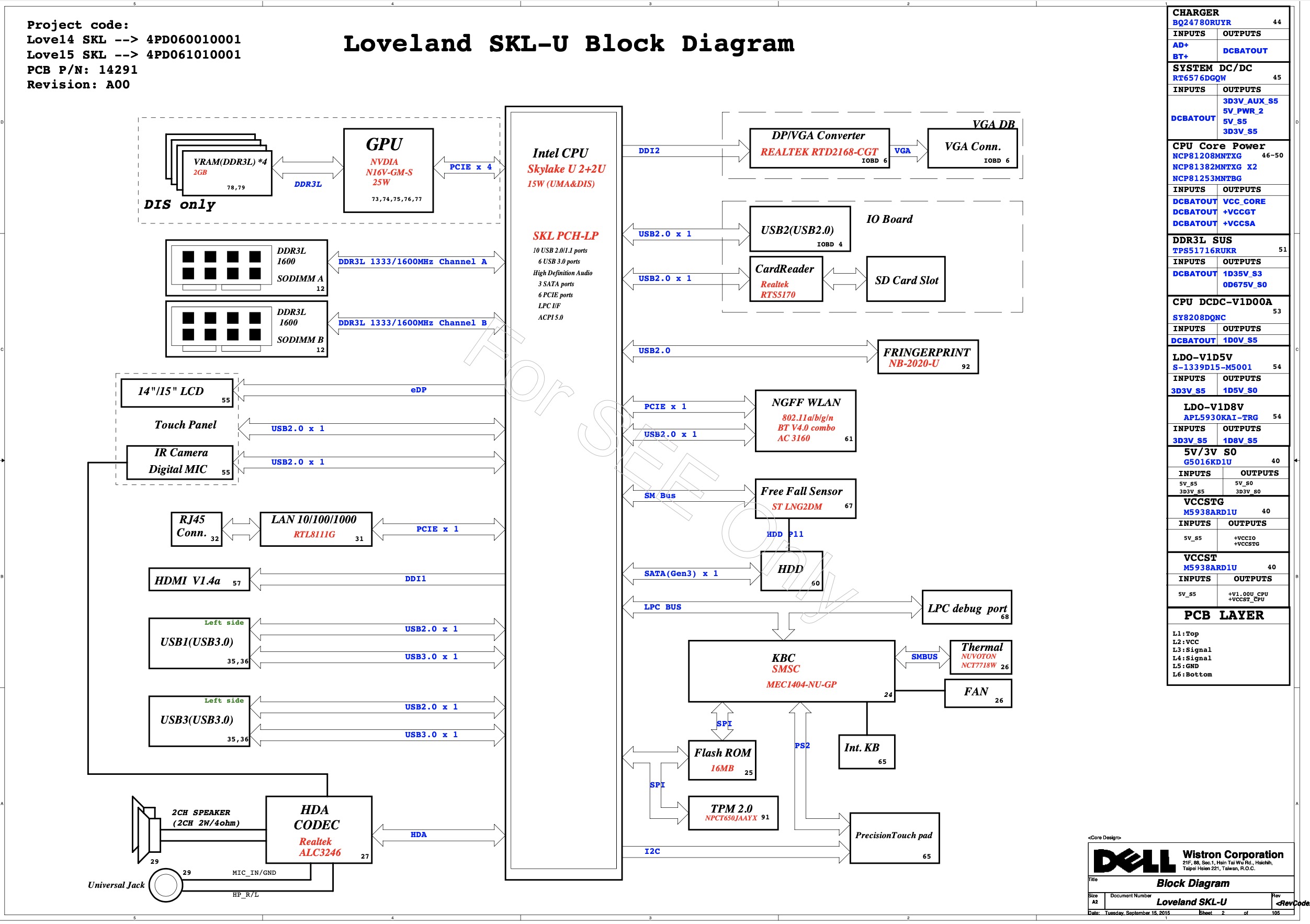

Dell Latitude 3470 LOVELAND SKL MB 14291-1 PWB:51VP4
Dell Latitude 3470
LOVELAND SKL MB 14291-1 PWB:51VP4 REV:A00

I thought so too but on my BIOS where there is no image I hear that the hard drive is working on the new BIOS where there is an image the hard drive does not spin does not work
HDD sata or SSD NVME ?
If you're a technician, you need to know what's going on, you can't listen to what someone is saying
