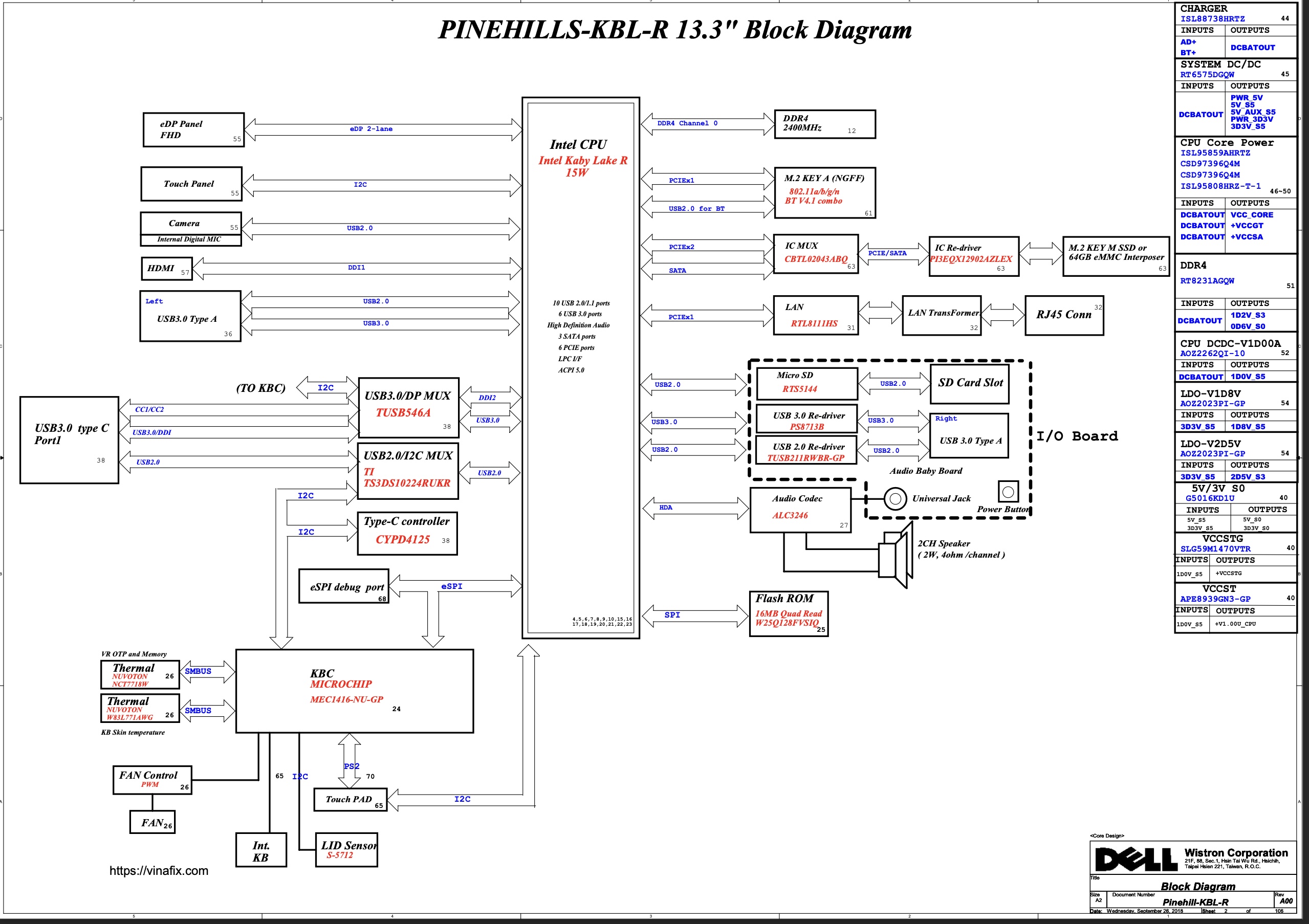

Wistron Pinehill 13.3 KBL-R 17910.pdf

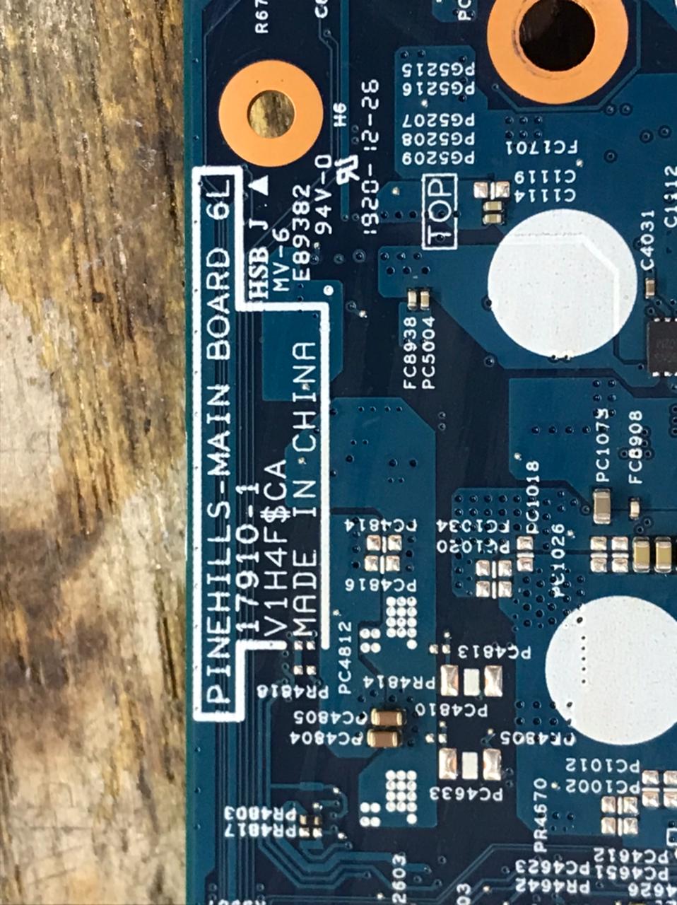

it's not a clearme problem you need to try a new BIOS to compare first.please clear working ok but after 10 mintes hang

I need body view
