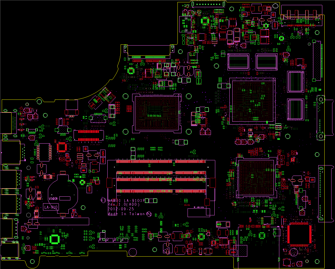

Hi i need bios for mla-9104p rev 1.0 UMA CPU
SR109 (Intel Celeron 1007U)​
i writing some bios but 5 beep alwayse
On dell laptops 5 beeps error is due to bad bios cell (CMOS Cell) replace it after on it gives 5 beeps first go into bios setup adjust date and time and restart
This is true . 5 beep for dell means bad cmos but laptop have display and beep code . my laptop dose not have display
