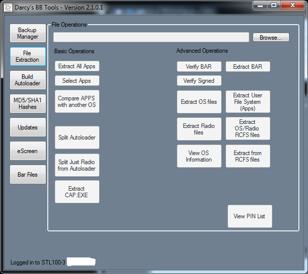

Main Features
Screenshots

Downloads
- Sideload (install) Bar files - does not require development mode
- All the file extraction from autoloaders
- Detects if an OS is for OMAP (STL100-1), qc8960 (Z10, Z30, Q10, etc) or qc8974 (Passport only at this time)
- Extract specific apps only
- Compare loaders/blitz packages and extract changed apps
- Split Autoloaders
- Build Autoloaders - directly from BAR files that contain the signed files if they're available
- Search for Updates and Software Release Versions.
- Option to auto-install when downloading update files
- eScreen Code generation
- Delete apps from the phone
- Lists of apps to ignore/delete for automation purposes
- Can talk to multiple phones
