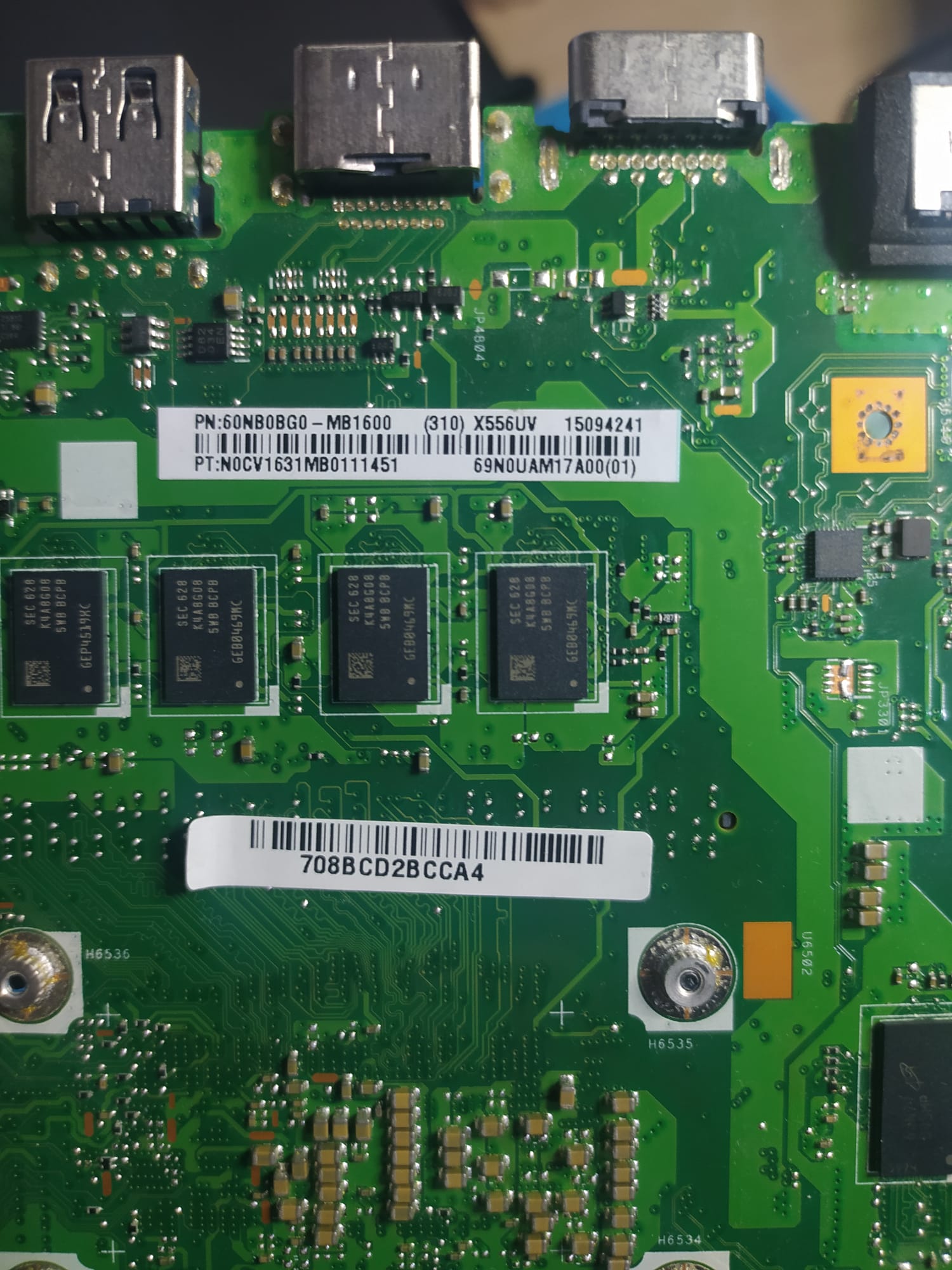

Hello, whit the BIOS original and whit the clear BIOS the laptop don't do anything, but whit BIOS x556uv i7 7th, it turns on but no have backligth, my laptop is i7 6th and GPU 920MX.
What else can I do?

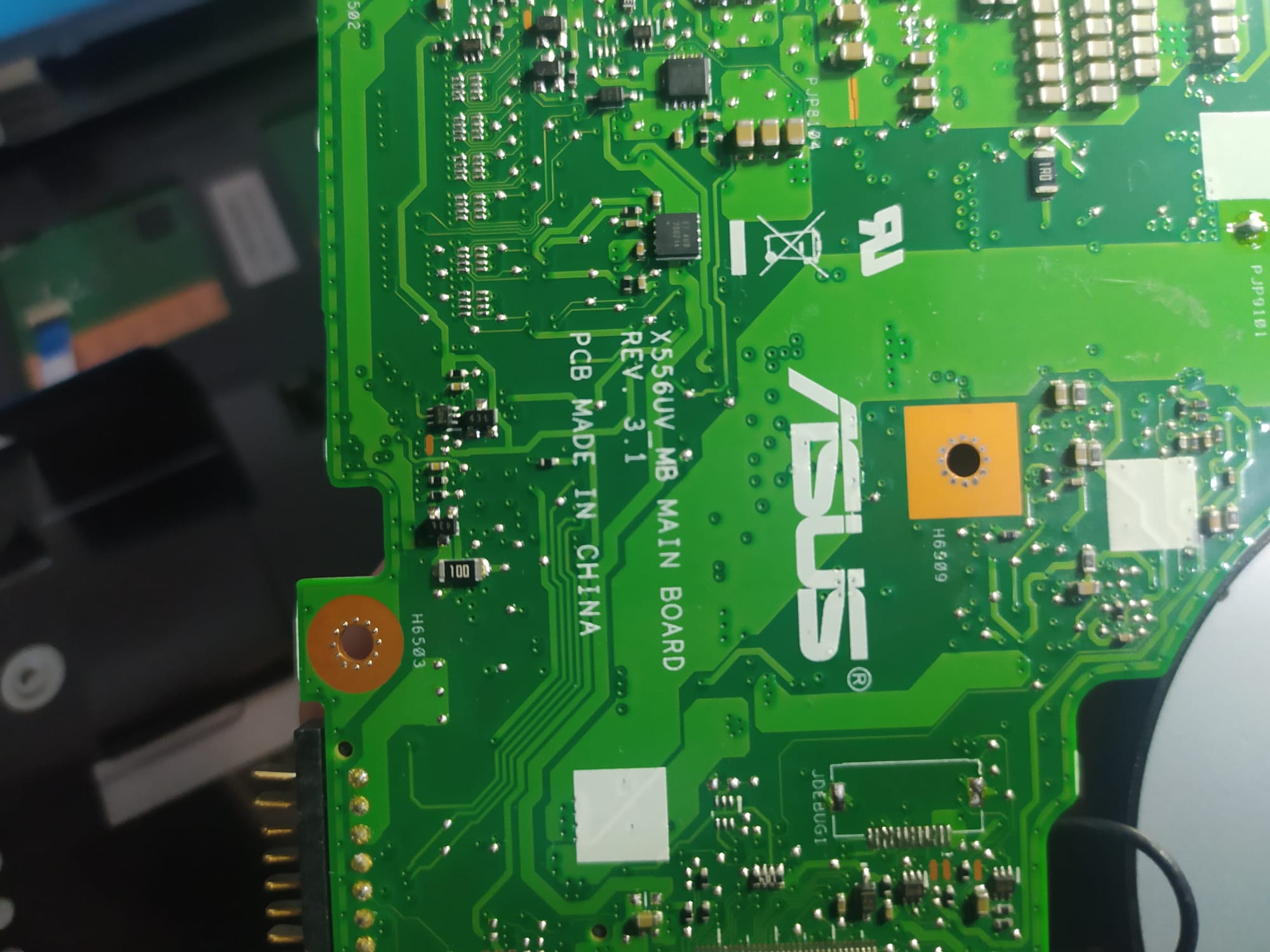

Hi again, this is my motherboard, with i7 6th and GPU 920MX, could you provide me a BIOS with a nice screen's brightness?
WhatsApp Image 2022-01-21 at 10.38.32.jpeg WhatsApp Image 2022-01-21 at 10.38.33.jpeg

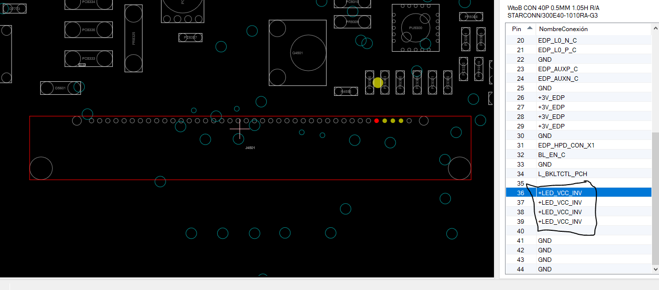

The same problem, the scren´s not brightness.... I think it isn´t a software problem. What should I check at the hardware level? The laptop enters windows 10 perfectly but does not show brightness
have there been any changes or fixes before?
Pay attention to the GPU
I'm not the first technician to try to fix it, it´s come me with a bad BIOS and now have the correct file. But the brightness glitch persists.
I just checked the Led_vcc_inv and it gives 19V, it seems correct.
For the backlight is there any enable signal that I should look at?
