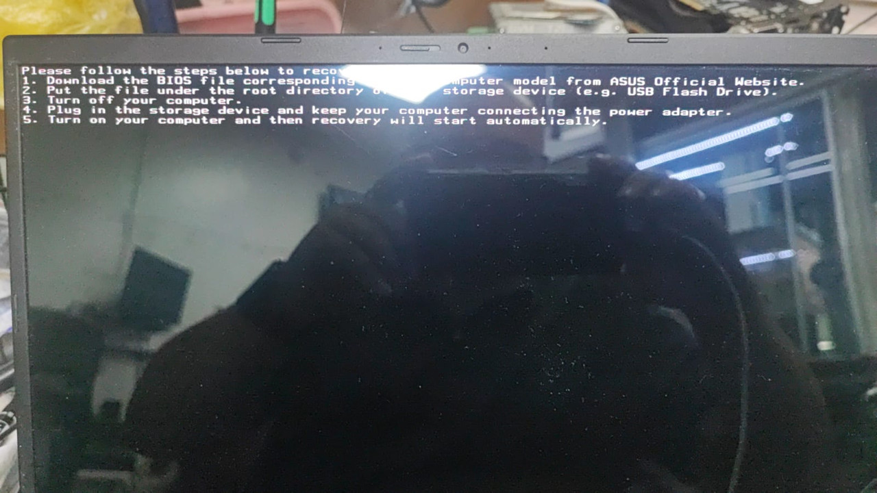

Hello.
Is it possible to repair the BIOS of my asus_vivobook_pro_14_OLED?
CPU:Ryzen9_5900HX
sn:MBN0CX321708476
Symptoms: Power ON → Charging LED on → Battery LED (1 blink → Off → 1 blink → Off...) → Nothing is displayed on the screen
When you write the BIOS uploaded here, the BIOS may be displayed several times. The situation is unstable.
I don't know if the BIOS is bad or if it's a hardware issue.
thank you.

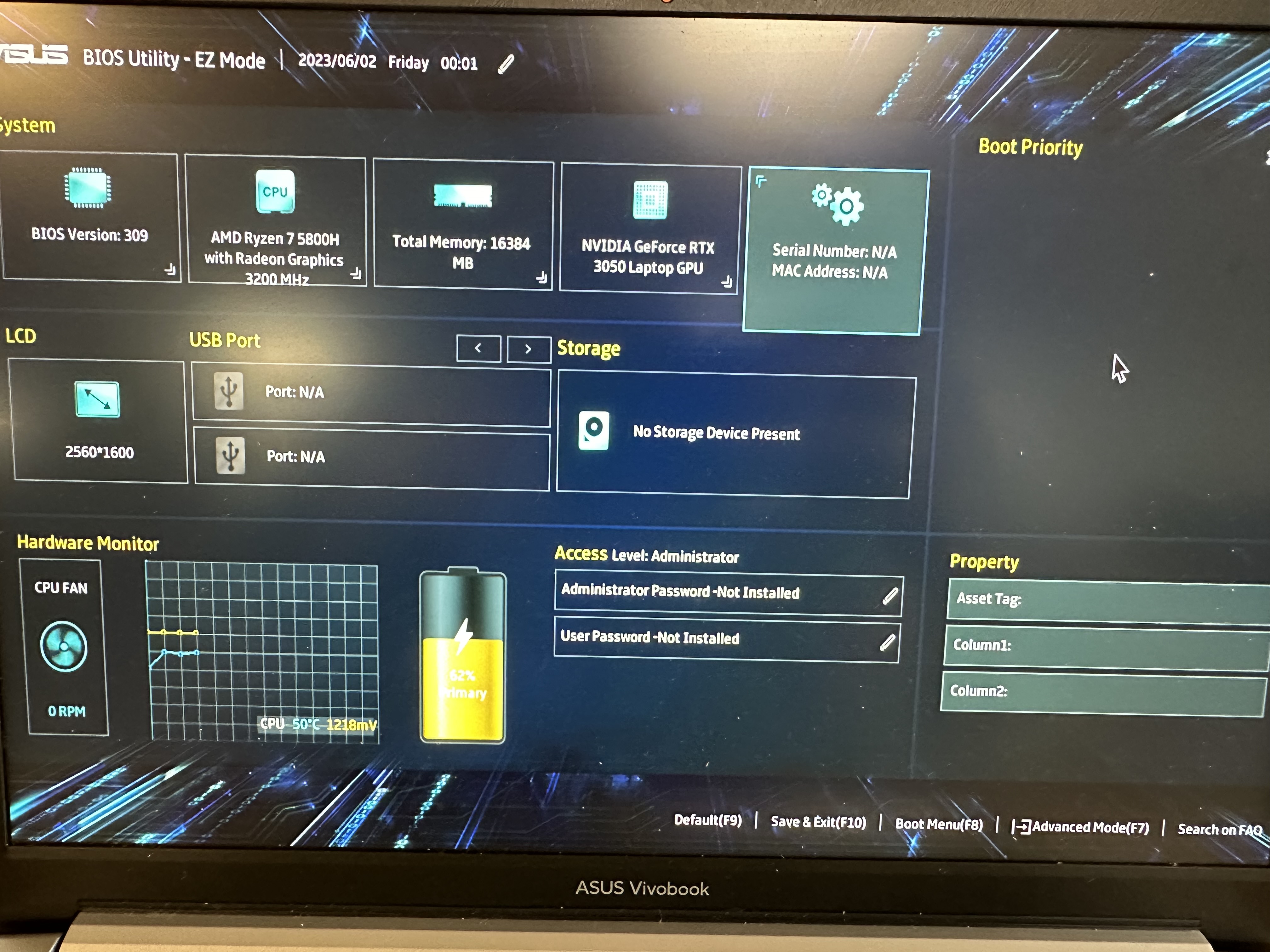

I'll start from the beginning. We have a laptop that no longer boots after a forced BIOS update via Windows Update. I then downloaded a BIOS bin file from the internet and flashed it to the device. This brought the display back, but crucial data such as the serial number and Nvidia GPU are missing. We hope that you can restore the original BIOS. The serial number of the laptop is: MBN0CX375539484.
AMD.zip
Thank you very much for the quick response. The laptop's is working again, and the Nvidia GPU is functioning. The serial number and MAC address are still missing. Is that a problem?
s/n and mac want add need buy patch 15$
