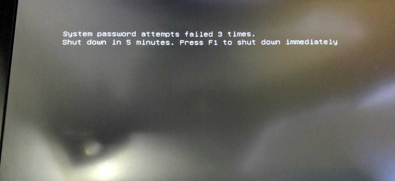

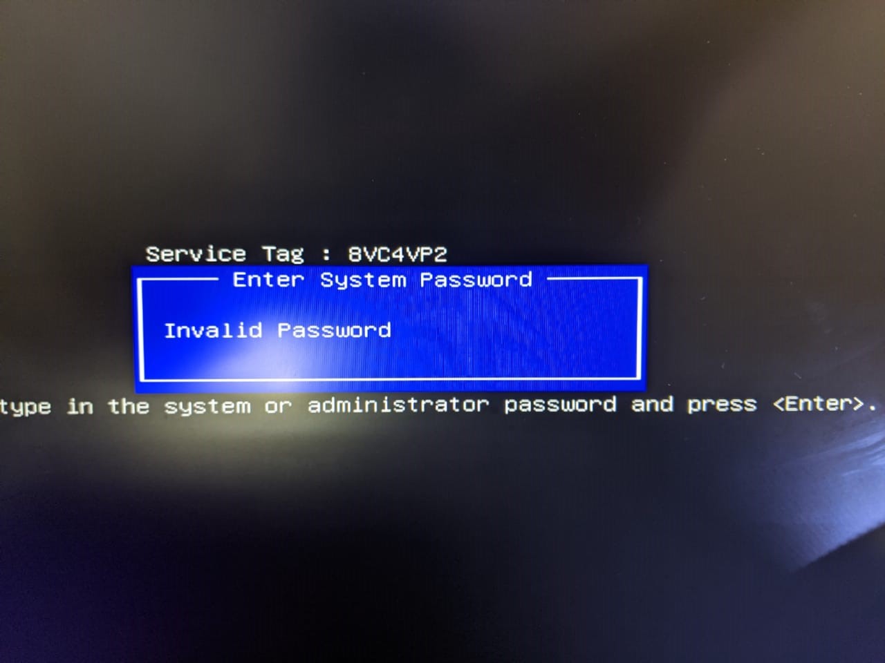

hi guys please please remove bios password i tried all files that been uploaded but no luck on startup showing only service tag (8VC4VP2) and asking for password
thanks in advance
password in KB9022
you need Programming KB9022 or buy password unlock
WHEN ONLY ENE FILE YOU SEND PROGRAMMING LAPTOP NOT TURN ON
MEANING NO POWER
OLD ENE FILE LAPTOP ALL WORKING ONLY SETUP IS LOCKED
