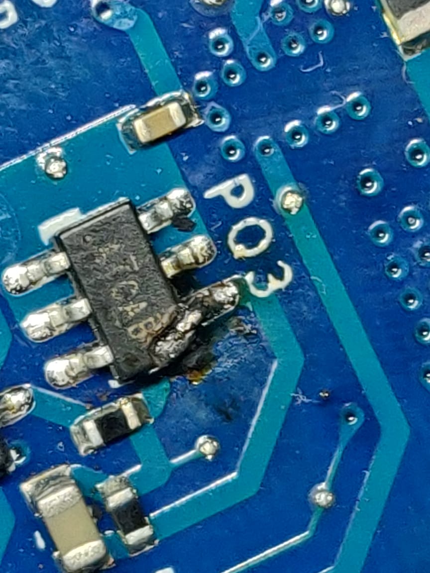

Any ideas where I could get a replacement chip?
PQ3 - on connecting battery, chip fried!
Super schematics, thank you!
Edit: found it! SI3457CDV-T1-GE3 from Vishay - thanks boys :)
Edit 2: found another chip which fried - B04N03 from PQ701
