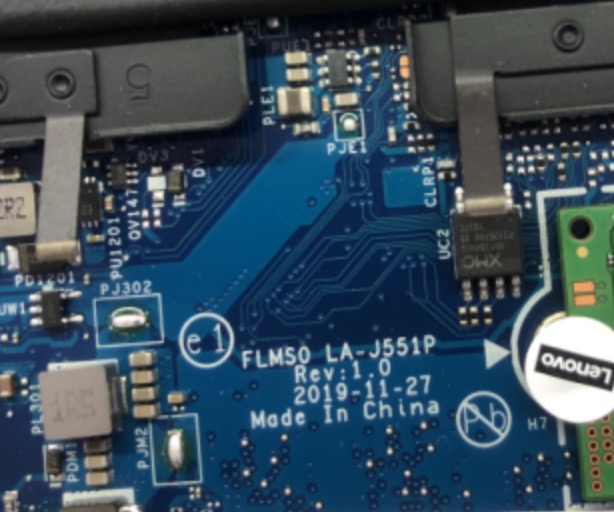

Unfortunately it seems to be a hardware issue then, maybe the CPU is dead, I have 20+ J551P motherboards with this problem; Everything on the motherboard has correct impedances, and yet it doesnt work. Thank you for your help anyway, kind regards

Hello, yes, unfortunately to this day we haven't found a solution however the most probable cause is CPU hardware fault. I have tried changing everything including the superIO (and its contents). The whole motherboard seems to be fine in terms of resistances and voltages. Everything is present. So it's either a fault on BIOS-SuperIO communication or the CPU itself which is unfortunately more likely. Like I said I have many such motherboards and they all seem to have this same issue. The only hope I had was that when a working board was swapped with a wrong BIOS it would also stay at 0,068A. So it might also be a Intel ME problem. However there's really no way for me to test that. If you ever get any luck with this please let me know :)

Спасибо. Если что-то получится, я вам напишу.
