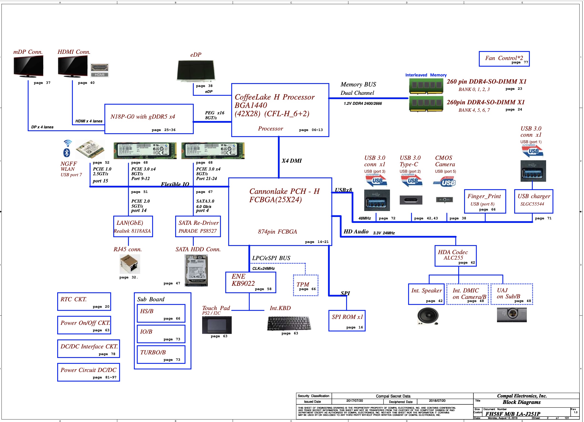

ACER FH58F-LA-J251F

I was wrong it was LA-J251P
Rev : 1.0 the the correct model not LA-J251F
all on top Available Please not ask againFH58F LA-J251P need dump bios pls
