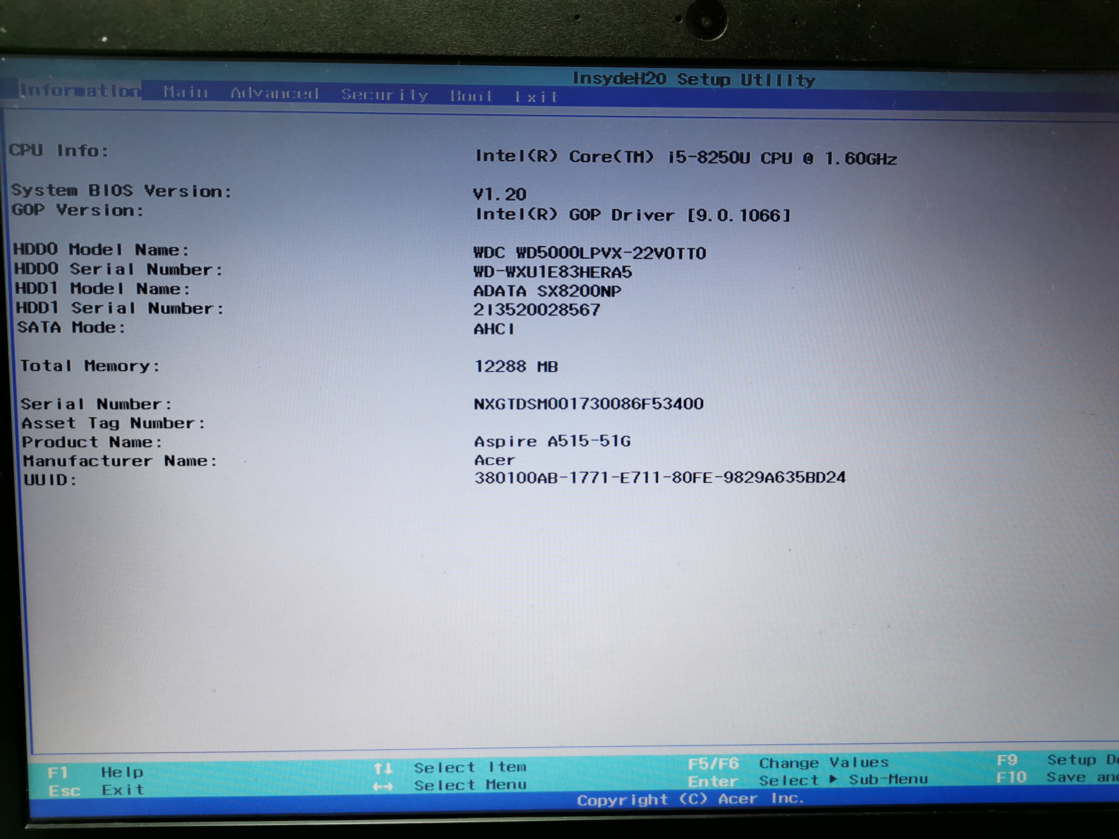

ACER A515G-51G-59Z0 CV501 LA-E829P. after bios update to version 1.21 Nvdia MX150 gone missing because of VBIOS overite with VBIOS MX130. I have upgrade tp v2.02 MX150 still not detected and downgrade to V1. 06 also MX150 not detected.
Maybe writing the original bios file will solve the problem.. I hope someone can help me.

Please reprogram the original bios to determine it is working before making any other changes.

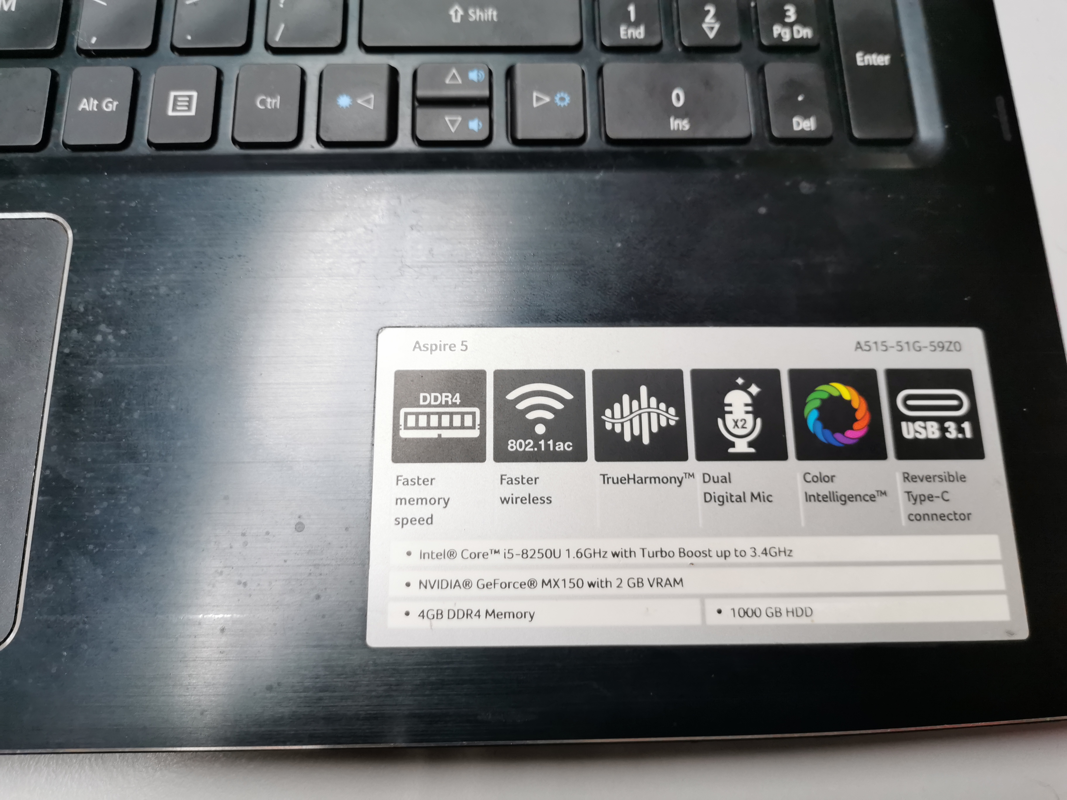

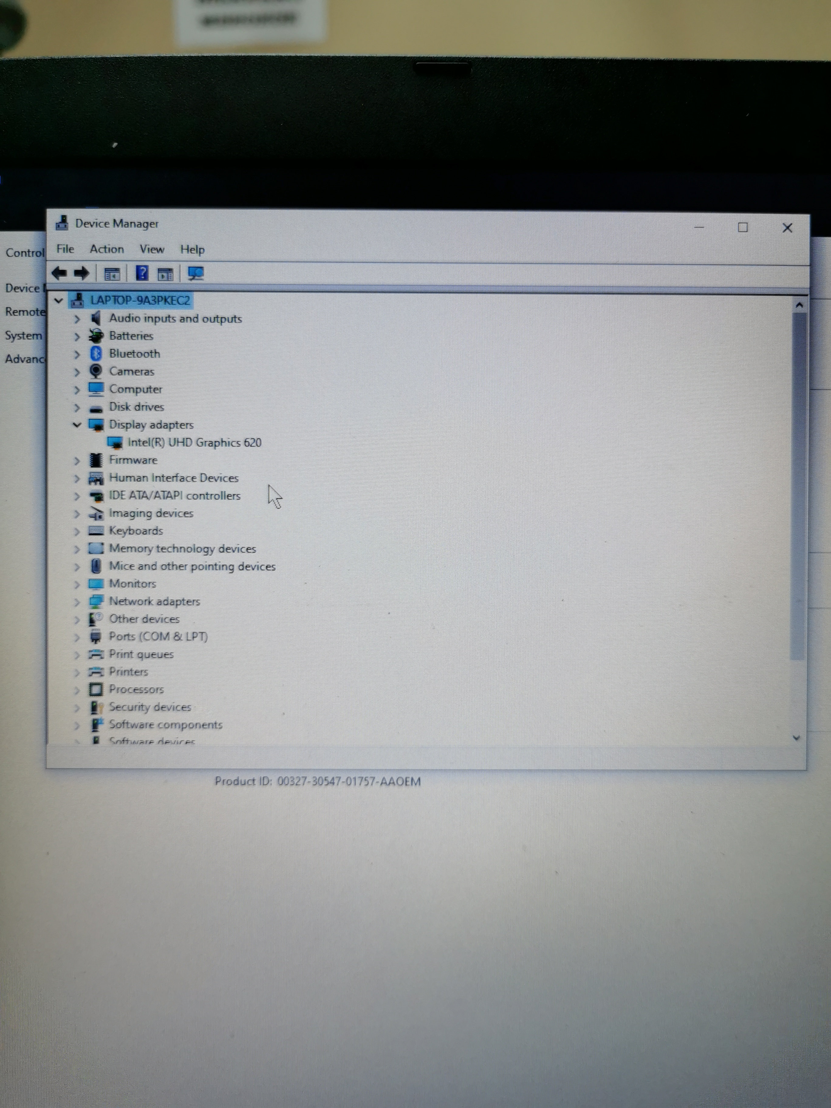

My problem is I lost my Nvidia MX150 after updating to V1. 21 bios.
Even after I update my bios to 2.02, MX 150 also not detected.
I have read acer forum and found that the BIOS V1. 21 has VBIOS of MX130 and flashing with it had override my MX150.
so my problem is, can u make bios file that can detect my MX150 graphic card

The laptop is boot but no MX150 detected
Thank you
Nothing wrong with my chip, It just not detected after bios upgrade to official acer bios V1. 21. Before that it just working fine..
