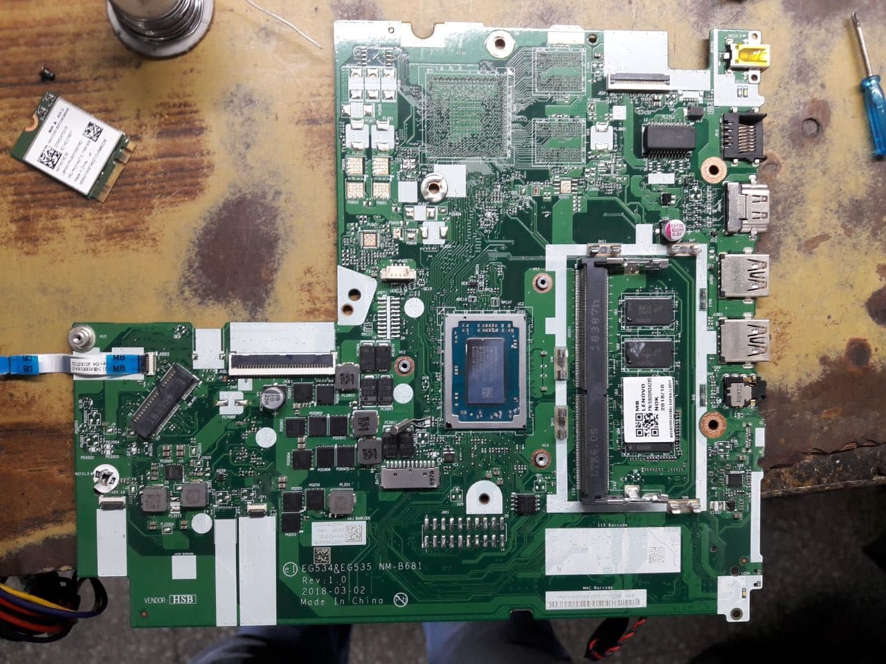

Lenovo 330-15ARR 330 Touch-15ARR Laptop (ideapad) EG534 & EG535 NM-B681
330-15ARR Laptop (ideapad)
330-15ARR, 330 Touch-15ARR
7VCN24WW
boardview Lenovo ideapad 330-15AR - NM-B681 Boardview.tvw
Lenovo Ideapad 330-15AR LCFC 330ARR NM-B681 Rev 1.0.pdf
Schematics
Lenovo 330-15 NM-B681 photo HD

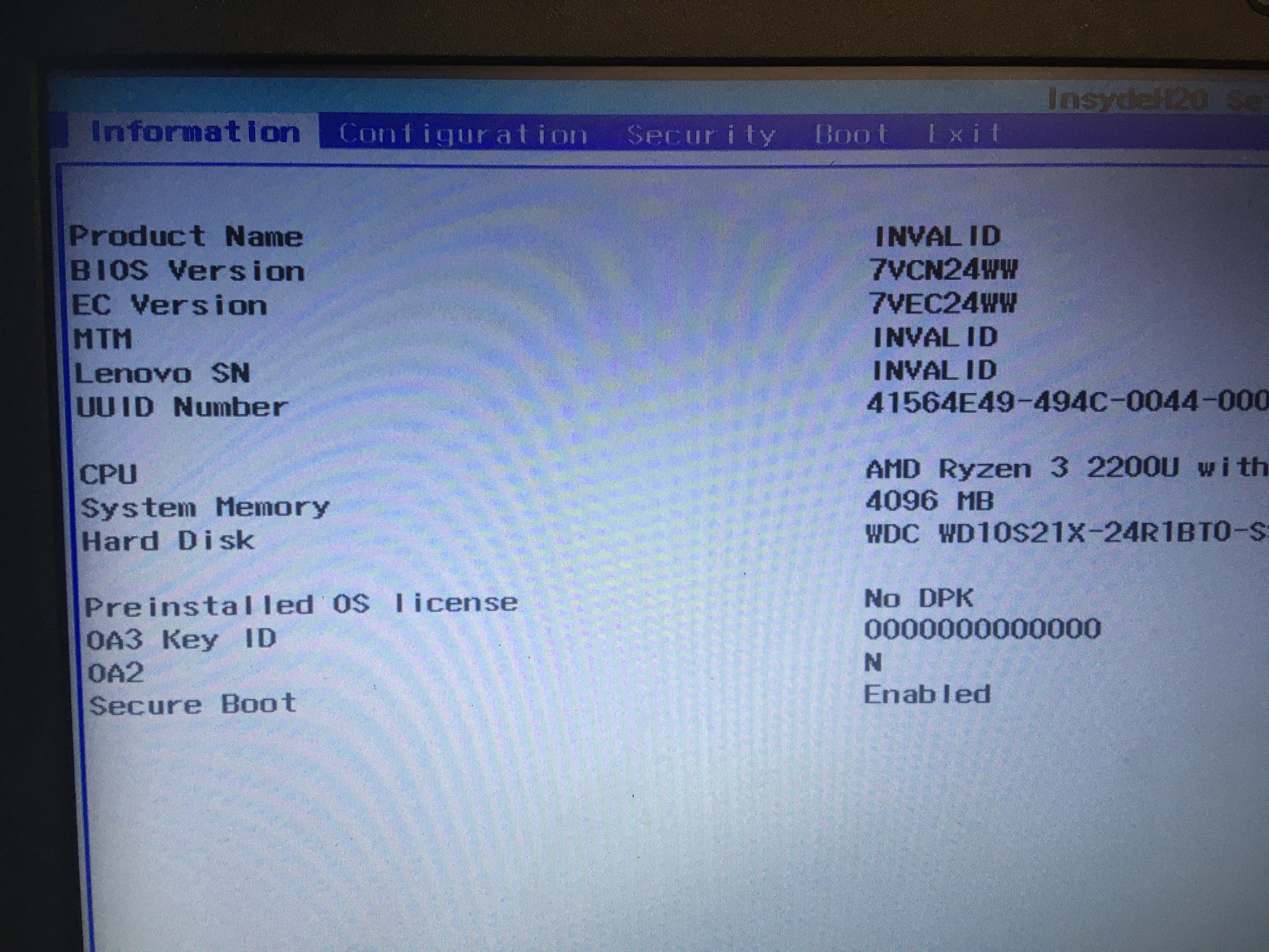

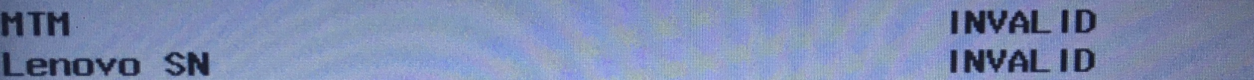

can not find
try this
That option I already tried, but doesn't work for this laptop, because EEPROM is write-protected.
Do you have other option?
protected is problem chip BIOS and software tool Programming
not related to BIOS file
I know. I didn't say it is related to BIOS file. I just said that your idea of trying it to fix with 'Maitenance Diskette' doesn't work. And I asked if you have an other option for getting the DMI written?
no have option, you need test BIOS other have full info
yes, but i need know IO is Original or have Programming ?
why do you need to know that? if you have file with DMI than you can send to me, because you told me you can't find DMI, so I have to look for myself. The file you profided does not have DMI, so please could you send me file with DMI?

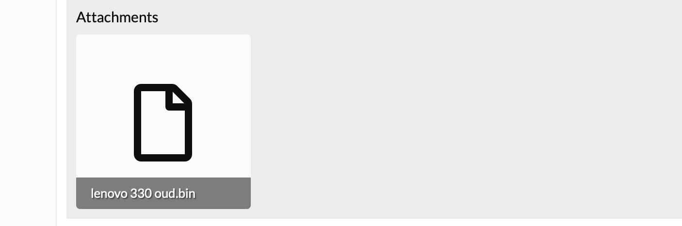

I send you my old file
lenovo 330 oud.bin
