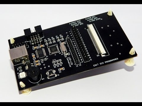

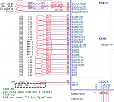

Hi , I want write io nm-b661 but do not have schematic for find pin config keyboard
do you have picture like this
no no i have 2 programmer tnm5000 and rt809h I explain two posts ago. for programing ec need identification io pins for config from programmer like kso pin and ksi but i can not find datasheet for io or schematic motherboard for find pins.
model current Unavailable schematic, You can only get there to connect if you want to program it.
I know it is very difficult but there is no other way
IT8996 IT8986.pdf
