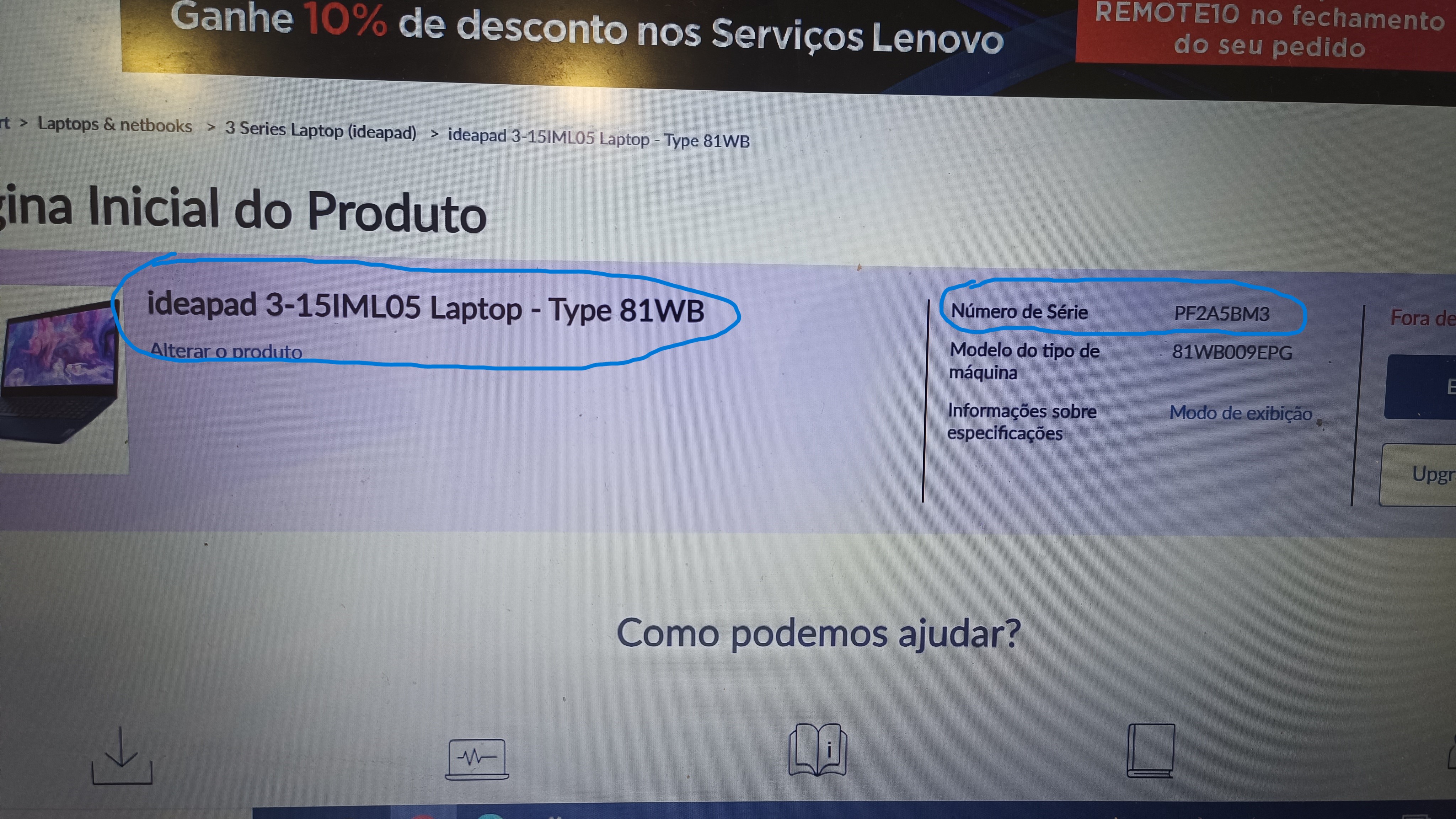

Hello @ThienBui
Good morning!
This LENOVO with PCB: GS452GS552GS752 NM-C781 Rev 1.0
I tried the Vinafix bios and the PC turns on but there is no image.
With customer source bios, the PC turns on with image, boots to the system, and completes the 4gb onboard ram memtest without errors.
The problem is when I install an offboard RAM for upgrade. I've tried many RAMs and whenever an onboard RAM is connected, the PC turns on without an image.
Can you change my BIOS source and solve this problem?

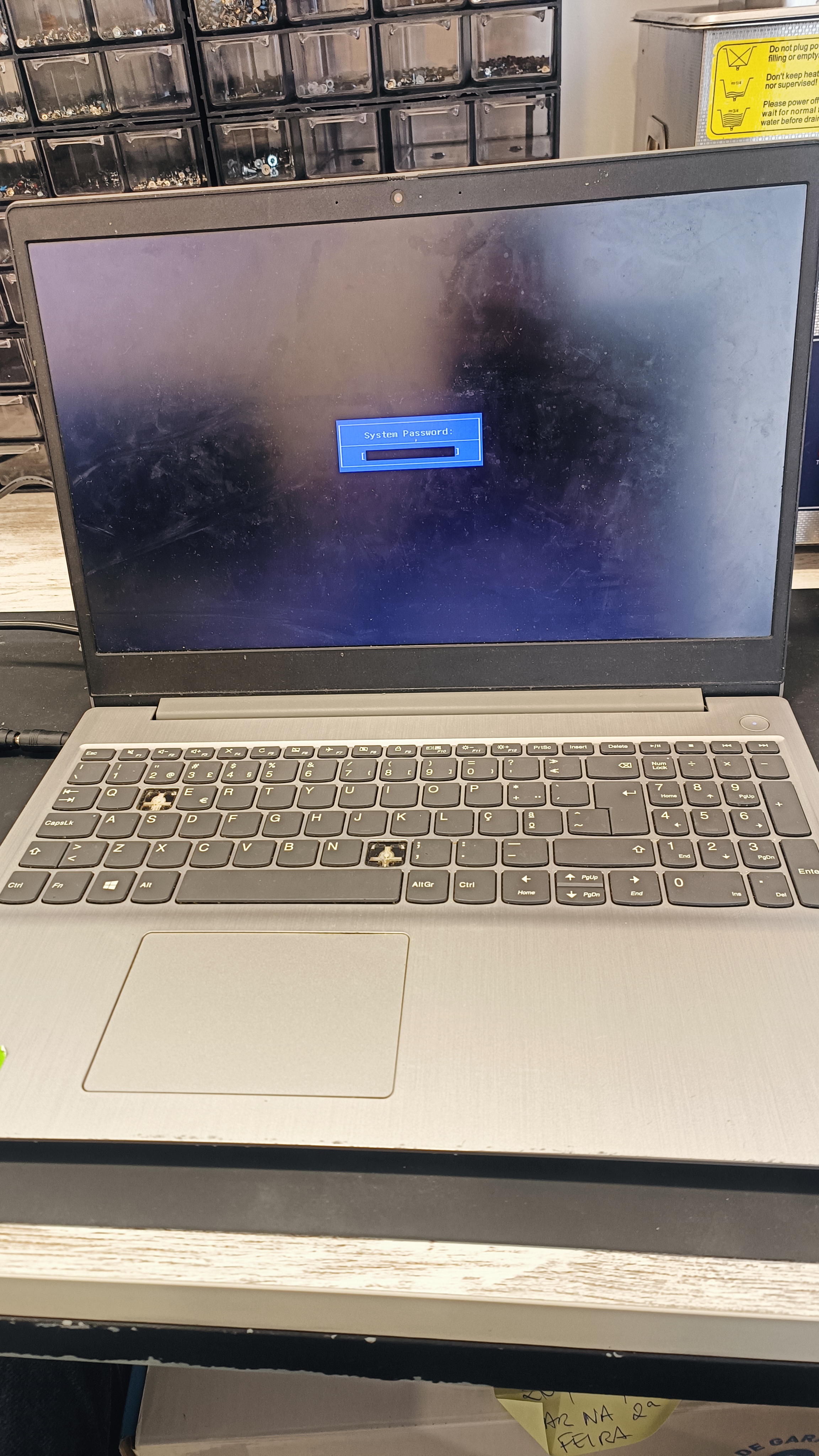

Good morning, @ThienBui
With this BIOS that you changed, my PC no longer has an image.
With the original BIOS, the PC has an image.
Can you please recheck the source bios and remove the password and fix the RAM upgrade issue?

return and send one photo dipslay lock

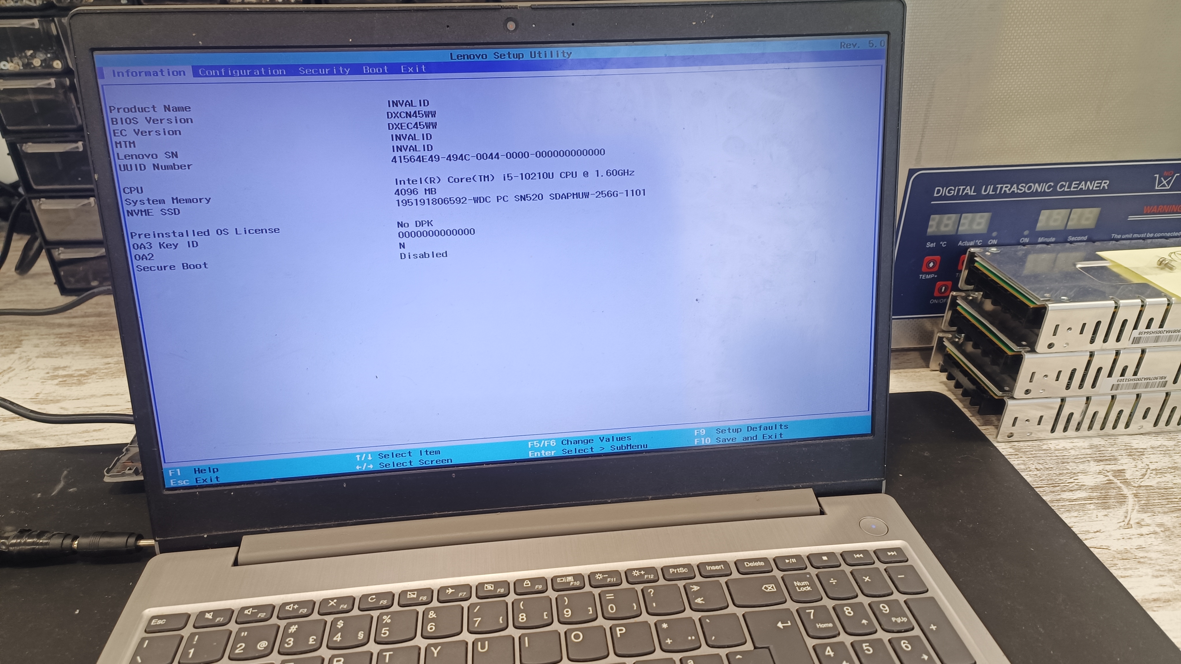

Good afternoon, @ThienBui
With this BIOS the PC turns on with the image (attached) and starts up ok for the system (with 4GB onboard RAM).
The only problem now is that there is no image if you have an offboard RAM installed (RAM in the upgrade slot).
All the RAM that I install in the slot causes the PC to turn on without an image.
If you try with only the onboard RAM, the PC works normally.
Please, help!
Best regards

don't know, it's not related to unlocking
Yes, I know it's not related to unlocking... That's what you're saying.
I needed 2 things:
1_ remove password
2_ solve no image problem when installing offboard RAM.
At this moment the BIOS is ok, without a password, there is only the problem with the RAM slot/upgrade.
Can you help?
Thanks.

RAM problems can be caused by incompatible or unsupported chipsets
