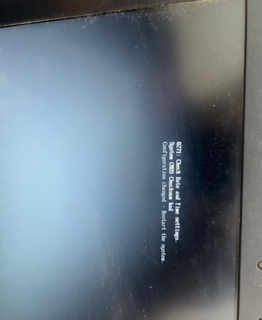

LA VISTAEGRESAR A SU BIOS ORIGINAL Y LEVANTA NORMALMENTE PERO NO ME PERMITE INICIAR WINDOWS, ME SALE UN MENSAJE DE HORA Y FECHA Y SE REINICIA, NO ME PERMITE INGRESAR AL BIOS. YA CAMBIE PILA DE BIOS PERO NADA. NO FUNCIONA.... ADJUNTO MENSAJE EN PANTALLA
instal date in bios setup
old bios display coming,but resart,,you rebuild bios send me,that bios is not coming display..kindly check again pls..... this bios 1.8 v
1.8v or 3.3v you just need to pay attention when programming it, it is not related to the bios file
